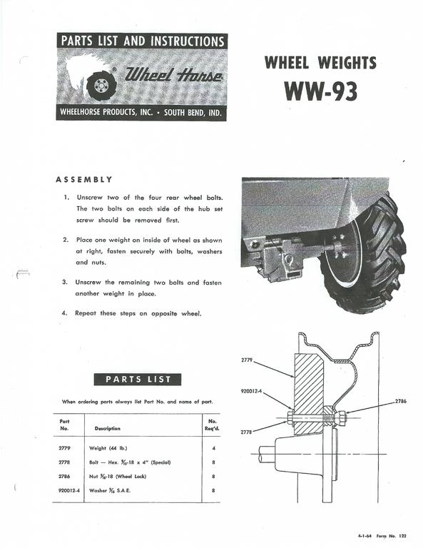

TravelinJavelin 621 #1 Posted November 28, 2018 ok all i need to know is about the type of bolt/lug nut set up i know the manual says 9/16 x 4" long now what type of thread are they and are there lug nuts off automotive that will fit like a ford or chevy dodge? Share this post Link to post Share on other sites
wallfish 19,379 #2 Posted November 28, 2018 (edited) I don't know wheel weights by model number but every one I know of mounts to the rim using carriage bolts. Thread size is 3/8 which uses a 9/16 hex nut. Edited November 28, 2018 by wallfish 2 1 Share this post Link to post Share on other sites
gwest_ca-(File Mod) 12,015 #3 Posted November 28, 2018 9/16-18 is a standard fine thread. Looks like the weight is bolted to the hub through the existing threaded holes in the hub and a tapered nut is used on the same bolt to mount the wheel. Listed as Special bolt so suspect the thread is longer than found on a standard bolt. The 9/16 fine thread tapered wheel nuts are a common nut used on light trucks. Garry 1 Share this post Link to post Share on other sites

Racinbob 12,812 #6 Posted November 28, 2018 (edited) My copy/paste thingy isn't working so maybe Garry can link to the manual for these weights. It looks to me that the weights are bolted directly to the back of the hub and then the wheels are held on with lugnuts. The original lug bolts aren't used. Entirely different than the weights most of us are accustomed to. Pretty cool! These are for the 15" 4 hole rims on the 953/1054. Edited November 28, 2018 by Racinbob 1 Share this post Link to post Share on other sites
Lane Ranger 11,815 #7 Posted November 28, 2018 (edited) Model number WW-93 fits inside 15" wheels models 953, 1054 and 1054A 1963-1965 - 44 lbs. each Operator manual #122 IPL 1 page 210.94KB Dated 4/1/64 Mounts inside the wheel - 2 pieces per wheel bolted to the rear of the hub Model number WW-105 fits outside 15" wheels models 953, 1054 and 1054A 1963-1965 Model number 8-1131 15" wheel weights for the 1969-1973 GT-14 (Approximate shipping weight 100 lbs.) Edited November 28, 2018 by Lane Ranger 1 2 Share this post Link to post Share on other sites
gwest_ca-(File Mod) 12,015 #8 Posted November 28, 2018 Garry 1 1 Share this post Link to post Share on other sites
953 nut 64,302 #9 Posted November 28, 2018 WW-93 wheel weights good buy! I picked up some used Dodge 3/4 ton pick up lug nuts at the local auto salvage when I put mine on, half a buck each. 1 Share this post Link to post Share on other sites
