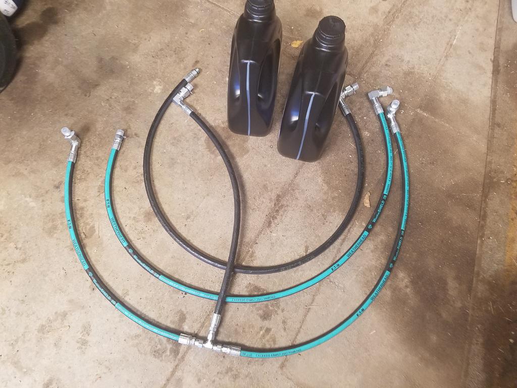

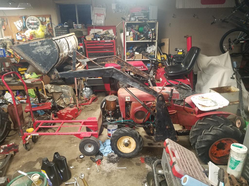

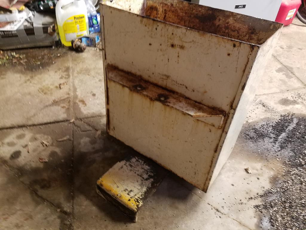

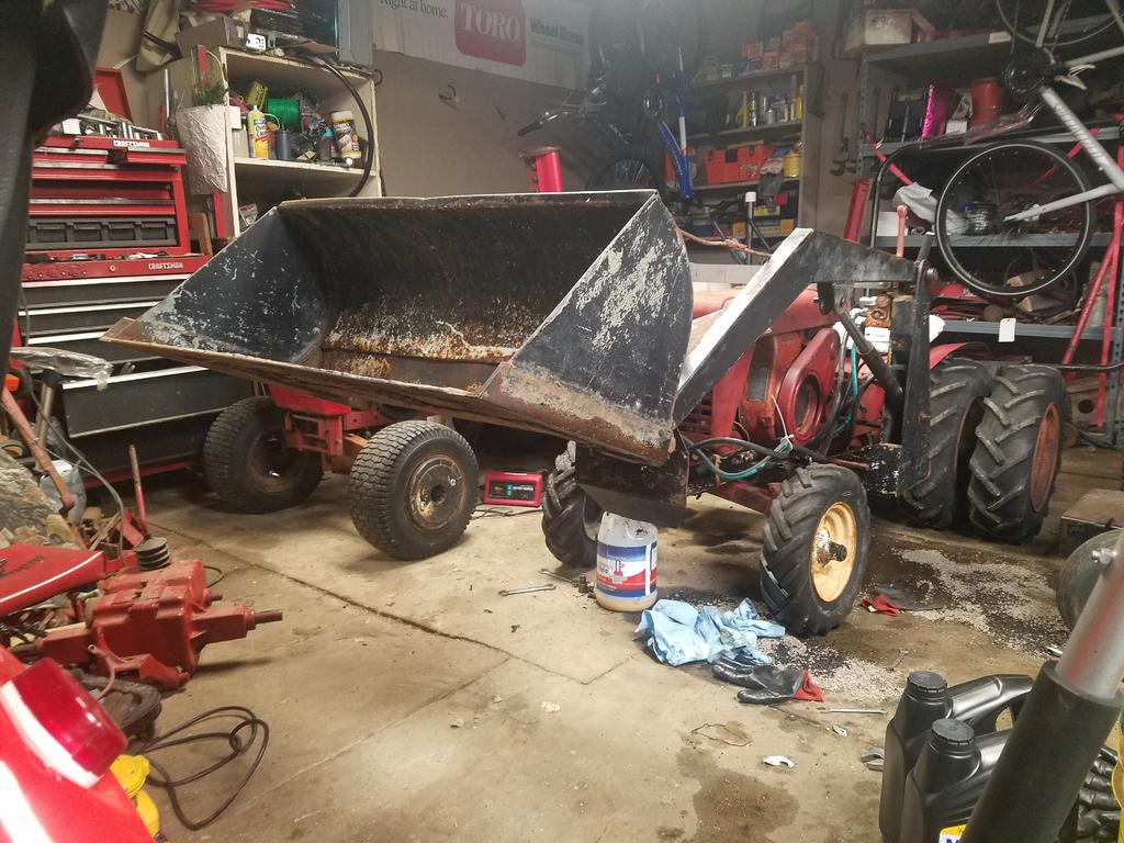

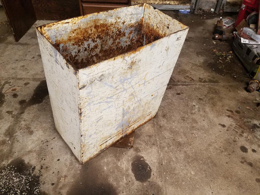

hcminis 1,796 #33 Posted December 30, 2018 Worked on the 854 w/ Danco loader more today. New cross member made. Took all hydraulic hoses off and went to NAPA to have new ones made. They didn't have all the fittings and said they would be ready Wednesday. Found a backup pump / reservoir on ebay for a great price. Cleaned the reservoir that is currently on loader. Fixed a few other little details. Slowly making headway. Need a better gas cap along with throttle and choke cables 4 Share this post Link to post Share on other sites
AMC RULES 37,259 #34 Posted December 30, 2018 Love that little guy... keep up the great work there. Share this post Link to post Share on other sites

hcminis 1,796 #38 Posted December 31, 2018 More goodies have arrived for the ole nag. Can't wait til NAPA gets done with my hoses. 5 Share this post Link to post Share on other sites

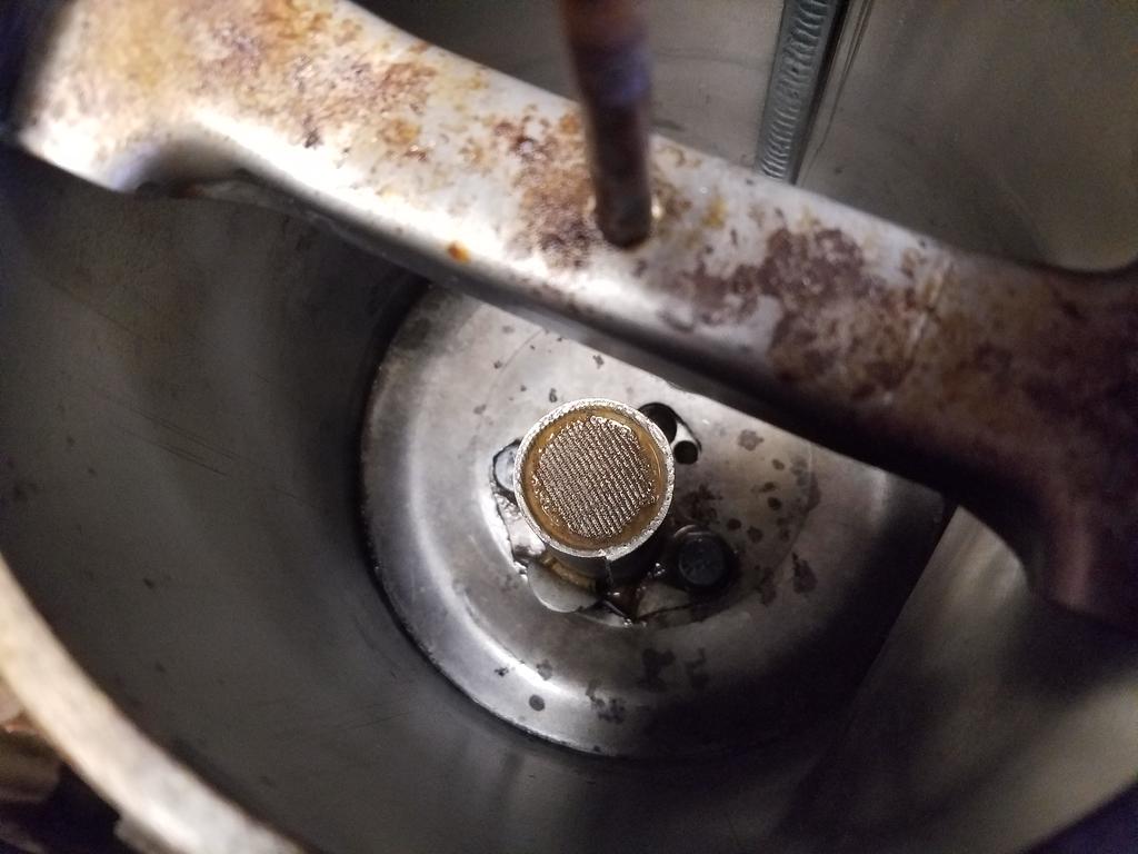

hcminis 1,796 #39 Posted January 3, 2019 Well the nice guy at NAPA gave me a big discount on hoses....only $234.00 instead of $325.00. Sure doesn't look like that much but oh well. I now have liftage..... Will need to flush fluid again as it got milky from leftover fluid in valve and pump. Goes up slow. SUPER EXCITED!!!!! 5 Share this post Link to post Share on other sites
wallfish 20,547 #40 Posted January 4, 2019 46 minutes ago, hcminis said: Well the nice guy at NAPA gave me a big discount on hoses....only $234.00 instead of $325.00. Sure doesn't look like that much but oh well. I now have liftage..... Will need to flush fluid again as it got milky from leftover fluid in valve and pump. Goes up slow. SUPER EXCITED!!!!! OUCH! Are they made of gold? It's always nice when the hydraulics move! 1 Share this post Link to post Share on other sites
WHGuy413 2,859 #41 Posted January 4, 2019 That's awesome. I don't see many around here with loaders. Let alone a round hood with a loader. Share this post Link to post Share on other sites
dells68 7,499 #42 Posted January 4, 2019 1 hour ago, wallfish said: OUCH! Are they made of gold? It's always nice when the hydraulics move! Don’t know about that John. I had one hose made for a Bronco 14 a few years ago and it cost over $60 and just took a few minutes to make! Hydraulic lines are crazy expensive around here! 1 Share this post Link to post Share on other sites
wallfish 20,547 #43 Posted January 4, 2019 https://www.surpluscenter.com/Hydraulics/Hydraulic-Hose-and-Hose-Assemblies/Hydraulic-Hose-Assemblies/ If they're NPT or JIC fittings. But... they're straight so need to buy the extra fittings for using 90s and such 10 minutes ago, dells68 said: Don’t know about that John. I had one hose made for a Bronco 14 a few years ago and it cost over $60 and just took a few minutes to make! Hydraulic lines are crazy expensive around here! 2 1 1 Share this post Link to post Share on other sites

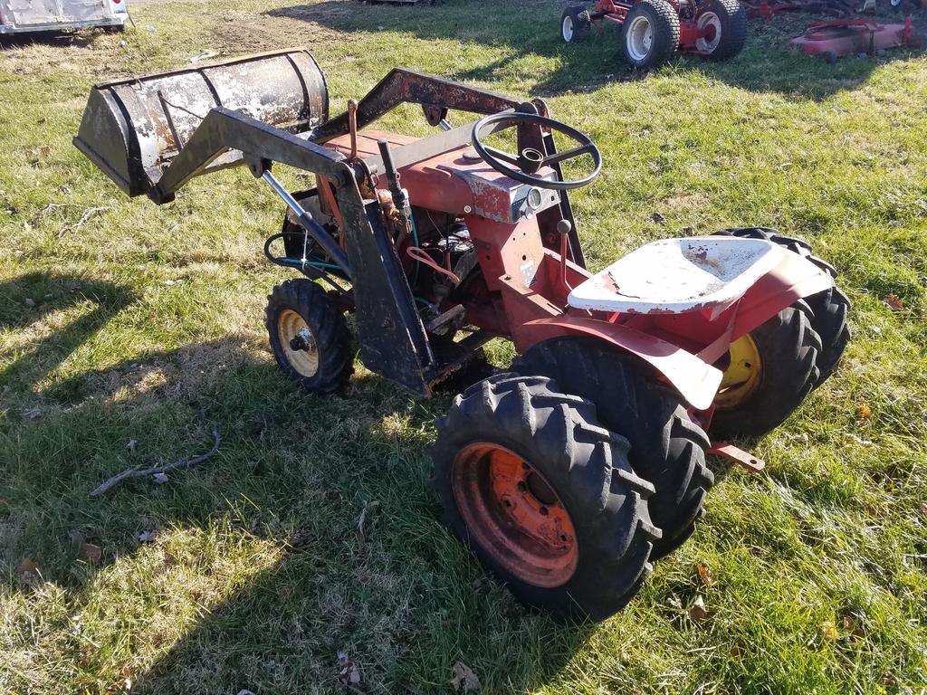

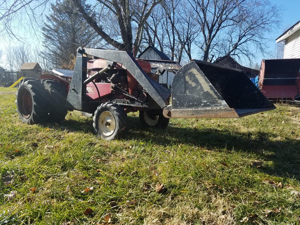

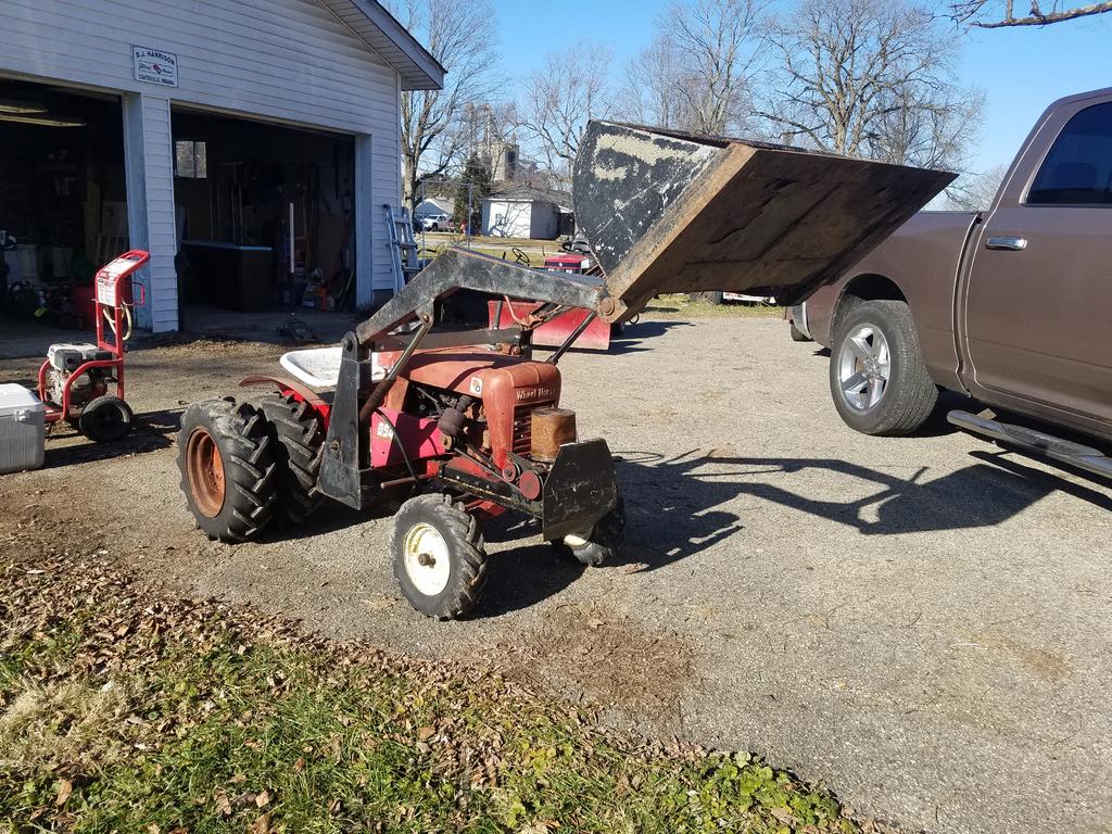

hcminis 1,796 #44 Posted January 7, 2019 Was finally able to get the ole girl out for some sunshine. Had a very late night / early morning Saturday night / Sunday morning. Was able to get the loader to work as it should. The pulley seal wasn't even in and just spinning on shaft. Bought a new seal and installed it. Waiting on choke and throttle cables now. 2 9 Share this post Link to post Share on other sites

Pullstart 71,146 #46 Posted January 7, 2019 That’s pretty quick! I see it’s a trip bucket, didn’t realize this before. So cool! Share this post Link to post Share on other sites

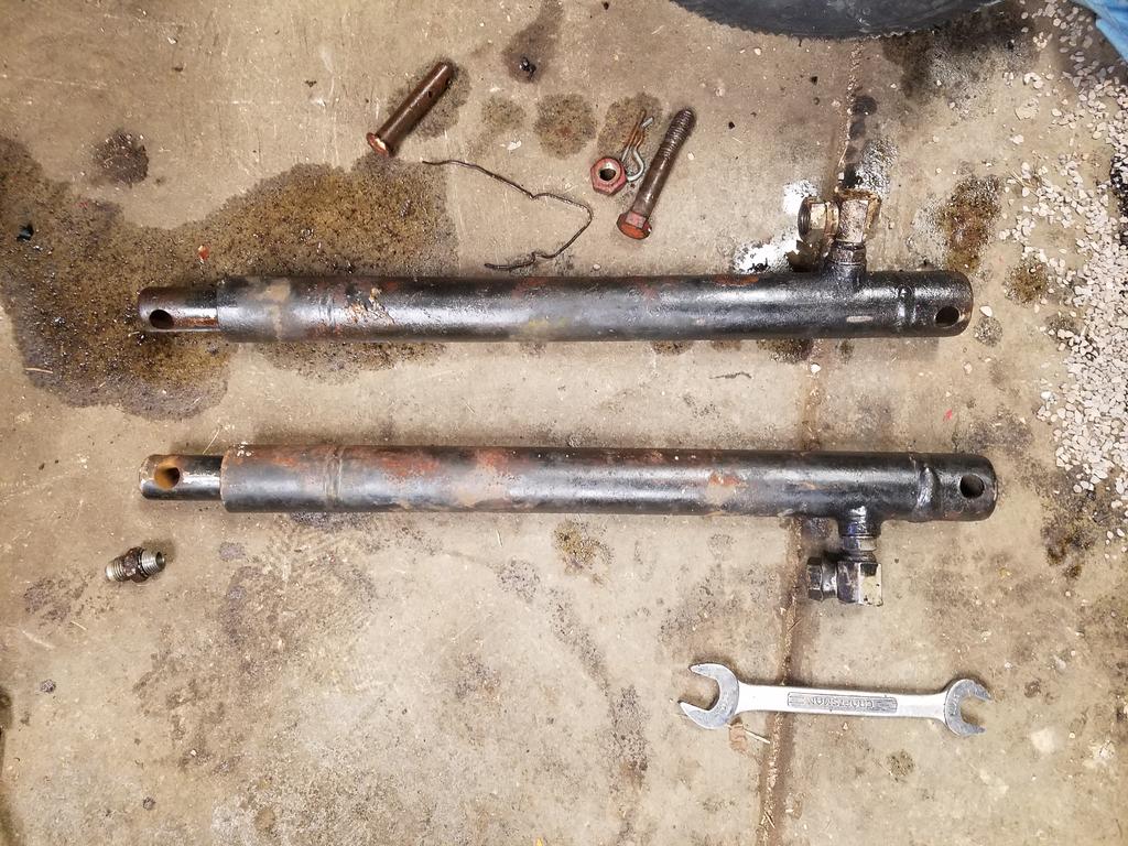

hcminis 1,796 #50 Posted January 10, 2019 Not what I wanted to have happen. Guess I'll need one of these. Share this post Link to post Share on other sites
