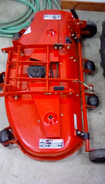

Holly 36 #1 Posted November 28, 2018 I just purchased a 312-8 wheelhorse. 1989 model. When I push clutch pedal in to engage a gear, the pedal does not want to come out on its own. I can pull it out easily with my foot and tractor goes. I am new to this tractor and could use some directions. Would it just need a new belt? The tractor is a 1 owner and in excellent condition. Only 580 hours. I went over the deck today and it's like new condition Share this post Link to post Share on other sites

peter lena 9,326 #7 Posted November 28, 2018 holly , good going on that tractor, that deck looks like pristine, I hope you maintain that , just the idea that you have such a find is a great opportunity to maintain it . pete 1 Share this post Link to post Share on other sites
