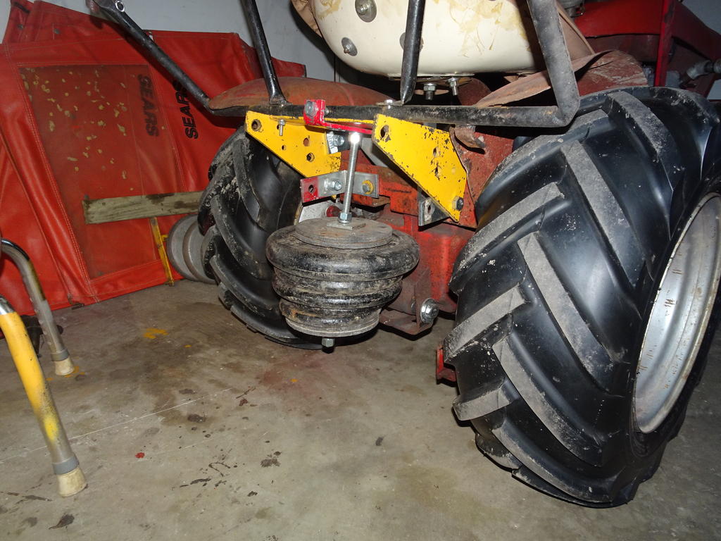

giddyap 1,574 #1 Posted November 26, 2018 I would never put 60 pounds on my hitch in fear of cracking the tranny case. So I attached the yellow support on the toolbox under the seat and the weight hangs from it. The 1/2" threaded rod connects the hitch to the hanger so not only can I secure the load but I can also adjust the hitch. Adjusted just right, my hitch does not touch the bottom of the case and barely kisses the back. 60 pounds becomes weightless (on the hitch) 6 Share this post Link to post Share on other sites
lynnmor 8,631 #2 Posted November 26, 2018 I cracked a case and learned the hard way. I wouldn't be afraid to add a little weight back there, but no way would I add a lot, especially high up where the leverage would make things even worse. 1 Share this post Link to post Share on other sites
