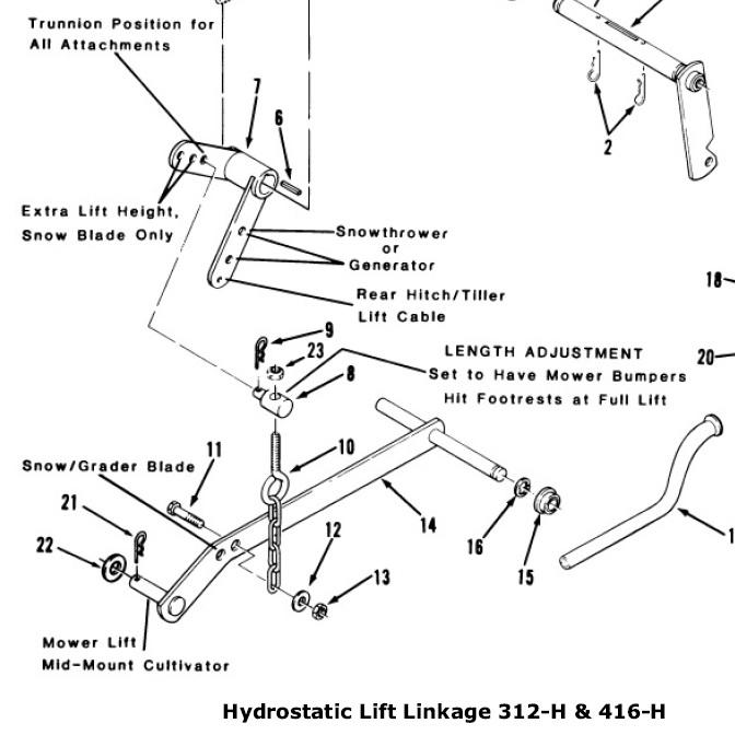

Navig8r 132 #1 Posted November 25, 2018 Hi... My tiller/rear lift cable (on 416-H) is in the lifting arm in the bottom hole... Do I need to remove it to mount the snowblower lift flag? Move it? Can they share? Share this post Link to post Share on other sites
gwest_ca-(File Mod) 11,918 #2 Posted November 27, 2018 They do use different holes but suspect the cable pin would have to be removed and the cable pulled to the side to attach the flag. There is an offset in the flag at the attachment pin so it may clear the cable pin below it. Having the head of the cable pin on the right side might work. Sounds like nobody knows. Post your results and we will all know. Garry 1 Share this post Link to post Share on other sites
WVHillbilly520H 10,377 #3 Posted November 27, 2018 On 11/25/2018 at 10:53 AM, Navig8r said: Hi... My tiller/rear lift cable (on 416-H) is in the lifting arm in the bottom hole... Do I need to remove it to mount the snowblower lift flag? Move it? Can they share? I ran the rear clevis cable all year round for nearly 20 years whether mowing, snow plow/blading or snow thrower, it does rub a bit on the thrower flag but not enough for me to unhook it, you should be fine, Jeff. 1 Share this post Link to post Share on other sites
Navig8r 132 #4 Posted November 28, 2018 Thanks for the help guys..... That diagram is s great reference, thanks for that Garry! 1 Share this post Link to post Share on other sites
