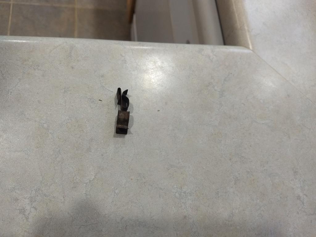

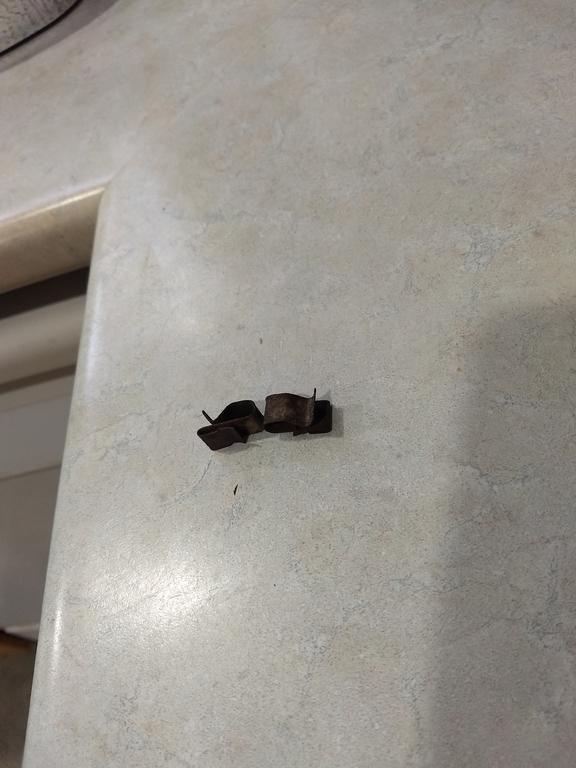

ebinmaine 76,943 #1 Posted November 25, 2018 I don't know what these are called or where I could find them. Could someone lead me in the right direction? Share this post Link to post Share on other sites
peter lena 9,675 #2 Posted November 25, 2018 what were they originally for ? pete Share this post Link to post Share on other sites
ebinmaine 76,943 #3 Posted November 25, 2018 1 minute ago, peter lena said: what were they originally for ? pete They clamp to the sheet metal and hold wires for things such as lights Share this post Link to post Share on other sites
rmaynard 16,826 #4 Posted November 25, 2018 (edited) Amazon.com Search: Red Hound Auto Trailer Wiring Clips - Package of 25 Edited November 25, 2018 by rmaynard 4 2 Share this post Link to post Share on other sites

ebinmaine 76,943 #7 Posted November 25, 2018 19 minutes ago, rmaynard said: Amazon.com Search: Red Hound Auto Trailer Wiring Clips - Package of 25 Thanks Bob !! 21 minutes ago, c-series don said: Oh yah, I need some of them too. I think they are called clippy thingees 😂 Hehehe I used the name and searched Amazon and fleabay and found these... Ordered 2 for under $11 each with free shipping. https://www.ebay.com/i/153065318121?rt=nc&_trkparms=aid%3D222007%26algo%3DSIM.MBE%26ao%3D1%26asc%3D20161006002618%26meid%3D571f557583ba468981cc543845792772%26pid%3D100694%26rk%3D2%26rkt%3D11%26sd%3D332686081242%26itm%3D153065318121 Share this post Link to post Share on other sites
Sarge 3,470 #8 Posted November 25, 2018 These are 304 stainless - good sized wiring hole for harnesses and already designed for 1/8" metal to clip onto - .300" harness size, plenty for restorations in which you're adding a separate ground wire versus using chassis grounds. https://www.amazon.com/Heyco-S6445-Sunrunner-Cable-Package/dp/B00DOGJHU6/ref=pd_sbs_263_21?_encoding=UTF8&pd_rd_i=B00DOGJHU6&pd_rd_r=523a4344-f0ca-11e8-b188-2fb63616cf11&pd_rd_w=uhBjS&pd_rd_wg=HB4om&pf_rd_i=desktop-dp-sims&pf_rd_m=ATVPDKIKX0DER&pf_rd_p=7d5d9c3c-5e01-44ac-97fd-261afd40b865&pf_rd_r=5ZBBGKXVA3NBY8QFFY26&pf_rd_s=desktop-dp-sims&pf_rd_t=40701&psc=1&refRID=5ZBBGKXVA3NBY8QFFY26 Sarge Share this post Link to post Share on other sites
