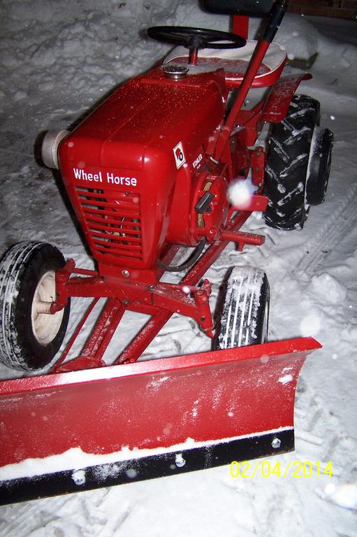

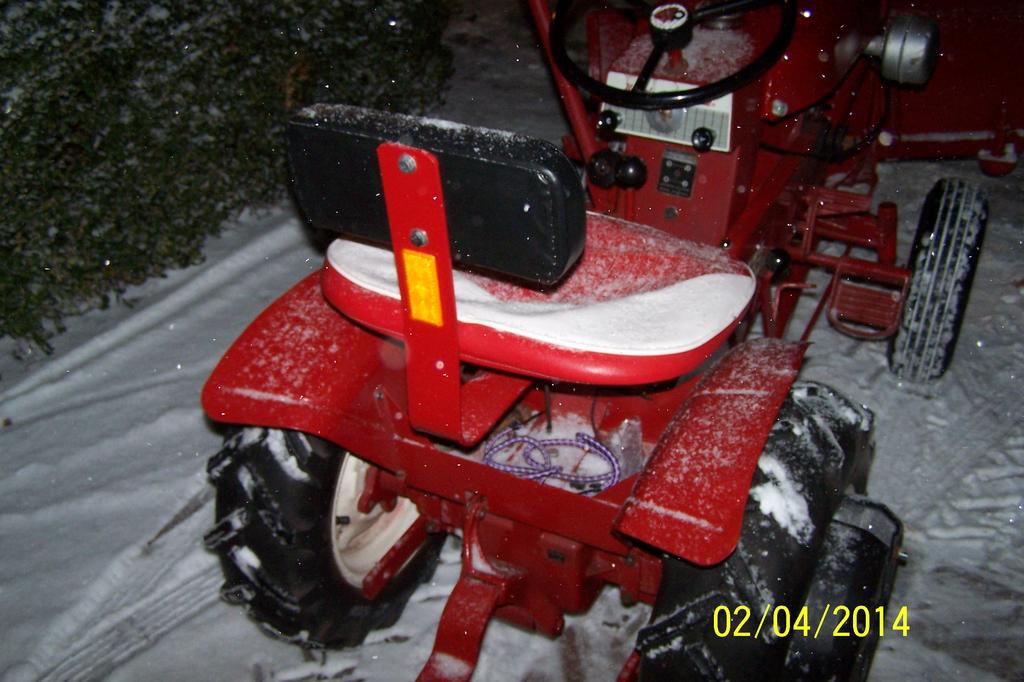

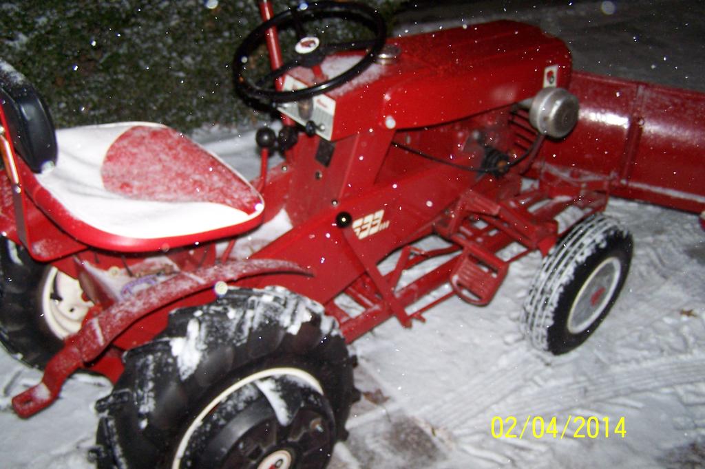

Lane Ranger 11,805 #7 Posted November 19, 2018 Here are some pictures of David Ralph's 1963 Wheel Horse 633 Kohler Motor (K 141) and the air cleaner with the hood off. 1 Share this post Link to post Share on other sites

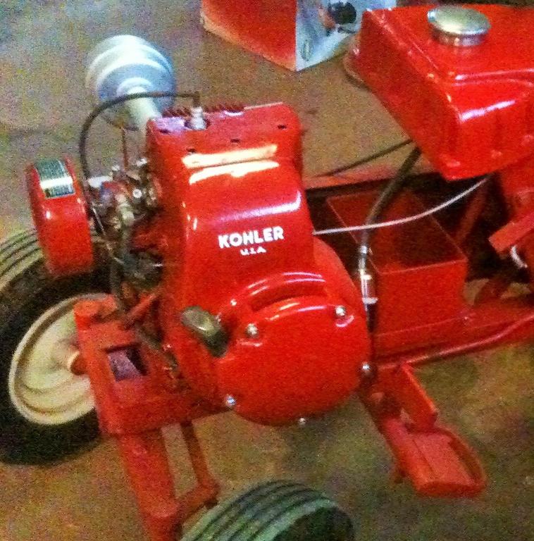

Vinylguy 4,747 #9 Posted November 19, 2018 18 hours ago, rustytractornut said: Hello i am working on a 633 restoration.When i look for a decal set i notice that the decal set for a 633 has four 2'' square hood decals.Where do the extra decals go ???. And is a 633 hood smaller in length than say a 753. The air cleaner on k 161 hits the hood and won't close. The correct motor for a 633 is a k 141 6-1/4 hp with the vertical mount carb. I am putting a k161 on this tractor but don't know why the hood won't fit. Help red square friends. Thank you. I include 2 left and 2 right facing decals. many of the tractors have the logo facing forward on both sides of the hood yet I have also seen a few that have the logo facing left on each side so I include enough decals for my customers to apply them the way they prefer. Give me a call with any concerns about this kit. 3 Share this post Link to post Share on other sites
