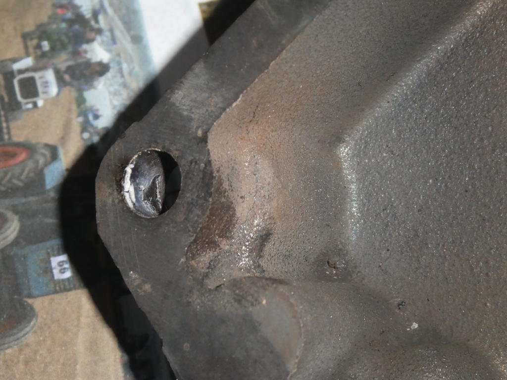

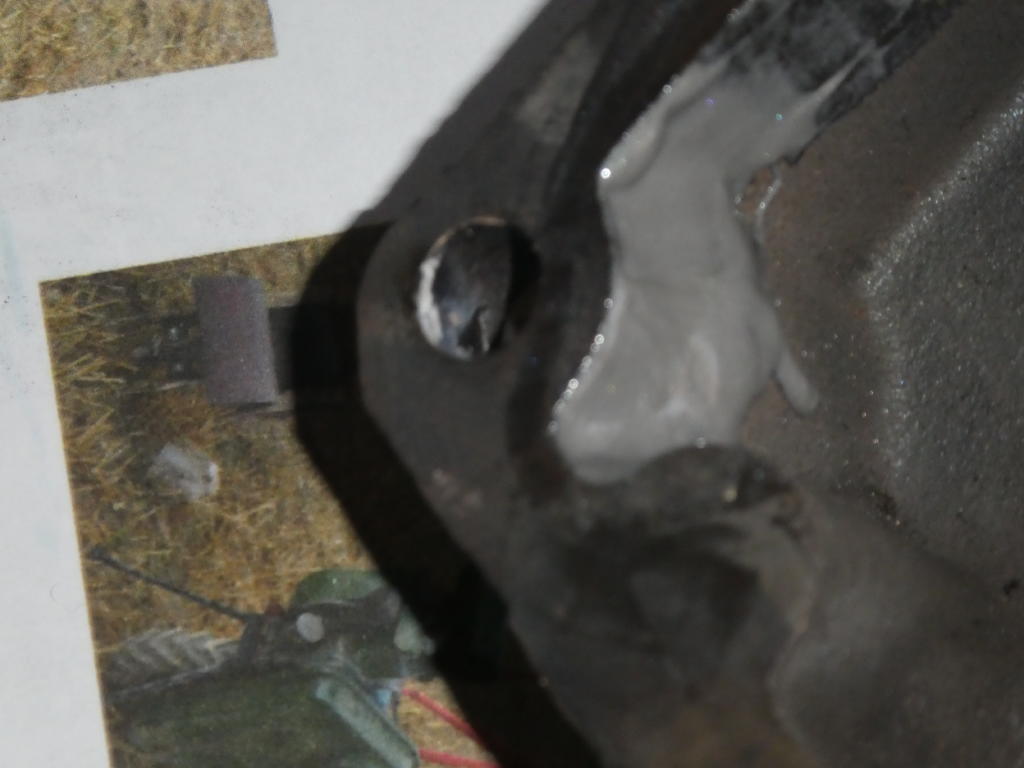

The Tuul Crib 7,354 #76 Posted December 25, 2018 6 hours ago, Stormin said: Forgot to re-new my subs. In the first photo you can just see the crack. Second photo' what I've used to seal it. And applied. Just checked this morning and no sign of a leak so far. Very nice work storm! After you get done would you come help me with my 1067? Share this post Link to post Share on other sites

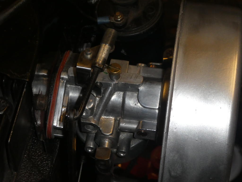

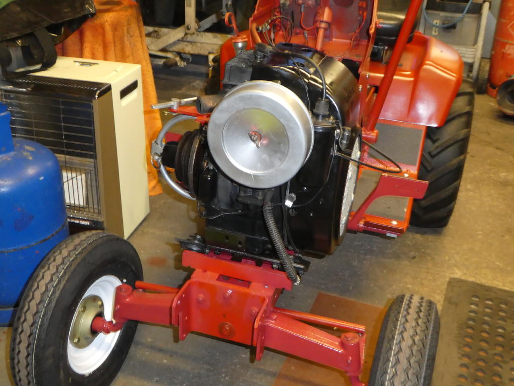

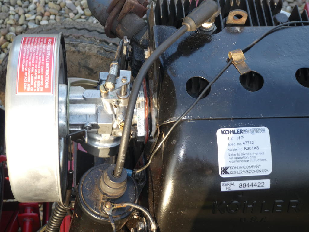

Stormin 9,988 #78 Posted December 26, 2018 Got back into the workshop today. Refitted the engine covers, carb etc and re-fitted the engine. Some head scratching was needed to remember where just and how the throttle cable went. C-81 and the C-121 are both different. But it fits and works ok where it is. Though I can't remember it sticking out the side. I'll have take more photo's in future. Not a very good photo' of the reconditioned carb. Richard (Anglo Tractor) has made a superb job of it. Better than new. I think I'll have to try and find another sump. A very slight weep has appeared. Not bad, but there. These things are sent to try us. Make life interesting and stop us getting bored.. I'll do the wiring done tomorrow and maybe fire it up. Still the bonnet/hood to finish and an exhaust to make up. Also tach-o-matics to do. 3 Share this post Link to post Share on other sites
Stormin 9,988 #79 Posted December 26, 2018 Just checked through some old photo's. The throttle cable does run down the out side. 5 Share this post Link to post Share on other sites

Stormin 9,988 #85 Posted December 27, 2018 Got the wiring done today. Couple of bad connections to sort out but mainly trouble free. Battery on and fuel in the tank and after a bit of priming and persuasion, the engine burst into life. Spent some time on carb setting till it ran something like. Had to re-seal the fuel pump due to a weep and the sump pan repair is doing fine. Just a trace of oil. No runs or drips. Should do until I can source anther pan. Found a home for a spring that seemed to be spare. Turned out it was the P.T.O. lever return spring. At one point I knelt down and my knee came in contact with a wheel nut on the floor. It was of a front wheel. Some numpty hadn't tightened them up. All wheel nuts front and back nice and tight. Getting there. 1 Share this post Link to post Share on other sites

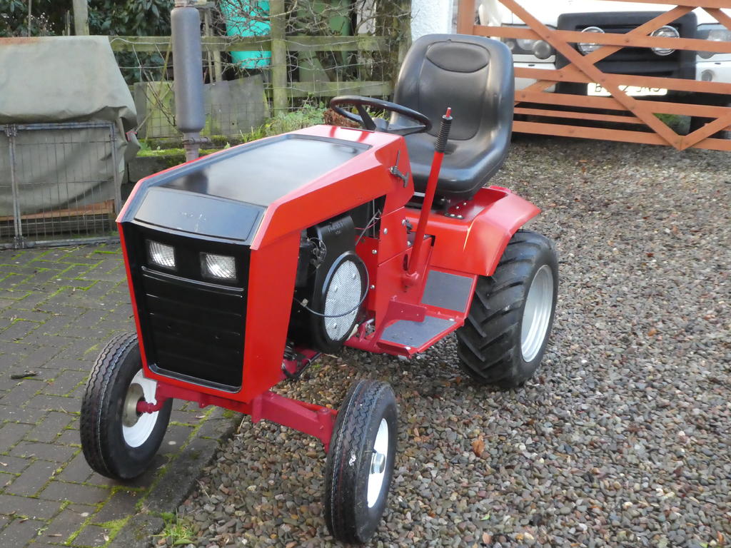

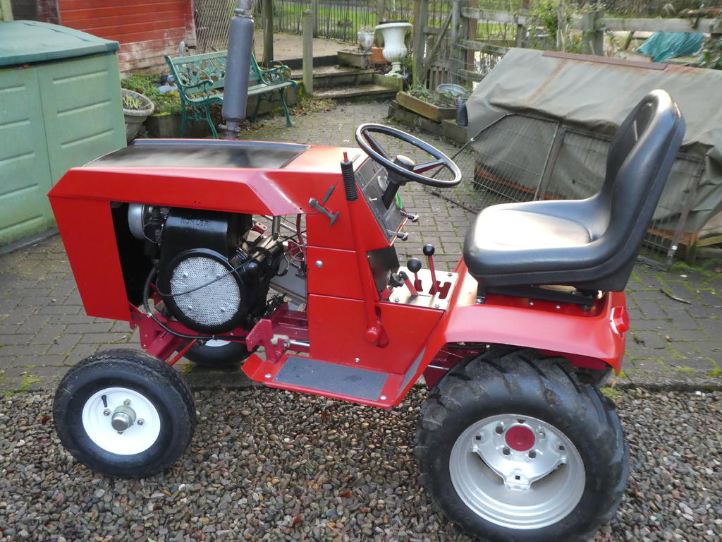

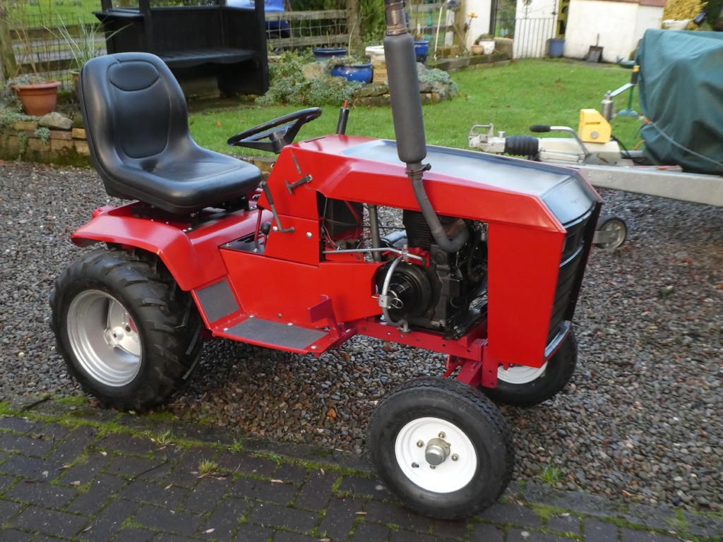

Stormin 9,988 #88 Posted February 10, 2019 Got some workshop time today. Got some minor bits and pieces and not much left. Tach-o-matics to finish painting and fit. Graphics to order. Also a new exhaust to make. May not be a stack, as one catches on low tree branches when mowing the green and verges. So photo's of the horse ready to put back in harness. That's all folks. 4 4 1 Share this post Link to post Share on other sites

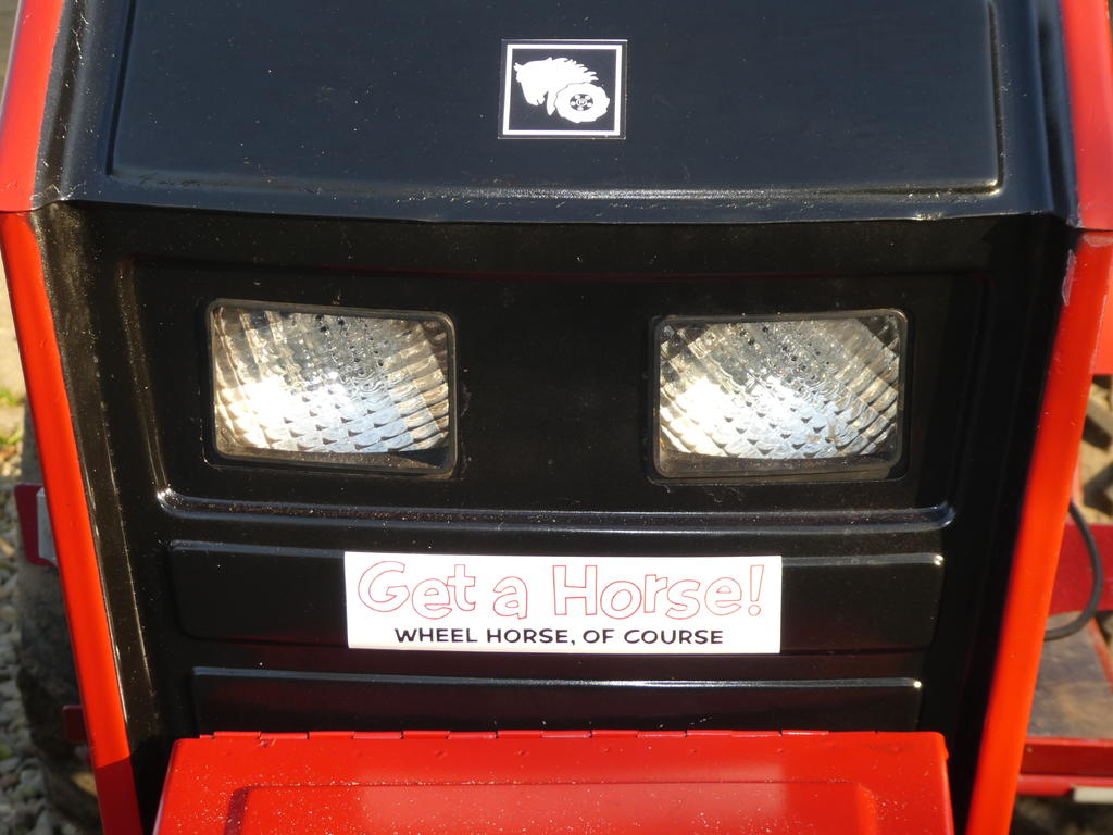

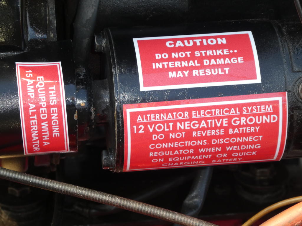

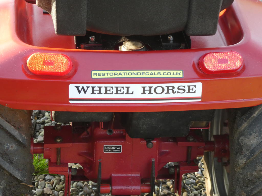

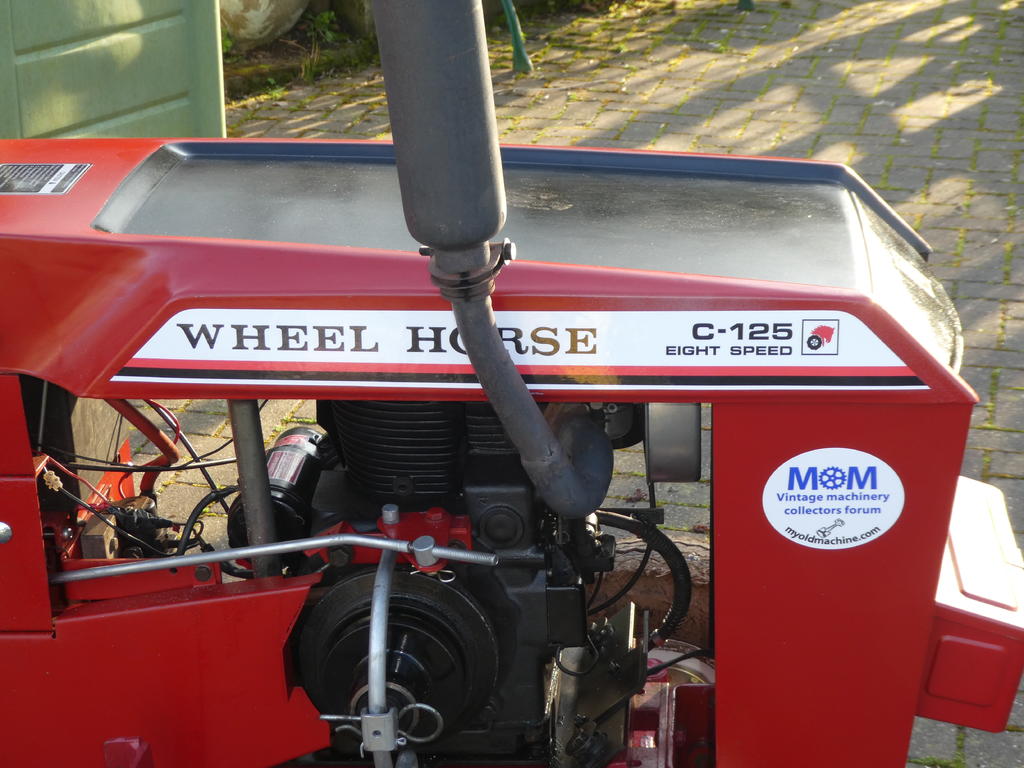

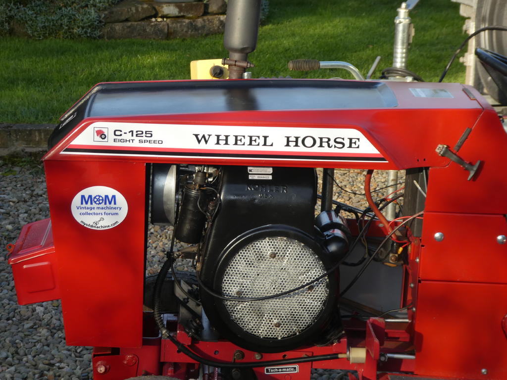

Stormin 9,988 #91 Posted March 28, 2019 To day I found on my return home from the farm, a small package. It contained the decals I'd requested from Restoration Decals. Aka :- Mark (Meadowfield) and his son and right hand man, Ewan (C-121) of Restoration Decals. They are now in place, so I suppose that makes the C-125 almost finished. Just a new exhaust system to concoct sometime. 2 Share this post Link to post Share on other sites
