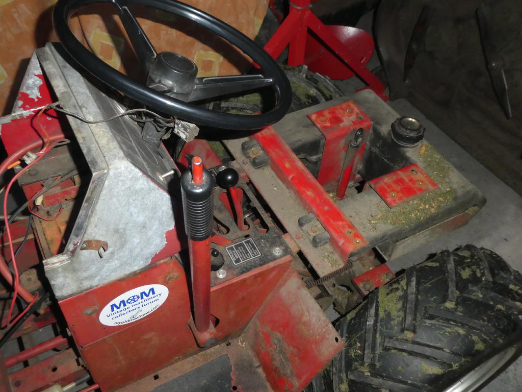

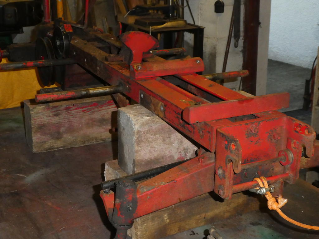

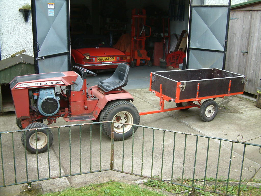

Stormin 9,987 #1 Posted November 14, 2018 (edited) My C-125 has seen a lot of work over the seven years or so I've owned it. Mowing the green and verges where I live and towing trailer loads of wood and other stuff. In that time all I've done is replace the head gasket and a stack to replace the rotten exhaust. Also fitted the rear wheels and ag tyres the were on the Black Horse. I've been meaning to strip the engine for some time, as it burns a bit of oil. Richard, (Anglo Traction) had some new surplus engine parts and a carb he'd rebuilt for sale. So they've found their way North and the time has come to give the old girl some attention. It won't be a total strip down of the tractor. I hope! She's a worker not a showgirl. Just a general tidy up and replacement of anything I find needs doing. I may throw some paint at her as well. First off came hood. Followed by seat and fender and wiring disconnected. Also the engine oil was left to drain. This morning I removed the engine and took off the antivibration plate. After draining off the fuel and removing fuel line and tank. Engine and gantry have been pushed on one side. I'm going to tackle the engine at a later date. I want to see too the rest of the tractor first. Foot boards came off next and top half of tower. Steering wheel and column came with it. As you can guess. the pin holding the wheel refused to budge. So this is were I'm up to. Next thing is a good pressure wash then up onto the bench. Edited November 14, 2018 by Stormin 13 Share this post Link to post Share on other sites

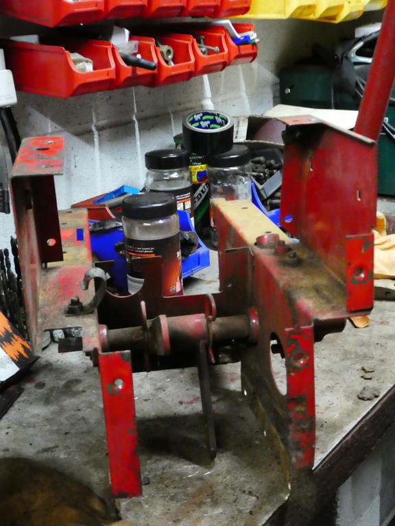

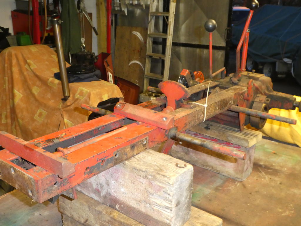

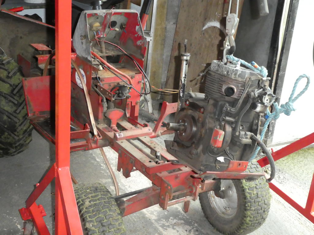

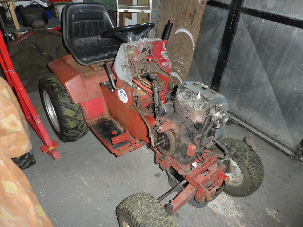

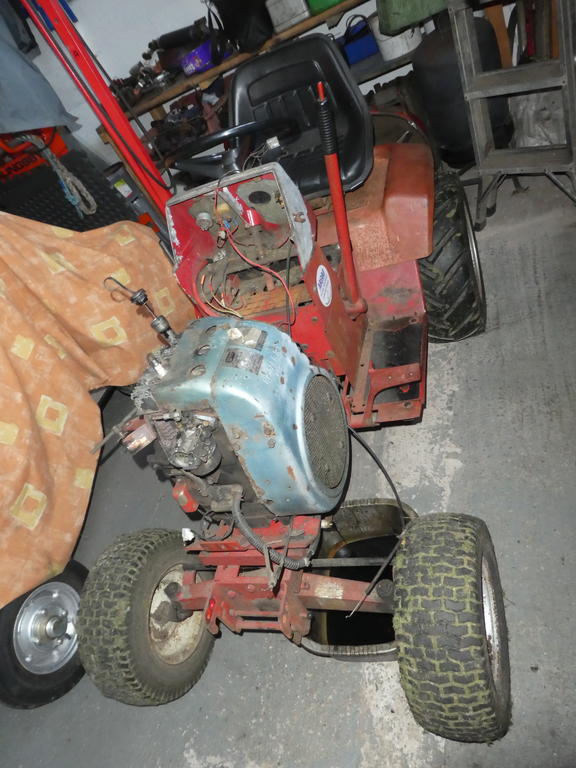

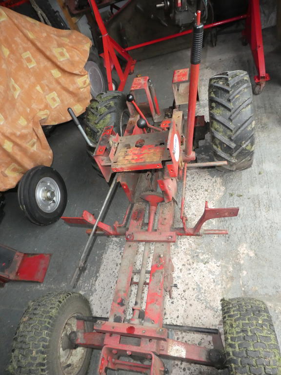

Stormin 9,987 #5 Posted November 16, 2018 On 11/14/2018 at 3:23 PM, Stormin said: It won't be a total strip down of the tractor. I hope! Famous last words. Todays progress. Rest of tower removed and up onto the operating table. Methinks someone got carried away. Also ideas are forming that shouldn't be. 5 2 1 Share this post Link to post Share on other sites
ebinmaine 77,123 #6 Posted November 16, 2018 1 hour ago, Stormin said: Methinks someone got carried away. Also ideas are forming that shouldn't be Hahahahahahaha I don't know if it's good or bad for you but I think I understand where you're coming from there. And you did kind of hold true to your word in a way. it's not a total strip down yet. There's still at least 8 or 10 bolts in that frame holding various things. 2 Share this post Link to post Share on other sites

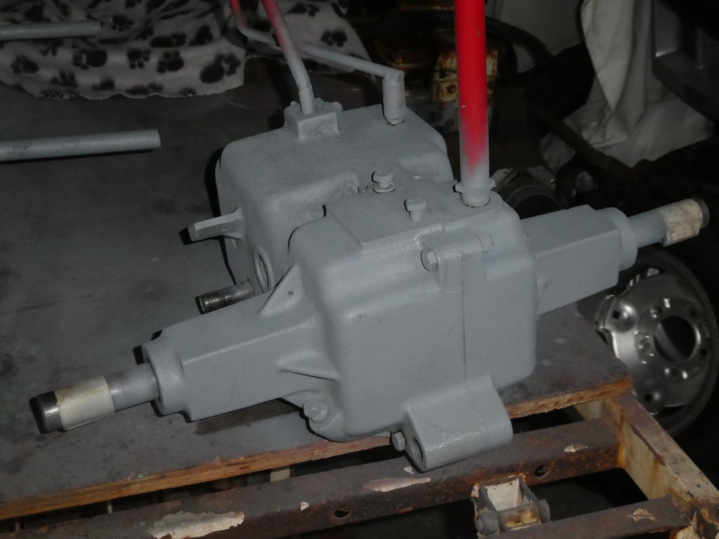

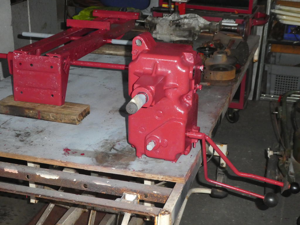

Stormin 9,987 #9 Posted November 17, 2018 (edited) Trans' and chassis separated this morning. Remaining parts removed from chassis and input pulley from trans'. Then the fun started. Wheel hub came off the brake side with just a few taps. The drive side was a different matter. Wouldn't budge one iota, even with pullers on. So off to the farm I went. After a pressure wash to remove as much of 30+ years of accumulated crud as I could, it was round to the workshop and bring the oxyacet' gear into play. Even with the hub nearly red hot the pullers still couldn't move it. We have an hydraulic set of pullers there, but someone has borrowed them. So off I went home. With the trans' back on the bench and hub cooled down, I decided to give it another try. Much to my surprise the hub started to move. Only just but it was moving. After about half an hour it was off. I could then see why it was so stubborn. The hub must have at sometime been knock on with one of the retaining screw, just sticking through and scored the shaft. All cleaned up now and hub slides on nicely. The box was then treated to scraper and wire rush to remove the remaining crud. Ready for a degrease now and primer. I need to get degreaser and primer. I also managed to get the roll pin out of the steering wheel. It's been getting regular squirts of penetrating fluid over the last few days. Now all I've got to do is get the wheel off the column somehow. Edited November 17, 2018 by Stormin 3 Share this post Link to post Share on other sites

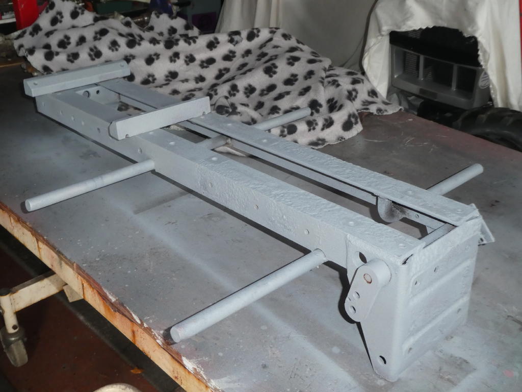

Stormin 9,987 #10 Posted November 19, 2018 Well the steering wheel is refusing to part from the column. Not to worry, it can stay there and I'll work round it. I have got the chassis and trans' degreased and primed today. Not ideal weather for painting. Although dry, there's a cold east breeze with a chill factor just above freezing. Before anyone says anything, yes, I've missed a bit on the chassis. That is now rectified. 2 2 Share this post Link to post Share on other sites

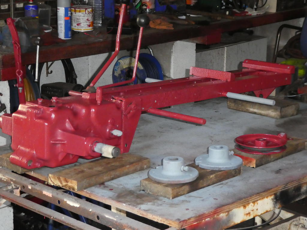

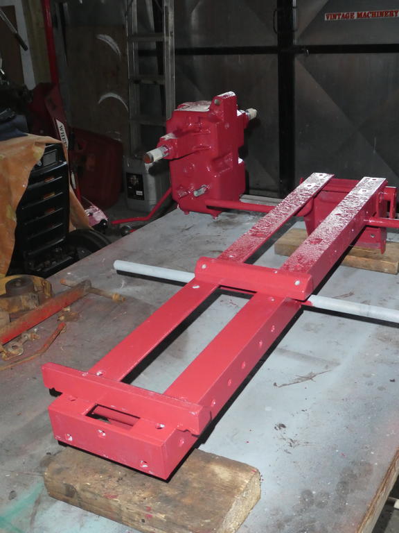

Stormin 9,987 #13 Posted November 20, 2018 Chassis and trans' painted this morning. Tor Agricultural Enamel. International Red. Applied by brush. 7 Share this post Link to post Share on other sites

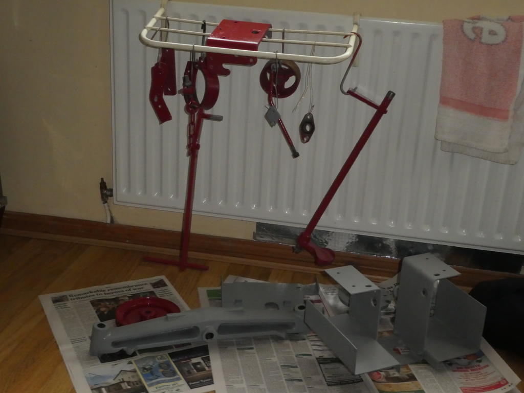

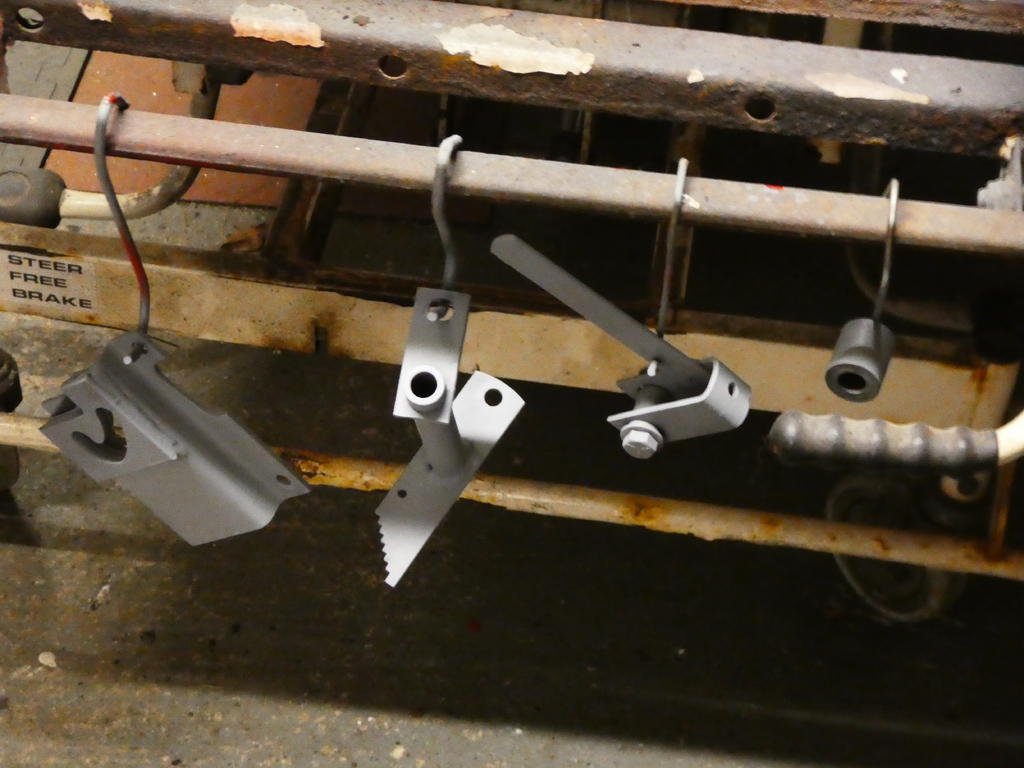

Stormin 9,987 #14 Posted November 21, 2018 Paint's taking sometime to dry due to the cold, damp air at this time. Bit a bit of progress has been made. Chassis and trans' back together, though a tad tacky in places. Got special dispensation from SWMBO to bring smaller parts in to the kitchen to dry. 3 2 1 3 Share this post Link to post Share on other sites

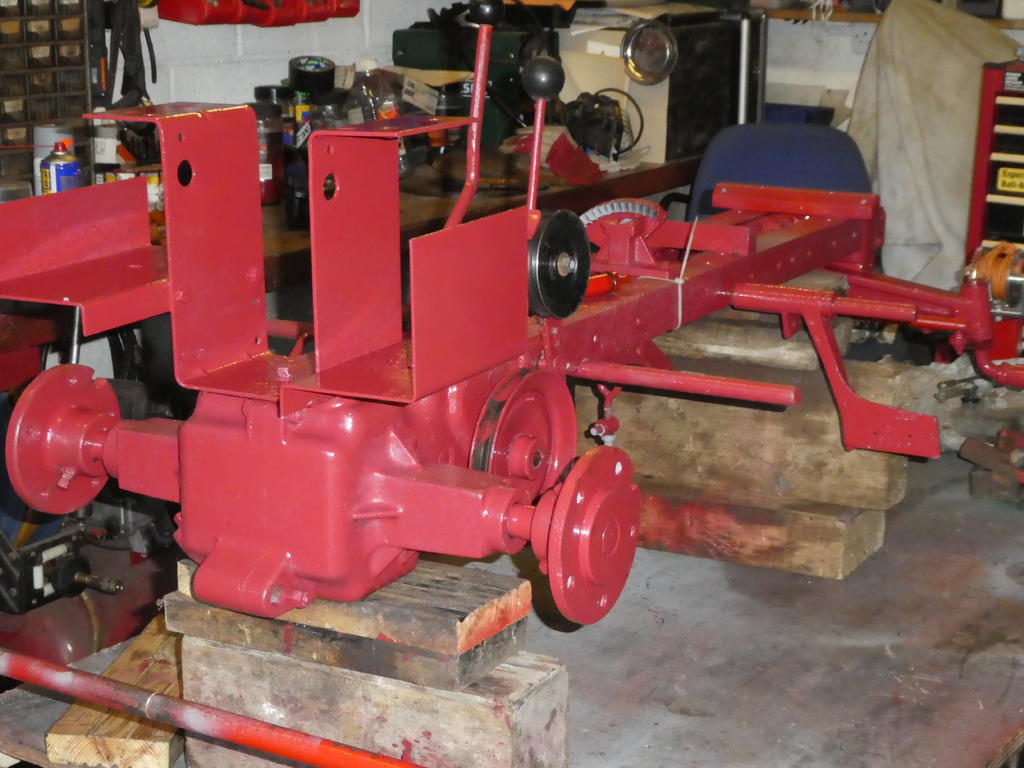

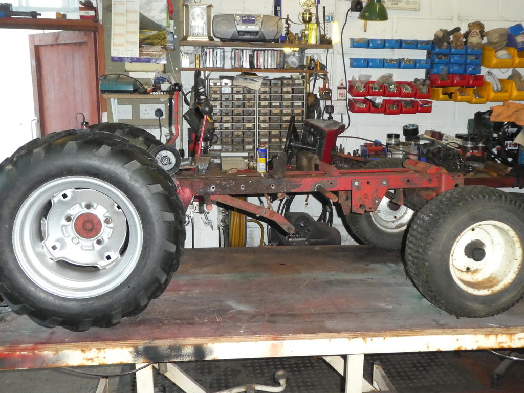

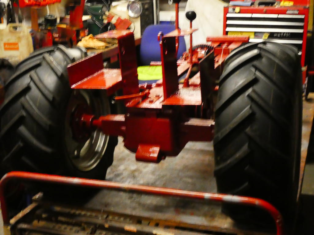

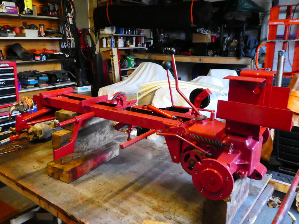

Stormin 9,987 #20 Posted November 24, 2018 Got a bit more done over the last couple of days. That's it for the time being. Give the paint some time to cure then get some wheels on. I can get it off the lift then and that'll give me room to get on with the other parts. 8 4 Share this post Link to post Share on other sites

Stormin 9,987 #23 Posted November 25, 2018 16 minutes ago, squonk said: Nice tidy shop Norm! You wouldn't say that if you could see it properly. Managed a couple of hours on the tractor this afternoon. Rear wheels on. Bottom half of tower stripped. Lift lever shaft and centre, part with the arms, refused to part company. But that's not a problem. Some little bits primed. 2 Share this post Link to post Share on other sites
