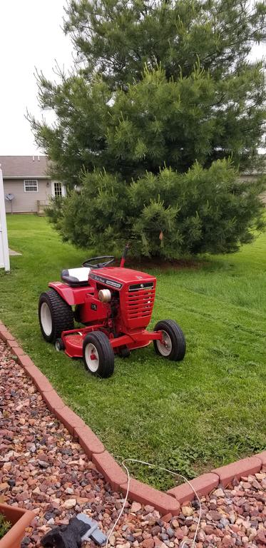

Vinylguy 4,771 #178 Posted May 30, 2019 Brought 857 home for a tough test on 8 inch grass. Performed like new and easily handled the tough conditions till she lost spark.🤔 Where to look first. All wires look good as far as I can tell. 1 Share this post Link to post Share on other sites
Vinylguy 4,771 #179 Posted May 30, 2019 Ran about 30 minutes then died like I turned key off. Turns over but no spark. Will try again when it cools. Share this post Link to post Share on other sites
pfrederi 20,665 #180 Posted May 30, 2019 Start at the coil got 12 volts at the + terminal ignition switch in the run position??? 1 Share this post Link to post Share on other sites
Vinylguy 4,771 #181 Posted May 30, 2019 1 minute ago, pfrederi said: Start at the coil got 12 volts at the + terminal ignition switch in the run position??? Thanks Unfortunately my tester is at the lake. Will check that tomorrow. Share this post Link to post Share on other sites
pfrederi 20,665 #182 Posted May 30, 2019 (edited) You could run a jumper wire rom Battery + to teh coil + and see if problem resolves. if not could be coil failure when it got warm or points issue. if adding jumperr doesn't work take points over off an d make sure they ar moving...some times the screw can loosen and they slip closed. Edited May 30, 2019 by pfrederi 1 Share this post Link to post Share on other sites
Vinylguy 4,771 #183 Posted May 30, 2019 (edited) Went back out after KB's Home Run and she started right up. finished the neighbors yard and still running. Something is getting warm and losing contact? Love the way these little 32 rear discharge decks cut. Think I will sell the 312-H and take the 857 to the lake. Edited May 30, 2019 by Vinylguy 2 1 Share this post Link to post Share on other sites
