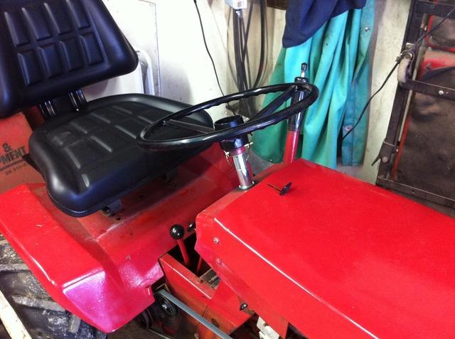

squonk 46,846 #129 Posted January 26, 2019 On 11/30/2018 at 4:09 PM, ronhatch said: I always thought that the late 1960 WH with the narrow hoods were the best looking units except for the steering wheel's position. IMO, it's too close to the dash/hood. So on my 867 I committed a mortal sin and added about 2" to the steering shaft which makes it look better (again IMO) and is more comfortable and has a more natural feeling. Did the same thing. Much better! 2 Share this post Link to post Share on other sites

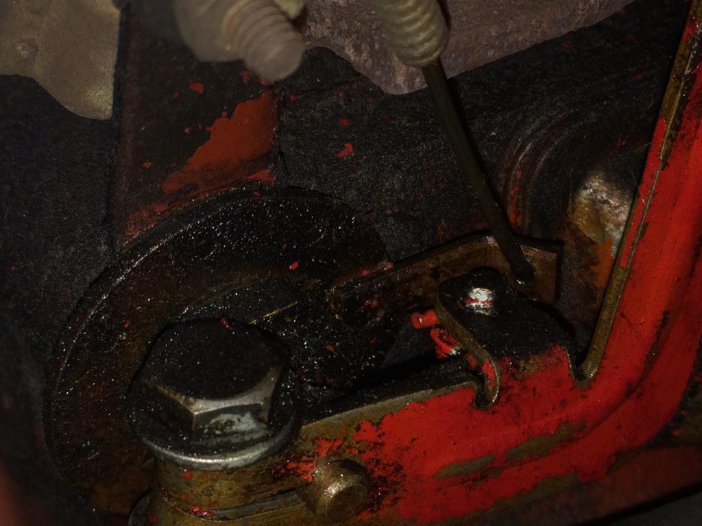

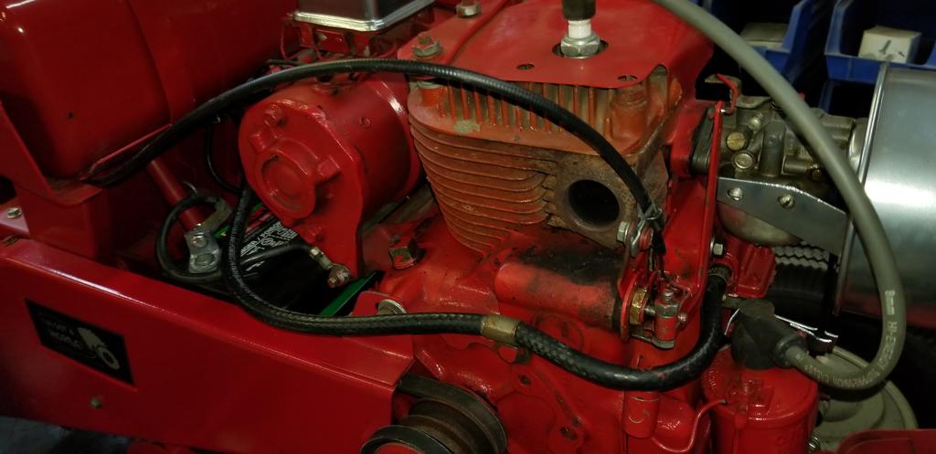

Vinylguy 4,771 #133 Posted January 26, 2019 2 hours ago, squonk said: Did the same thing. Much better! Squonk Would you be able to pop the hood and post a picture of your throttle, governor and carb setup? Share this post Link to post Share on other sites
squonk 46,846 #134 Posted January 26, 2019 39 minutes ago, Vinylguy said: Squonk Would you be able to pop the hood and post a picture of your throttle, governor and carb setup? Sure thing Terry Share this post Link to post Share on other sites
squonk 46,846 #135 Posted January 26, 2019 Here you go Terry. pretty sure this is all original. Pardon the sludge but this guy's a worker! 1 Share this post Link to post Share on other sites

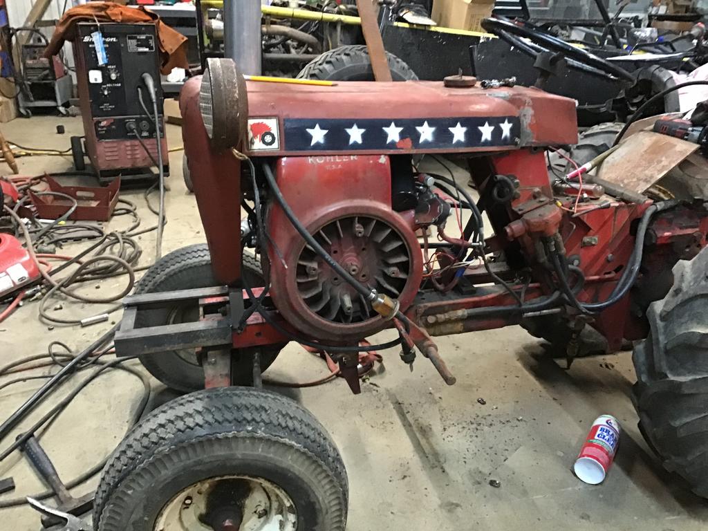

WHNJ701 4,172 #136 Posted January 26, 2019 On 1/24/2019 at 5:52 PM, Vinylguy said: I decided to try this wheel horse lettering instead? I wonder how that would look on a round hood? something different maybe the 854 I am redoing 2 1 Share this post Link to post Share on other sites

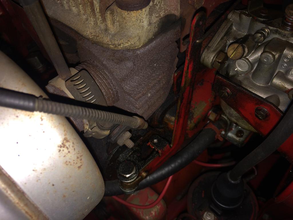

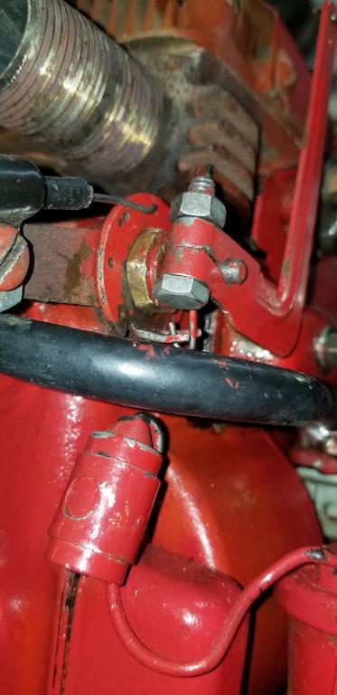

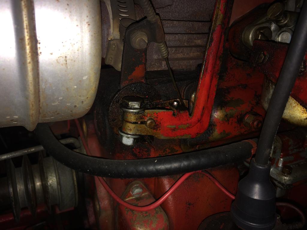

Vinylguy 4,771 #139 Posted January 27, 2019 (edited) 6 hours ago, squonk said: Here you go Terry. pretty sure this is all original. Pardon the sludge but this guy's a worker! Thanks Squonk Now i am really confused. That is how I had it before. Cable support over the top and hooked in the arm. I do need to get a leaking carb fixed or just buy a new carb but I starting to think I have governor issues maybe internal. So I changed it to what I saw in a manual? Still revs wide open. Think I need to call on my old friend Martin. He's only 30 minutes away Edited January 27, 2019 by Vinylguy Share this post Link to post Share on other sites
dells68 7,499 #140 Posted January 27, 2019 Almost sounds like the governor is out of adjustment to me. Might have been mentioned already and I didn’t see it. Check out an older thread “Kohler Governor Adjustment,” walks you through how to adjust the arm on the shaft. I’ve had this problem on a couple of the smaller Kohlers I’ve bought. 2 1 Share this post Link to post Share on other sites

Vinylguy 4,771 #143 Posted January 27, 2019 6 hours ago, jabelman said: I wonder how that would look on a round hood? something different maybe the 854 I am redoing Awesome idea. Will start working on an idea tomorrow 1 Share this post Link to post Share on other sites

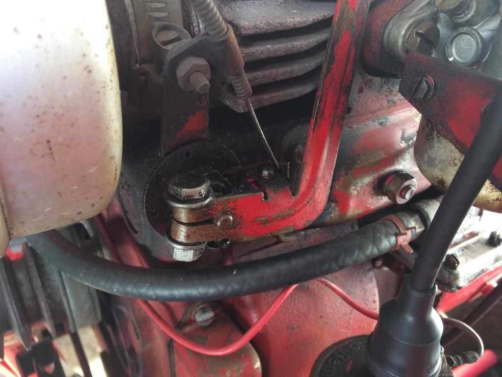

Vinylguy 4,771 #147 Posted February 5, 2019 On 1/25/2019 at 3:35 PM, WHX21 said: That girl definitely sounds to running fast Terry, Don't suppose there's a tach in the shop? Check your spring settings on the gov. Also check the high end throttle stop... lemme go get a pic of that. See if you have something like this. I think my k181 is missing some parts will try to get a picture tomorrow if I can get to the shop. Share this post Link to post Share on other sites
WHX?? 56,847 #148 Posted February 5, 2019 16 minutes ago, Vinylguy said: I think my k181 is missing some parts will try to get a picture tomorrow if I can get to the shop. II don't think you are Terry. The above pic is how a 10 HP is supposed to be I forgot you have an 8 HP which is a different animal. My bad Check Mike's pic in post 135 Share this post Link to post Share on other sites
dells68 7,499 #149 Posted February 5, 2019 I still think that chances are that the arm on the governor shaft needs to be adjusted. Loosen the nut on the shaft, rotate the shaft counter clockwise with a pair of vice grips, pull the governor arm as far away from the carb as possible, and lock the nut back in place. This will adjust your governor and hopefully slow it down and allow the governor to control the engine speed and keep it from reving so high. Just my $0.02. We bought a suburban and the little K91 sounded like it was screaming. Adjusted the governor and it's the best running K91 we have! 2 Share this post Link to post Share on other sites
WHX?? 56,847 #150 Posted February 5, 2019 See Tom's post 118 and more info in the manual. Share this post Link to post Share on other sites
