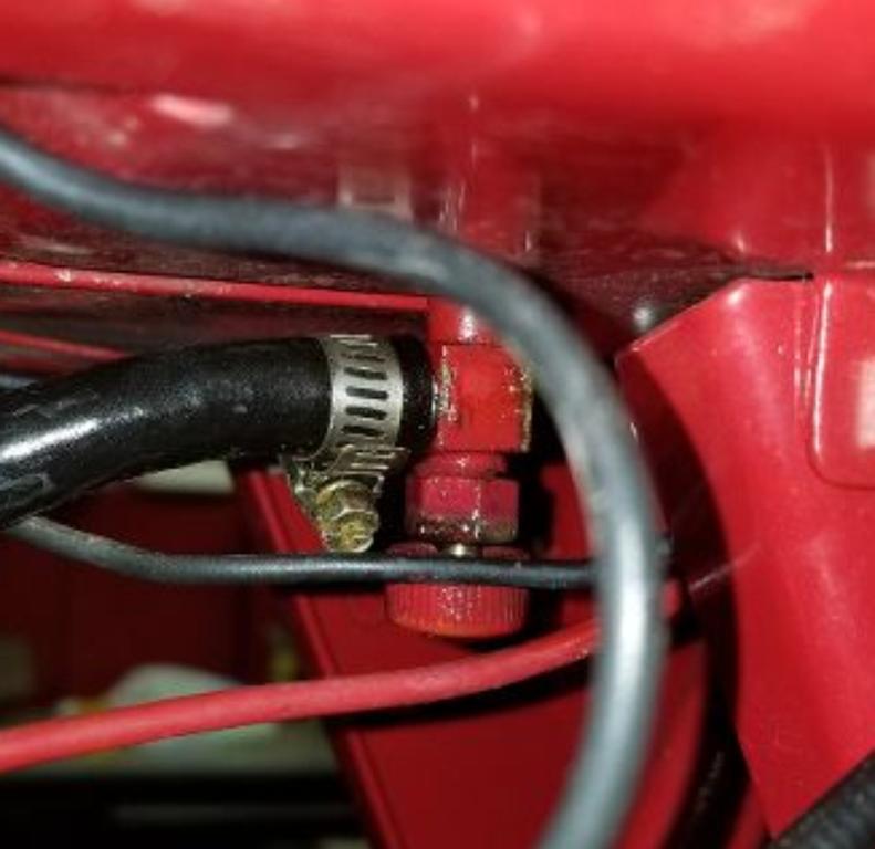

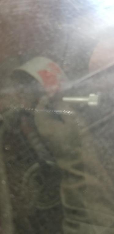

Vinylguy 4,797 #26 Posted November 17, 2018 Here is a picture of my fuel valve. Did not appear to be leaking at the hose clamp but I will remove the gas line next chance I get and make sure it is the valve and not the hose. When you open the valve fully it just drips a bit but as you close to half way it leaks a small steam. Share this post Link to post Share on other sites
ebinmaine 81,146 #27 Posted November 17, 2018 1 hour ago, Vinylguy said: Where should I look to find another petcock for the tank? Lincoln has those at a - z tractor 1 Share this post Link to post Share on other sites
Vinylguy 4,797 #28 Posted November 17, 2018 Just now, ebinmaine said: Lincoln has those at a - z tractor Thanks Eric. I will call him Monday 1 Share this post Link to post Share on other sites
ronhatch 410 #29 Posted November 17, 2018 Concerning the leaking gas valve; Tighten up the packing nut a little with a 7/16" wrench. 1 1 Share this post Link to post Share on other sites
Vinylguy 4,797 #30 Posted November 17, 2018 1 minute ago, ronhatch said: Concerning the leaking gas valve; Tighten up the packing nut a little with a 7/16" wrench. Will check it out Monday Thanks Ron Share this post Link to post Share on other sites
953 nut 70,344 #31 Posted November 18, 2018 2 hours ago, Vinylguy said: When you open the valve fully it just drips a bit but as you close to half way it leaks a small steam. If tightening the packing nut doesn't do the trick you can buy a new one on under the heading of fuel shut off 1/8 NPT. 1 Share this post Link to post Share on other sites
Vinylguy 4,797 #32 Posted November 18, 2018 31 minutes ago, 953 nut said: If tightening the packing nut doesn't do the trick you can buy a new one on under the heading of fuel shut off 1/8 NPT. 1 Share this post Link to post Share on other sites

lynnmor 9,073 #35 Posted November 21, 2018 On 11/17/2018 at 5:04 PM, Vinylguy said: Here is a picture of my fuel valve. Did not appear to be leaking at the hose clamp but I will remove the gas line next chance I get and make sure it is the valve and not the hose. When you open the valve fully it just drips a bit but as you close to half way it leaks a small steam. That type of hose clamp works poorly on small fuel lines, consider replacing it with a spring clamp. 2 Share this post Link to post Share on other sites

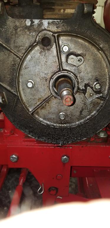

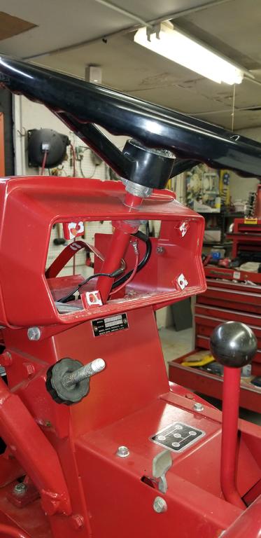

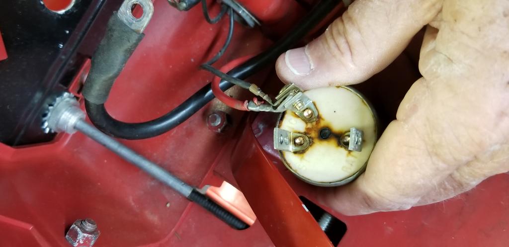

Vinylguy 4,797 #37 Posted November 30, 2018 (edited) Today we begin. Replacing the flywheel side seal and decided to powder coat a few things. Also removed the dash and are going to try out a different tactic. Was going to put one of my dash decals but decided to powder coat it chrome and just use the bottom section decal And try to cut the very tiny letters from black vinyl for the dreaded rib. Will post pics when done. Gary is blasting air cleaner cover, dash and flywheel screen in preparation for powder coating while I am bagging and marking bolts and taking pics. Also going to replace the ignition switch. Discovered the lighter was not wired so it probably does not work. We will find out soon enough on that. Cleaning a ton of oil and grime off the case. This steering cap decal is a bit larger than the ones I make. Will be making both sizes from now on. Edited November 30, 2018 by Vinylguy 2 6 Share this post Link to post Share on other sites

Vinylguy 4,797 #43 Posted November 30, 2018 Powder coated the dash today. Going to try an idea I mentioned earlier. It was powder coated black and now it's chrome. It has some pitting but that's ok. Not looking for a show piece just nice looking worker. Share this post Link to post Share on other sites

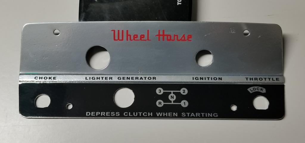

Vinylguy 4,797 #47 Posted December 1, 2018 Got in a bit of a hurry so I will redo this one and make some adjustments in the template while at it. Was able to cut the red wheel horse lettering ok and the black words on the rib are printed on a strip of clear. The bottom is cut from one of my current dash decals. 4 5 Share this post Link to post Share on other sites
Vinylguy 4,797 #48 Posted December 1, 2018 I wont be ready to reinstall the dash for a week or two so have time to perfect this 1 Share this post Link to post Share on other sites
ebinmaine 81,146 #49 Posted December 1, 2018 10 minutes ago, Vinylguy said: Got in a bit of a hurry so I will redo this one and make some adjustments in the template while at it. Was able to cut the red wheel horse lettering ok and the black words on the rib are printed on a strip of clear. The bottom is cut from one of my current dash decals. Terry I think that looks fantastic. We have a couple more to do here. Please keep sharing how you get that done. We'll be interested to see how it comes out. Share this post Link to post Share on other sites
rjg854 13,422 #50 Posted December 1, 2018 Nothing wrong with that, looks great, wouldn't mind seeing that on one of my Commandos 1 Share this post Link to post Share on other sites
