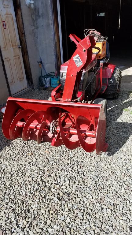

David Portenier 8 #1 Posted November 12, 2018 Hello all, I recently acquired a two-stage blower and started the process of putting it on my 520h. Everything is going by the book with the exception of the anti-sway bar. It seems like it wont line up with the holes in which it is suppose to line up with on the tractor. Has anyone else had this issue? Thanks Share this post Link to post Share on other sites

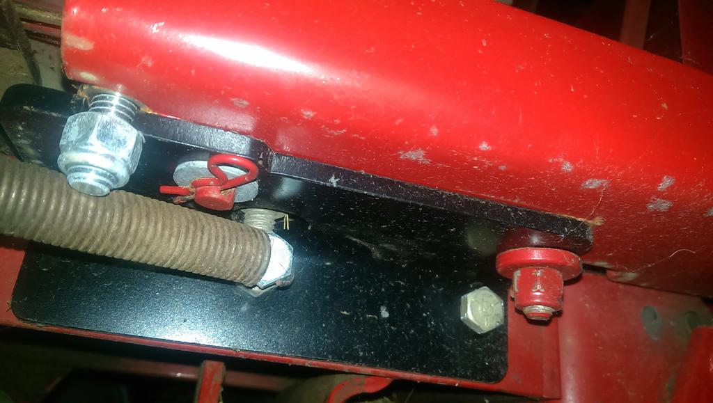

WVHillbilly520H 10,378 #3 Posted November 12, 2018 Which holes are have trouble with...i painted the frame mount black which would stay on the tractor year around and since I didn't get the belt guards I made my one sway bar which has the red and silver bolts plus the pin with hairpin cotter, Jeff. Share this post Link to post Share on other sites
kwalshy 246 #4 Posted November 18, 2018 David, Yes I’ve experienced the same issue as you. I’ve operated the 2 stage on my 520H for a few years with out the anti-sway bar, no issues. I finally tracked a used one down & the holes on it didn’t line up either. I have not encountered or saw any ‘wear’ or ‘rub’ that would indicate I need to modify the bracket & mount it to the tractor’s frame. Share this post Link to post Share on other sites
Shippey 2 #5 Posted October 14, 2019 I realize this is an old-ish post but I thought I'd try. I just bought a Toro/Wheel Horse 44" 2-stage snowblower (model 79631) and put it on my 520H. I too did not get the anti-sway kit nor the belt guard. I don't see the anti-sway brace in the parts manual although it is in the operators manual in the mounting instructions. Seems like you're saying I don't need it. Would you confirm you've had no problems operating without it? Share this post Link to post Share on other sites
