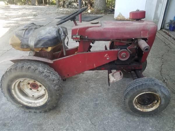

Cetan08 311 #1 Posted November 8, 2018 Saw this on CL and have no idea what model it is. Has no deck and as you can see,no seat. Says it runs good and wants 300. I am thinking a bit high. Not sure that I have the funds right now anyway. What would be a fair price? Thanks 1 Share this post Link to post Share on other sites
Pullstart 68,887 #2 Posted November 8, 2018 I’d guess a ‘63 model of some sort, based on the tank shape and the front frame having the later axle with better steering radius Share this post Link to post Share on other sites
Pullstart 68,887 #3 Posted November 8, 2018 And besides, that is an awesome seat! It was most likely the p.o.’s favorite love seat! 2 Share this post Link to post Share on other sites
lynnmor 8,629 #4 Posted November 8, 2018 Worth every penny if you enter it in the ugly seat contest, a sure winner for years to come. 4 Share this post Link to post Share on other sites
953 nut 64,133 #5 Posted November 8, 2018 Hood is cut, wrong engine, no seat, lots of bad modifications and buying parts and repairing the hood will set you back more than the purchase price. I would keep looking! Share this post Link to post Share on other sites
stevasaurus 23,617 #6 Posted November 8, 2018 It is at least a 1963...it has the star wheel adjust knob. Being in Ohio, you can find parts, but it is not worth $300...that is a free to $100 horse. BTW, those are the original tires. If it runs, the engine is probably worth $100. You can find a lot better for $300. 1 1 Share this post Link to post Share on other sites
Elkskin's mower junkyard 1,117 #7 Posted November 8, 2018 It looks like a 64 being 5 lug 1 Share this post Link to post Share on other sites
Cetan08 311 #8 Posted November 8, 2018 Thanks everyone. It's funny how these guys think they are sitting on gold. I was thinking it had been damaged. I had never seen a hood like that but wasn't sure. Share this post Link to post Share on other sites
Elkskin's mower junkyard 1,117 #9 Posted November 8, 2018 (edited) I wouldn't let my 701 go any less than 800 has is lol but I like it lol of coarse it has hydrolic lift and midmount Edited November 8, 2018 by craftsmanmowerfreak Share this post Link to post Share on other sites
stevasaurus 23,617 #10 Posted November 8, 2018 If you look close, it is only 3 bolt hubs...all the tire rims had 5 holes. It's too bad they cut the hood like that. That horse running....along with a mower deck and a blade for snow...now maybe $300. You can get a mower deck and a snow blade for $200 or less...makes the horse a free to $100. Share this post Link to post Share on other sites
