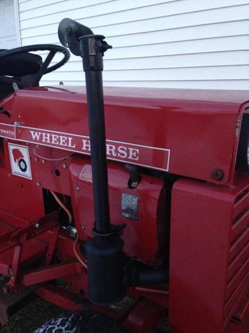

Hodge71 691 #36 Posted January 31, 2014 Zane heres a pic of the stack on my 18 auto….Gravely muffler and an 18inch stack with flapper. It may work better for your awesome rest project Share this post Link to post Share on other sites

Hodge71 691 #39 Posted January 31, 2014 (edited) Zane the stack is 1 inch black pipe I turned down on a lathe to 1 1/4 instead of 1 3/8.I got it at my Local plumbing supply guy. it can be bought at Home Depot or Lowes but I like to support local businesses even if it costs me a couple dollars more Leeave…Mine doesn't pose a problem as the weight it distributed between two very heavy cast iron manifolds on the K482 Edited January 31, 2014 by hodge71 Share this post Link to post Share on other sites
