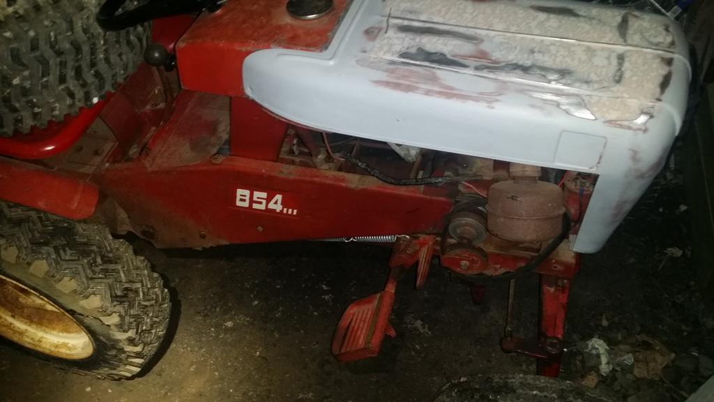

WHX?? 58,173 #80 Posted November 9, 2018 Best listen to the one who is to be obeyed! I do have one ? tho 'Rod ... actually two ??.. have we seen of this so called 854 and if it is 100% original why mess with it? Just clean it up, get mechanically sound and run her. Same with the aka 1047? 3 Share this post Link to post Share on other sites
bellevillerod 836 #81 Posted November 9, 2018 2 minutes ago, WHX21 said: Best listen to the one who is to be obeyed! I do have one ? tho 'Rod ... actually two ??.. have we seen of this so called 854 and if it is 100% original why mess with it? Just clean it up, get mechanically sound and run her. Same with the aka 1047? I was going to take so pics of the group today and the 854 just looks so tired. Besides that when I went to get her the pics that were provided me missed the big dent in the hood. I really wanted to do an old round nose in Linseed & mineral spirits and show the patena. I think that age & wear look sweet. But the hood was so badly dented I had to fix it. Ya without a pic ........I know lol .....this is just for you..now my socks are wet. 2 2 Share this post Link to post Share on other sites
oliver2-44 11,757 #82 Posted November 9, 2018 You could ?age/patina" the hood after you gry ir repaired and painted. Deveral on here have done it by sanding some area thin and some to pare metal. Then using salt and vinegar to rust those areas to match the rest of the tractor. Thats one way to keep it original. 3 Share this post Link to post Share on other sites

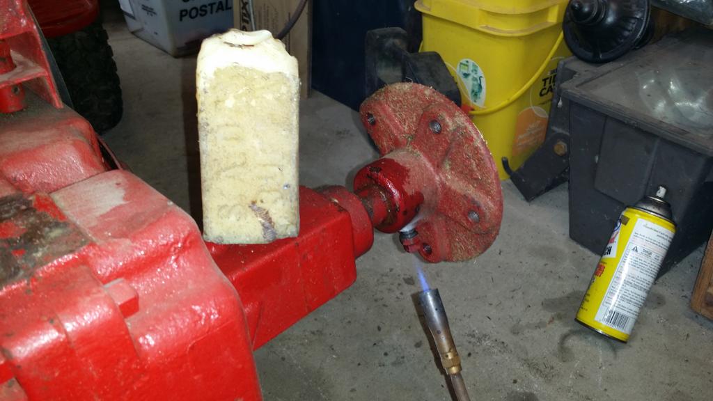

bellevillerod 836 #83 Posted November 10, 2018 (edited) Oh my God... Lol I have been out here all day working on the tractor. This baby was rode hard and put up wet. I see why this guy was putting it out. He did greatly mislead me to it's condition. This trans has both rear axels wobble, hub on left side is worn bid so tire sits at an angle. At some point someone tried to remove the hitch pin and mushroomed it over both sides. The hub on the right side is not coming off, even though I heat it up good. What's wrong with just cutting it off and buying two off fleabay? I'm afraid I will damage the internals if I keep pounding on it. Unless you have a easy fix you can share! I just read my post sorry for the grammar and spelling lol, I'm dirty and flustered. Edited November 10, 2018 by bellevillerod 1 Share this post Link to post Share on other sites

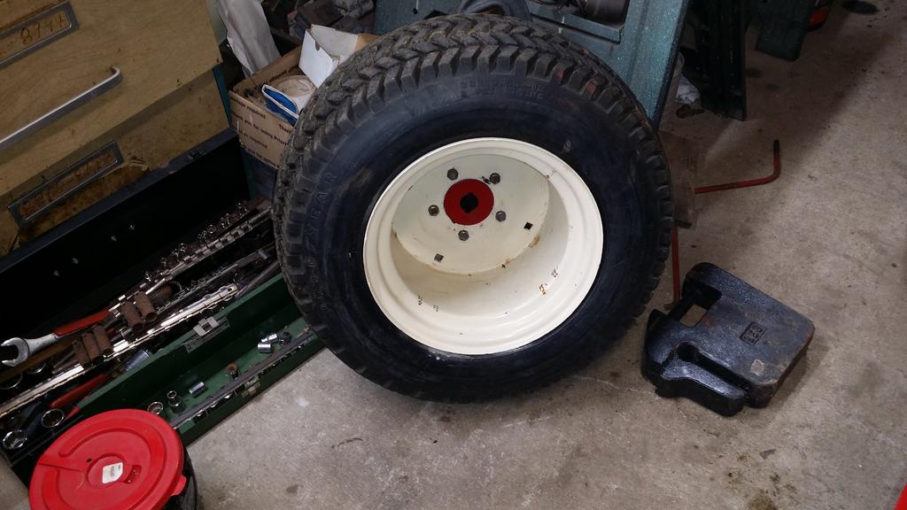

bellevillerod 836 #84 Posted November 10, 2018 I did get the pin out and everything else but it was fighting me the whole time. Like they painted the hubs and then installed the tires so they were glued together lol. Rims are a bit different than I have ever seen before. Share this post Link to post Share on other sites
bellevillerod 836 #85 Posted November 10, 2018 Well it's 3 am and it is split and laid out on the bench. Done for the night, using the other hub for a puller just got me 2 broken hub's. Had to take a metabo and split the one hub and still had a time getting it off. looked like at some point they had spun it and used green loctite to help hold it in place. So if anyone has a set of hubs and needs some extra cash, hit me up! almost all the bearings are shot. So I'm thinking might as well replace them all and be done with it. Thanks for the all the help your gonna provide..... 1 Share this post Link to post Share on other sites

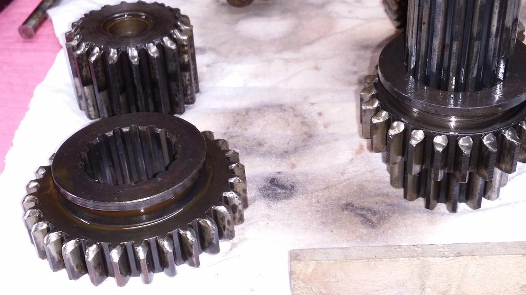

stevasaurus 23,856 #88 Posted November 10, 2018 Rod, take a few pictures of the gears please...let's see what they look like. 1 1 Share this post Link to post Share on other sites
bellevillerod 836 #89 Posted November 11, 2018 (edited) 12 hours ago, stevasaurus said: Rod, take a few pictures of the gears please...let's see what they look like. With the input shaft bearing completely shot the shifter gears are showing some wear. The hi/lo fork is also worn, not sure what I can get by with? Thanks for taking the time to look at this for me. Thank God I took it apart when I did. None of the bearings had worn though and into the shell although it was very close. Here are pics of the 3 that are showing abuse. Edited November 11, 2018 by bellevillerod 2 Share this post Link to post Share on other sites
stevasaurus 23,856 #90 Posted November 11, 2018 Those 3 gears...1. reverse idler (4204)...2. 1st/reverse fork gear (5174)...3. 2nd/3rd (5173) are the same gears in the #5060 6 speed and in the #5091 and #103907 8 speeds. If you can find better gears, do it. Also, from what I can see, it looks like the hi/low mechanism is also the same. 1 Share this post Link to post Share on other sites
