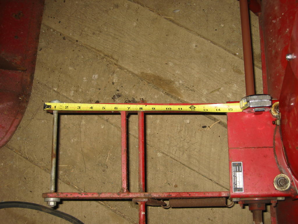

D_Mac 9,333 #1 Posted November 1, 2018 (edited) Chance to buy this single stage snow blower attachment but not sure if it would fit my 308-8 or not. The owner dosnt know the model number but says it is close to a 6-211 or st4201 but he can not be sure. He said it was mounted on a 1971 Raider 12. That and these photos is all I have to go by. Lets say it would fit my 1986 308-8. Does the Magnum 8 pack enough ponies to make it all worth it? Upstate NY we get our fair share of snow. I already have a beast of a snow blower that gets the job done. I can buy the attachment for 100 bucks. Value any of your thoughts on the matter. Thanks Edited November 1, 2018 by D_Mac bad photos 1 Share this post Link to post Share on other sites
pfrederi 19,459 #2 Posted November 1, 2018 (edited) You may need to modify the mounting frame or get a different one. Hard to tell from you picture but is there a welded in rod near the end of the mounting bracket (Circled in BLue) or just two holes that would accommodate a long bolt. For your tachmatic you need the shorter bracket with the welded in rod. The second two pictures show the difference you need #3 I think you have #2 Edited November 1, 2018 by pfrederi 2 1 Share this post Link to post Share on other sites

D_Mac 9,333 #4 Posted November 1, 2018 Great photos explaining what I need. Thank You. I asked the seller for more pictures. Those are the chains for the tires that are covering the mount in the sellers photos. Like I said I have a 10 hp Husqvarna that I use. I would rather have a blade for the 308-8 but I have not stumbled across one yet. I would imagine I would need the same type of mount for a blade as I would for the snow blower. Share this post Link to post Share on other sites

D_Mac 9,333 #9 Posted November 4, 2018 Well as it turned out it was the wrong mount. PFREDERI was right on with his photos. I passed on the set up even though it is a good deal. Thanks to everyone for the help. Share this post Link to post Share on other sites
