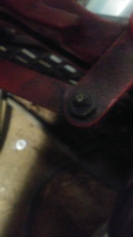

Elkskin's mower junkyard 1,117 #1 Posted November 1, 2018 I am getting slop in this area on both 701 and 552. And I checked my parts axles and they also have the play. Is there any way to fix it? I am unsure if 502 has the slop or not since it sits lol I don't mess with it. But pulling the 552 and 701 on work pad I got you can tell the play is there besides the loose steering from left to right due to the slop Share this post Link to post Share on other sites
Shynon 7,543 #2 Posted November 1, 2018 Either the bar is worn out or the pin. 1 Share this post Link to post Share on other sites
953 nut 64,139 #3 Posted November 1, 2018 It is just a 1/2-13 bolt and jam nut going through a steel bar, nothing too high tech. and all of it can be purchased at Ace Hardware. It is likeley that after nearly six decades there is a bit of wear on the bolt and the bar. 1 Share this post Link to post Share on other sites
Mike'sHorseBarn 3,417 #4 Posted November 1, 2018 If it's too bad, you can drill it out and put in a bronze bushing. 2 Share this post Link to post Share on other sites
