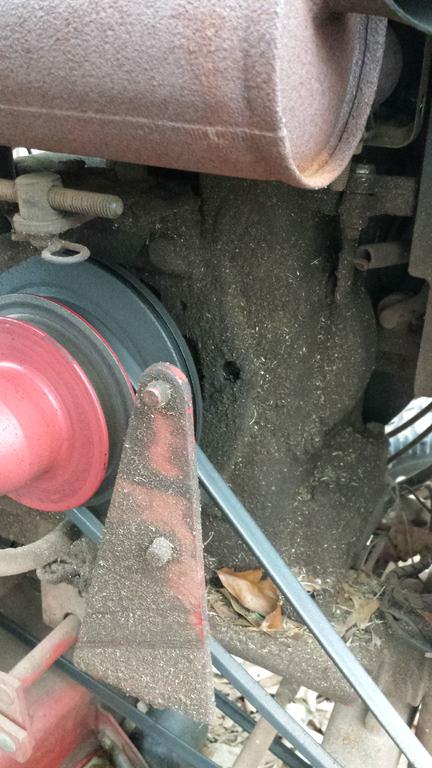

wrightorchid 261 #1 Posted November 1, 2018 The pto side of the engine is leaking oil at the small hole on the side. It has gotten much worse recently. Any ideas? Share this post Link to post Share on other sites

Achto 30,838 #3 Posted November 1, 2018 I think the hole that you are referring to is the one for the cam shaft pin. When you install the cam this pin is driven into that hole, it is an interference fit & this is what creates a seal. Your pin may have loosened up causing it to leak. Once the bearing plate is installed on the engine I do not believe that this pin can fall out. I would clean the hole out with some brake cleaner to get it as dry as possible, then fill the hole with silicone. Other option would be the to pull the bearing plate off and reset the pin. 4 1 Share this post Link to post Share on other sites
JAinVA 4,638 #4 Posted November 1, 2018 (edited) A small amount of oil is not that unusual but that looks more than a small amount.Clean the engine with something like purple clean from Tractor Supply. Once clean it should be easier to trace where the oil is coming from.The possible leak sources and their repair are spot on but make sure of the source. Edited November 1, 2018 by JAinVA 1 Share this post Link to post Share on other sites
wrightorchid 261 #5 Posted November 1, 2018 It is from the hole on the side. It is very dirty/oily. I'll try to clean and seal. Thought there might be a plug or something that went there. Thanks. 1 Share this post Link to post Share on other sites
