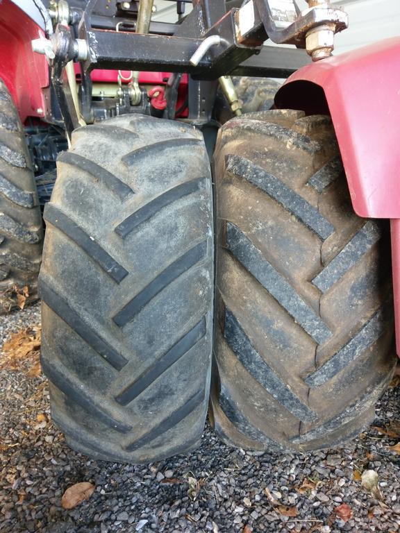

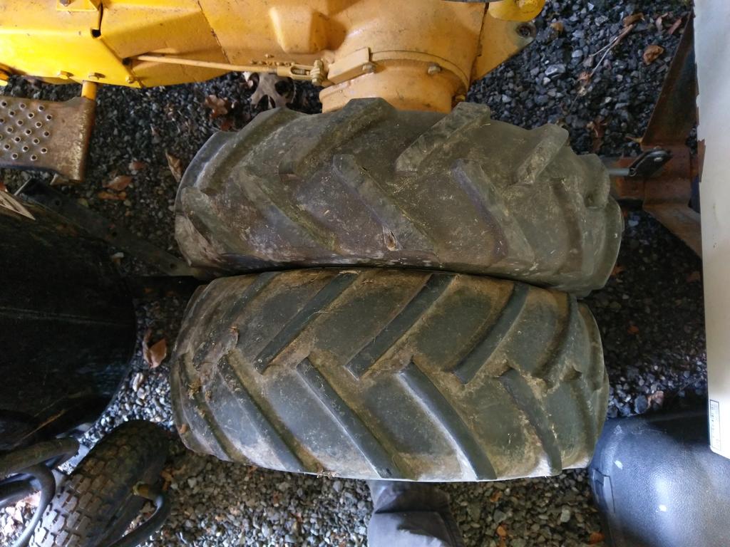

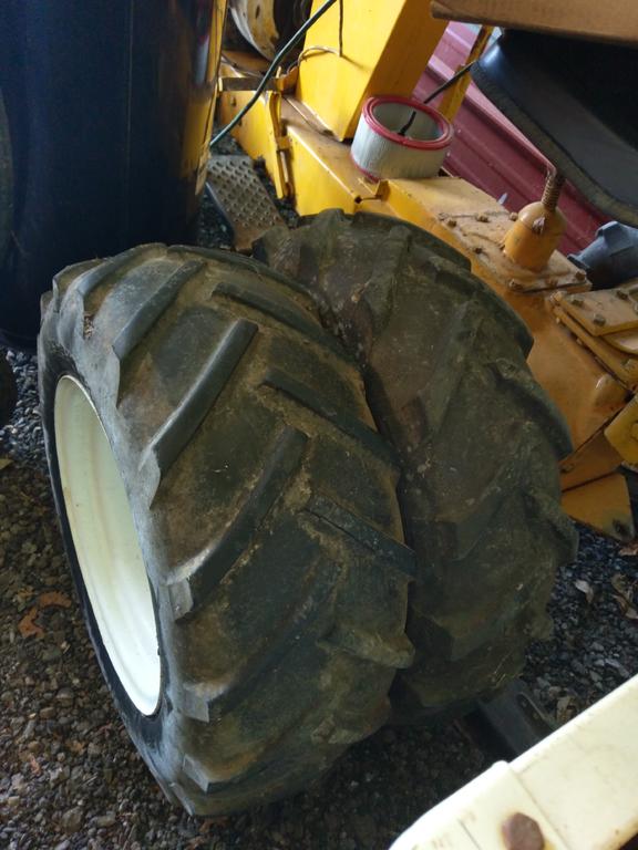

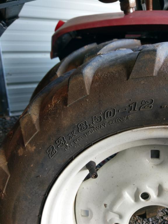

WVHillbilly520H 10,378 #20 Posted December 7, 2018 Here they are...1&2) 23x8.50-12 "DURO" next to a 6-12 3) the side wall 4) next to an off shore brands 23x10.50, IMHO I believe for yard duties and occasional snow removal the 23x8.50-12 I refered (linked) to above will serve you well on the narrow rims, Jeff. Share this post Link to post Share on other sites
