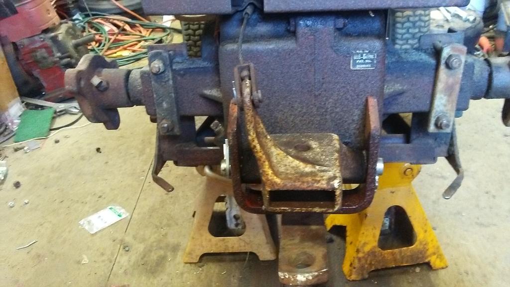

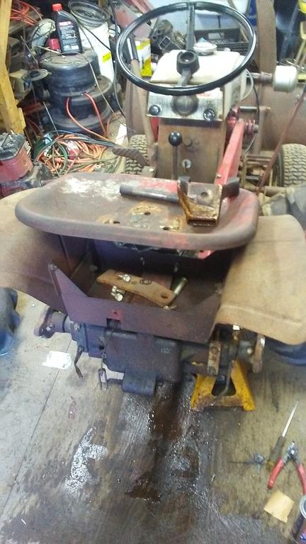

Just a little heat from a propane torch and water plus lots of lube. And my air hammer went to work annnnnnnnnd success. Now putting in new rod and newer hitch on the 552 like I done to the 701 and 502. I got 1 more for 753 too

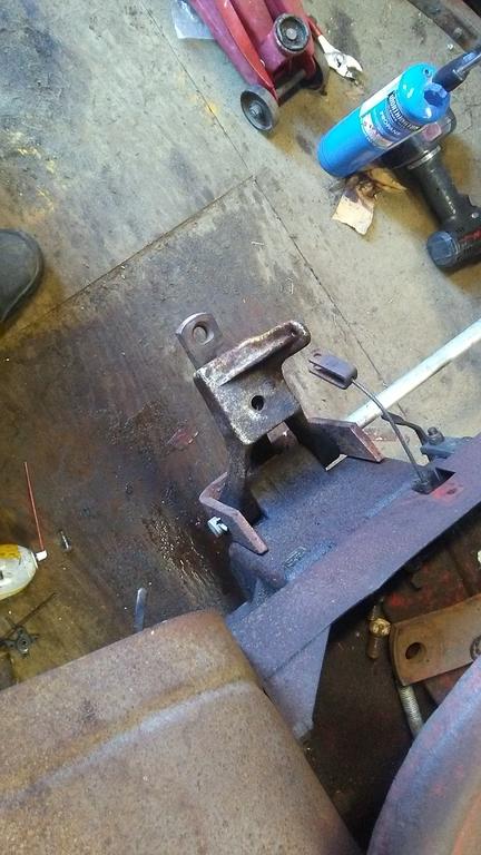

Just pulled new pin after cutting it and drilling hole doesn't look bad. I know it's not original but I got plenty of this 3/4 inch rod stock lol
