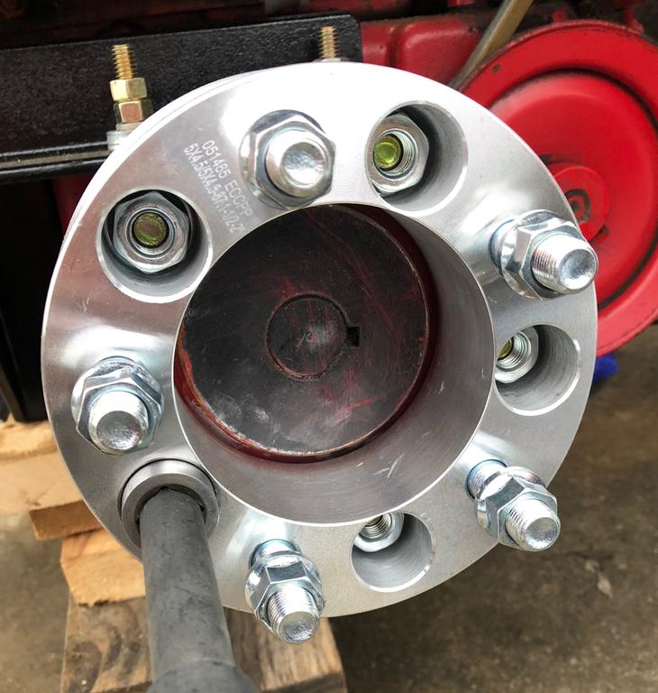

Mows4three 833 #1 Posted October 28, 2018 Hello folks, I'm attempting to install some 2" wheel spacers on my 312-8 so I can run chains on it at hunting camp. Thought I needed 7/16" - 20 x 1 1/2" fully threaded hex bolts. Turns out they fell 1/2" short. You can see in the accompanying photo that the lug nuts only engage the bolts by half of the length of the thread in the nut. I have searched the old inter-web for grade 5 (preferred) or grade 8 bolts that are fully threaded and I am coming up mostly empty handed. I did find them for something like $5 each plus shipping from Grainger in a pack of 25, but like my grandma used to say, "We ain't the Rockefellers," and I can't see paying that much when I just need ten bolts. Does anyone have any 7/16" - 20 x 2" fully threaded hex bolts they would be willing to part with at a decent price or do you have a source for these bolts where I could get some that are reasonably priced? Appreciate your input and replies...... Cheers! Dave 1 Share this post Link to post Share on other sites

wallfish 19,324 #7 Posted October 29, 2018 Why not just use the bolts you have and bolt the spacer on from the front and don't use the nuts? Are those nuts smaller than 5/8 hex? 1 Share this post Link to post Share on other sites
Mows4three 833 #8 Posted October 29, 2018 Thanks. McMaster Carr is a good suggestion. I forgot about them. I'll try Lowes, too. Probably reasonably more priced, if they just have fully threaded bolts. I'm finding that most 7/16" - 20 are not fully threaded over 1 1/2" long. The spacers have a tapered seat. A hex headed bolt head drawn into the hub will tear up the seat and not fully contact the spacer. Cheers! Dave Share this post Link to post Share on other sites

wallfish 19,324 #21 Posted October 29, 2018 16 hours ago, Mows4three said: The spacers have a tapered seat. A hex headed bolt head drawn into the hub will tear up the seat and not fully contact the spacer. How about threading the nut up to the head of the bolt which gives you the taper and screw them in from the front? Looks like your bolts are only short about the thickness of the hub so they should thread deep enough into the hub. Share this post Link to post Share on other sites
Mows4three 833 #22 Posted October 29, 2018 Hello Wallfish: Thought about that option. The lug bolts originally on the tractor are not long enough to use with these aluminum wheel spacers. The 7/16" - 20 x 1 1/2" bolts have a standard hex head and are not lug bolts. The 1 1/2" bolts have a flat surface on the bottom of the head instead of a tapered shoulder like a lug bolt. I will be using a lug nut, as required by the profile at the bottom of the five holes in the wheel spacer. I think I've solved my problem now that Fastenal was able to supply me with what I needed. This project probably had a half dozen ways to get at he same end. Now, I have some extra 7/16" fine thread bolts that I can use on another project and I also have accumulated more knowledge and expended a few more $$$ than I thought I would. Sure appreciate everyone pitching in their thoughts. If it would ever stop raining and dry out I could get some work done with my tractors...! Cheers! Dave 2 Share this post Link to post Share on other sites
