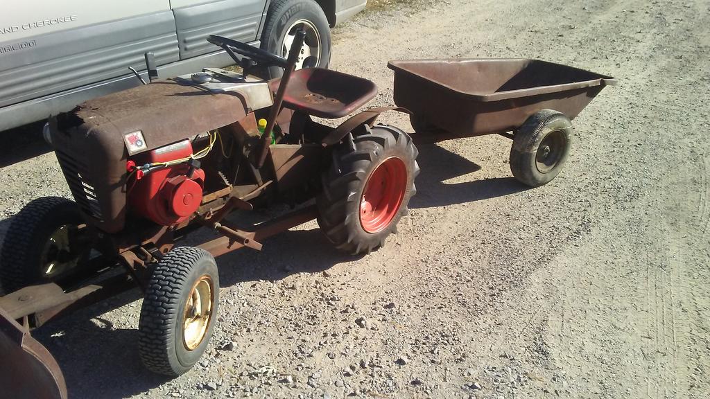

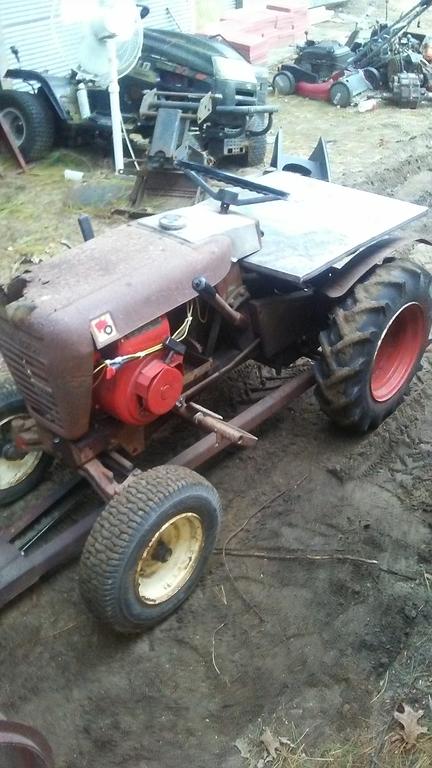

Elkskin's mower junkyard 1,117 #7 Posted October 24, 2018 Snowblower are a easy way to find the engines. Just measure cranks. Carboraters are easy to find on eBay. Here's my 552 with a 1967 h70 from a Toro walk behind 2 Share this post Link to post Share on other sites

Pullstart 68,887 #9 Posted October 24, 2018 49 minutes ago, craftsmanmowerfreak said: Snowblower are a easy way to find the engines. Just measure cranks. Carboraters are easy to find on eBay. Here's my 552 with a 1967 h70 from a Toro walk behind That’s a sweet hood.. 2 Share this post Link to post Share on other sites

Elkskin's mower junkyard 1,117 #11 Posted October 24, 2018 30 minutes ago, pullstart said: That’s a sweet hood.. Lol yea searching for anothet 1 1 Share this post Link to post Share on other sites
Pullstart 68,887 #12 Posted October 24, 2018 3 minutes ago, craftsmanmowerfreak said: Lol yea searching for anothet When you find one, I’ll give that one a home! 1 1 Share this post Link to post Share on other sites

formariz 12,354 #17 Posted October 25, 2018 On 10/24/2018 at 10:40 AM, craftsmanmowerfreak said: Lol yea searching for anothet I wouldn't change it. Lots of character. When you see something like that and still functioning after all these years you have to look at it with respect. 2 Share this post Link to post Share on other sites
