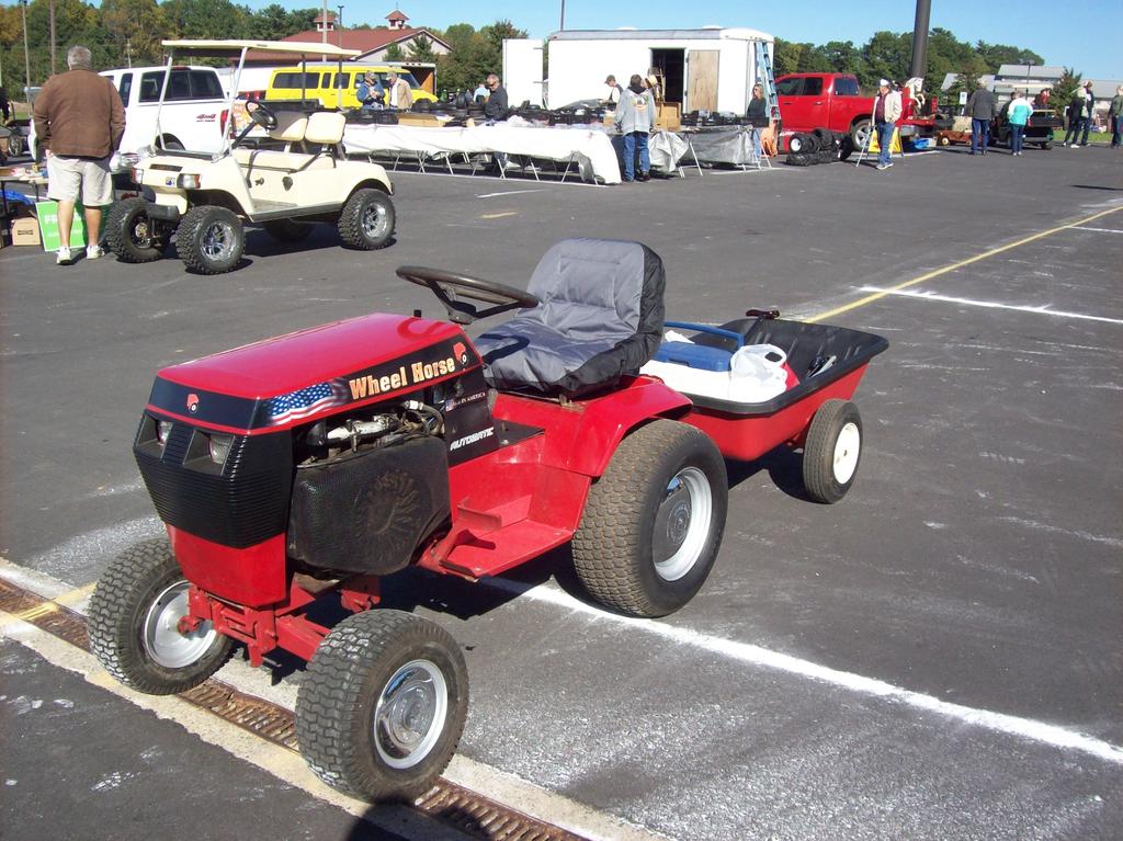

clueless 3,348 #1 Posted October 21, 2018 I'm thinking of replacing my decals on my 312 with Terry's carbon fiber ones. Looking for the best way to remove the old ones. 1 Share this post Link to post Share on other sites
