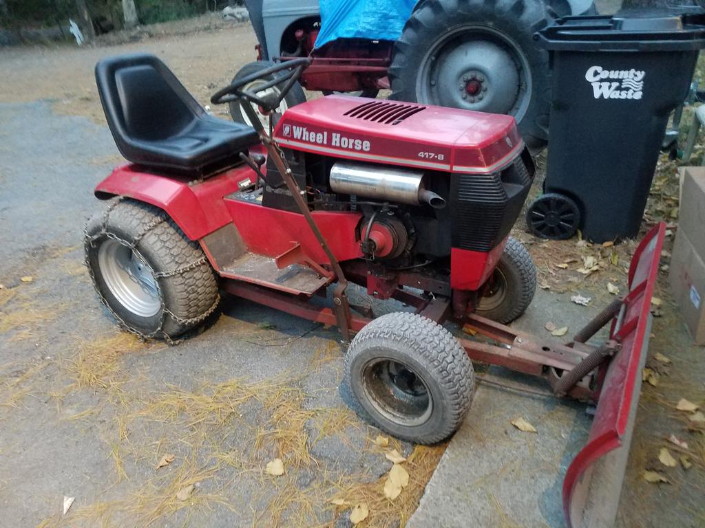

WildBlue 5 #10 Posted November 1, 2018 Picture attached; Many thanks for helping me get'er going... 1 1 Share this post Link to post Share on other sites
