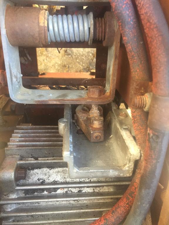

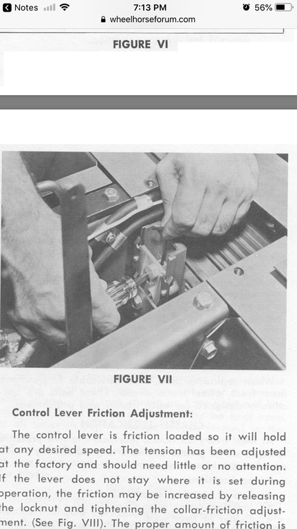

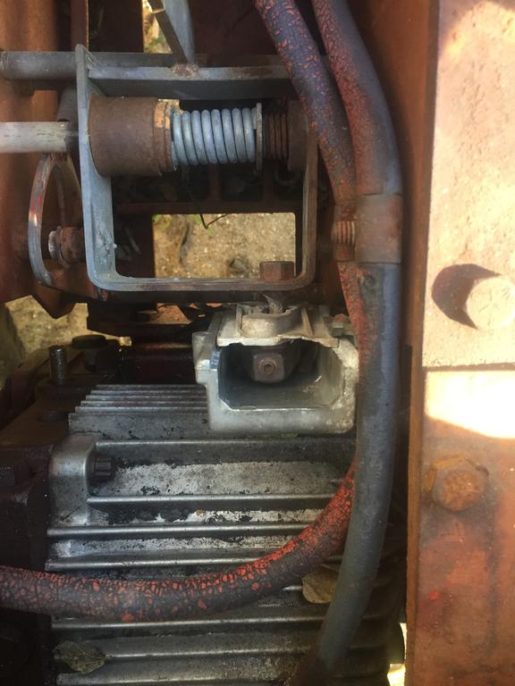

ZXT 2,402 #49 Posted October 29, 2018 The shifter on this thing is confusing me. Can anyone help me out? I've already ordered a new slide cam and i'm waiting on that, but I was looking and the ball stud hits the pivot lever when pushed to the "forward" position. Is the pivot ball supposed to go in the hole that's in the middle of the "slide" part of the cam, or in the one off to the side? Knowing that this unit is from a C-160 makes me wonder if there were differences in the shifter placement. Thanks! 1 Share this post Link to post Share on other sites
19richie66 17,937 #50 Posted October 29, 2018 (edited) I believe it goes in the side and the pivot lever button rides in the groove. Sounds like you are chipping away at it. Don’t give up brother. 👍 Edited October 29, 2018 by 19richie66 2 1 Share this post Link to post Share on other sites
