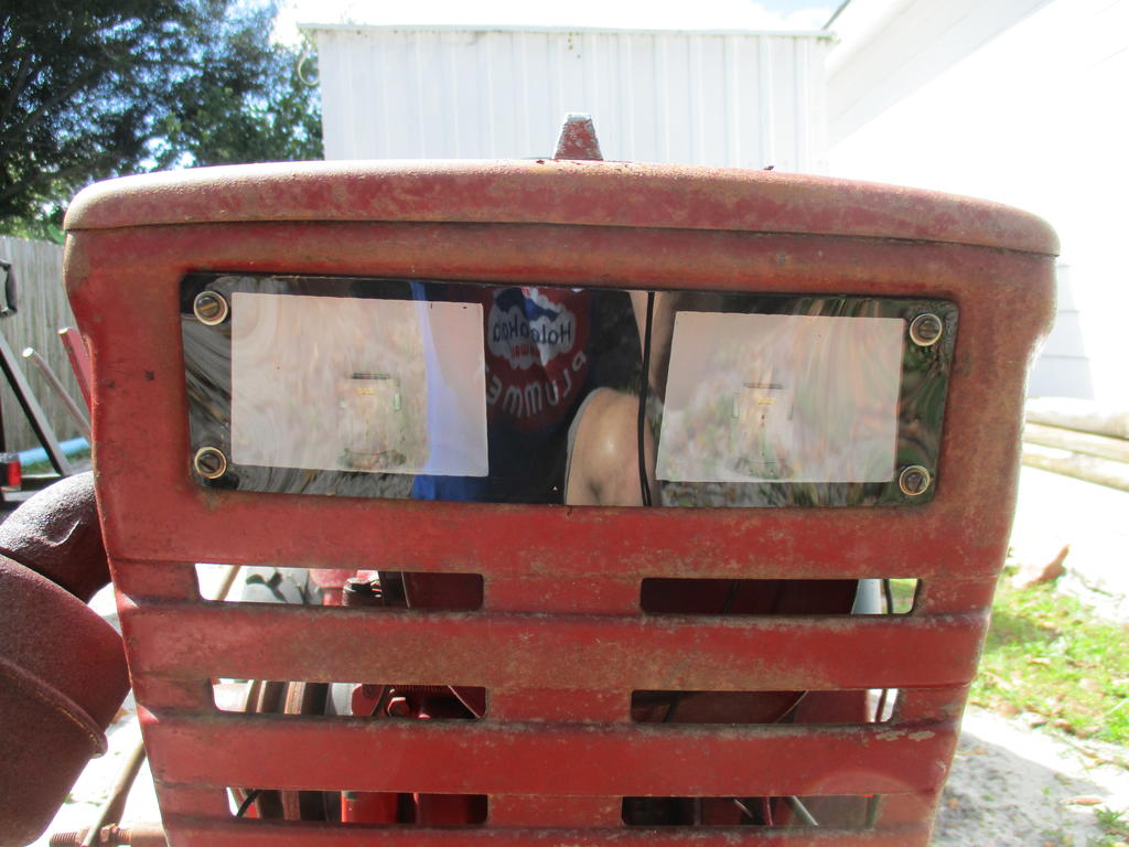

Kenneth R Cluley 659 #1 Posted October 18, 2018 Finally got around to updating lights. Cut some lexan for lens, since I seem to break everything else , masked and back painted outline, sandblasted and epoxied buckets and installed LED lamps. A real "bright" spot on otherwise Patina rich 69 Charger 12 tractor. Start Here.exe 6 Share this post Link to post Share on other sites
ebinmaine 77,126 #2 Posted October 18, 2018 What's the thickness on the lexan? Share this post Link to post Share on other sites
Kenneth R Cluley 659 #3 Posted October 18, 2018 .093 , but they call it 1/8th inch. Share this post Link to post Share on other sites

WHX?? 54,649 #6 Posted October 29, 2018 Make sure the bucket is well grounded. My led's flickered abit with just relying on the hood being grounded through the hinge pin. Ran a wire from the frame to the bucket and all is well. 1 Share this post Link to post Share on other sites
squonk 45,407 #7 Posted October 29, 2018 I tried bulbs like that. They looked great but did little through the stock WH lens. I had better luck with Zevo Super Bright LED bulbs. Share this post Link to post Share on other sites
Kenneth R Cluley 659 #8 Posted October 31, 2018 Had same issue with ground on hood. ended up running ground wire from hood to frame. This stopped the flickering. Share this post Link to post Share on other sites
