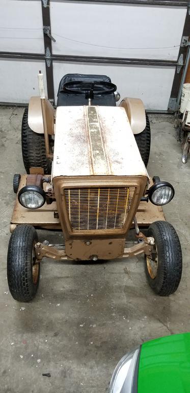

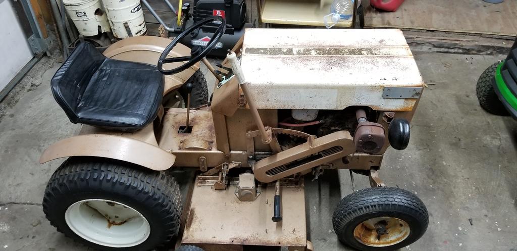

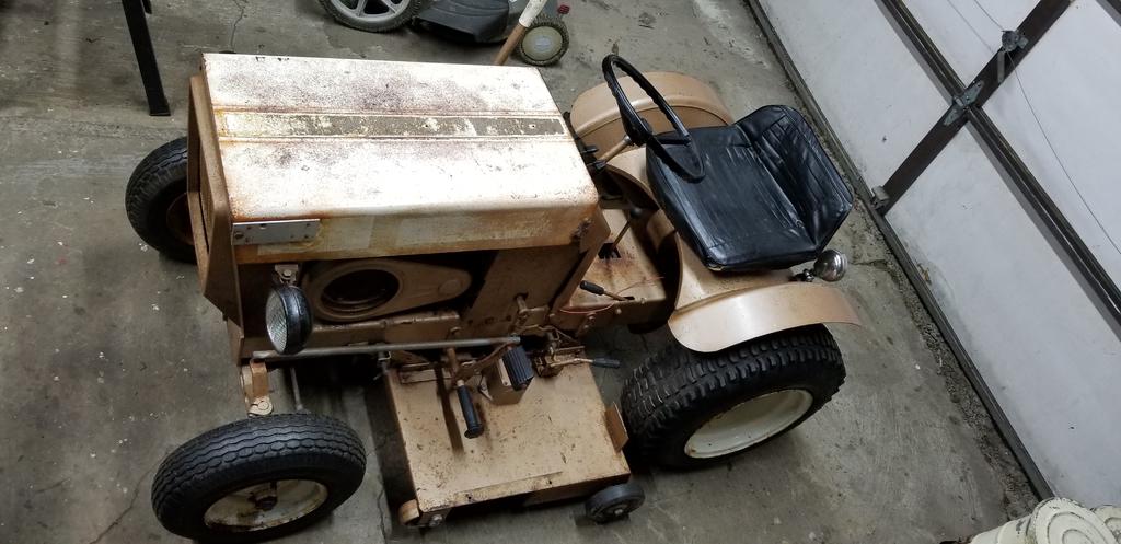

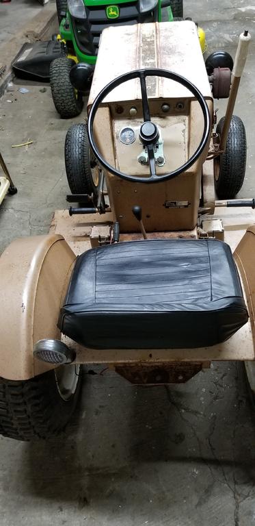

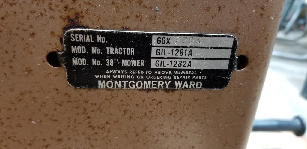

Mike'sHorseBarn 3,417 #1 Posted October 18, 2018 A monkey ward that is! This thing has the look and what a beast it is! It is in decent original shape, just all the decals are faded off. I know it's made by gilson and probably a 66 or 67 model. Anyone have a manual for it? Needs a good fuel system cleaning and some electrical work. Anyone else here have one like this? Don't find a whole lot about it on the old interweb. There is a manual on ebay, but i don't really want to pay $45 for a copy. Anyway, i'm looking forward the bringing this thing to life! And as the title states i did trade a horse for this. Am i crazy? lol 4 2 Share this post Link to post Share on other sites
oliver2-44 11,201 #2 Posted October 18, 2018 They are solid and cool looking. There's a later Wards/Gilson at a small mower repair/salvage shop in LaGrange, Tx near our farm. It's currently on the Austin Clist for sale for $125. it been there at least 10 years sitting out in the weather. I've looked at it several times but i see rust and water in too many places. ......O, there auta be a song..."Water in the Transmission" 3 Share this post Link to post Share on other sites
WHX?? 54,526 #3 Posted October 18, 2018 interesting piece, looks like a Kohler so shouldn't be too difficult to get running. Steering wheel looks like a large diameter two spoke common to our horses of the era. Front tires look to be RJ/Burb style. I like it! Try GTtalk for more info/manual on it Mike. Share this post Link to post Share on other sites
Mike'sHorseBarn 3,417 #4 Posted October 18, 2018 1 minute ago, WHX21 said: interesting piece, looks like a Kohler so shouldn't be too difficult to get running. Steering wheel looks like a large diameter two spoke common to our horses of the era. Front tires look to be RJ/Burb style. I like it! Try GTtalk for more info/manual on it Mike. Definitely the same steering wheel and cap as horses and similar front tires. They even say Montgomery ward on the side! Already posted in GTtalk Share this post Link to post Share on other sites
ebinmaine 77,077 #5 Posted October 18, 2018 Round fenders. Square Hood. Bug eyes. Short-back seat. I like it! Looking forward to seeing any work or tinkering you do on this one. I think you did a fair trade for a horse on that. 1 1 Share this post Link to post Share on other sites
