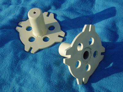

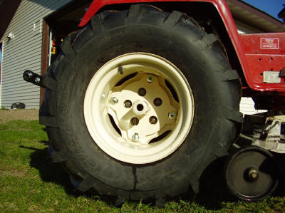

Tankman 3,528 #7 Posted October 14, 2018 (edited) Try Xtreme. The ends are tapped 1/2-13 for bolts to keep your weights on. "The plate bolts to your rim and puts the weight to the ground, not on your axle bearings. Holds your weights off of the rim so that you do not scratch them. Plate comes with a 1" or 2" shaft so weight lifting weights work great and are readily available. Must specify shaft size and shaft length on checkout." http://xtrememotorworks.com/Parts Catalog/Wheel-Weights-Cub-Cadet.html Edited October 14, 2018 by Tankman 3 Share this post Link to post Share on other sites

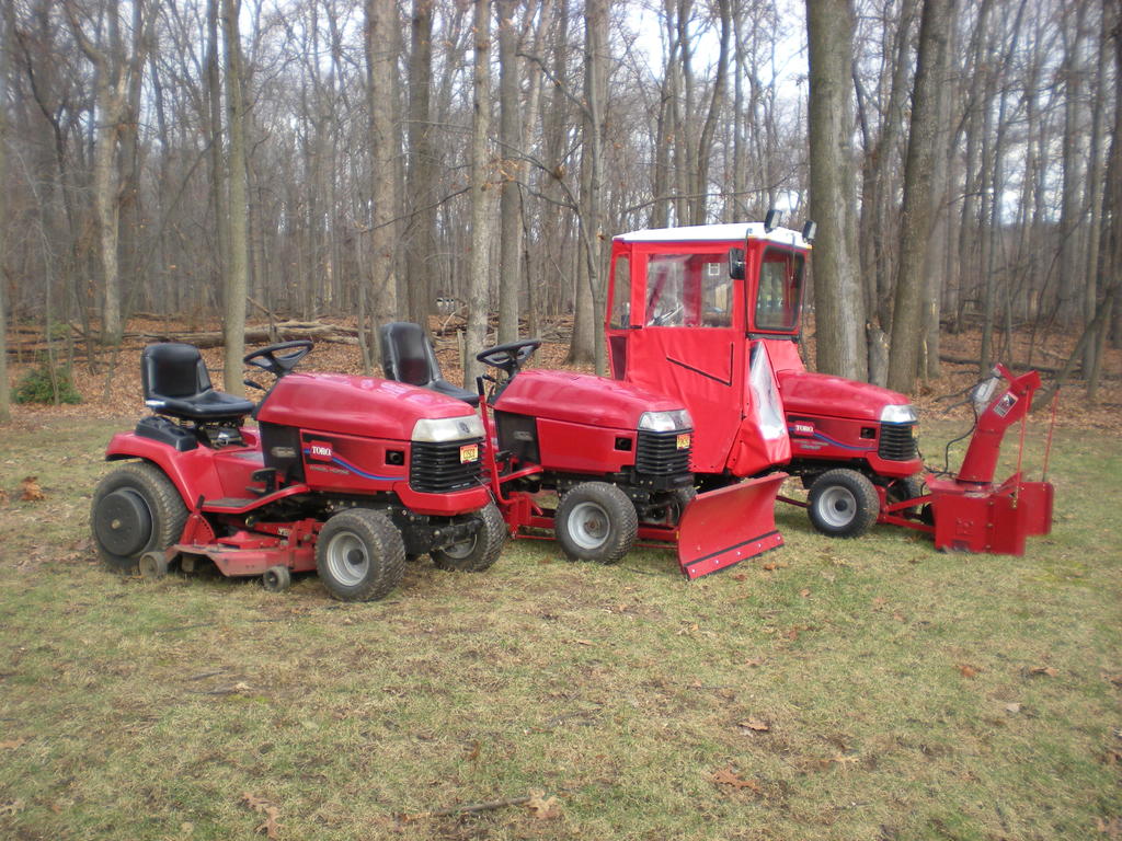

ri702bill 11,267 #9 Posted October 14, 2018 (edited) I made my own for the front of my 854 8 speed. There is a local guy that buys and resells gym equipment he sells the "broken set" weights for 50 cents a pound. I made a jig to drill and tap them for the 1/2 inch threaded rod - they can be tough to drill! Like EB, the tires are tubed and filled with windshield washer fluid. The large diameter also keeps the snow out of the rims. Also made a set for her C series sister..... Bill Edited October 14, 2018 by ri702bill added more pix 1 1 Share this post Link to post Share on other sites
Tankman 3,528 #10 Posted October 14, 2018 2 minutes ago, ri702bill said: I made my own for the front of my 854 8 speed. Bill Nice Horse Bill! Great picture except for the cold white junque! Great Stallion! 1 Share this post Link to post Share on other sites

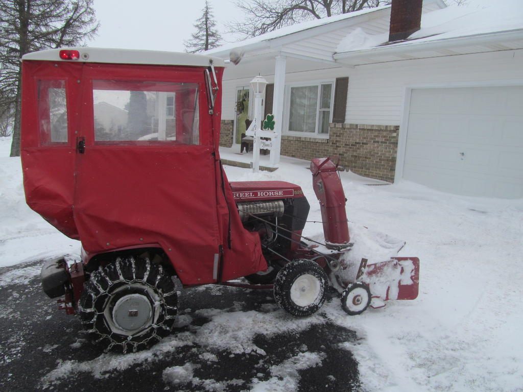

shallowwatersailor 3,220 #11 Posted October 14, 2018 Here is a photo of my former 5xi. I used dumbell weights on the 518xi which is closest to the camera. I bought the brackets from a vendor on eBay with a 1" shaft. The advantage was that I could start with smaller weights on the inside of the rim graduating to larger ones outside the wheel. To hold them in place, I used a 1" locking collar and ground a flat onto the shaft for the set screw. 1 Share this post Link to post Share on other sites

ri702bill 11,267 #13 Posted October 14, 2018 Tankman: Thanks for the comment, yes, she is a tough old girl! I picked her up for a right price locally from the previous owner of a now closed WH Dealership. It was a trade-in, sat outside too long and the rear was full of water- that's why the 8 speed. Not a hard to do swap - same axle as the C81. Bill Share this post Link to post Share on other sites
