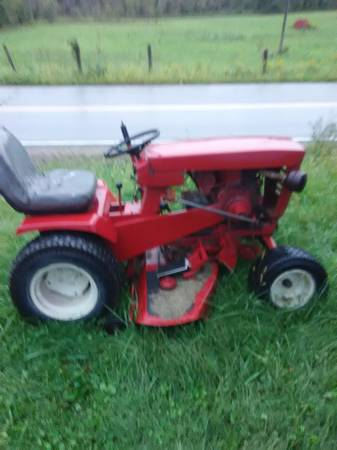

ohiofarmer 3,383 #10 Posted October 17, 2018 I bought this one today, advertised as runs well and mows well. Nope. The seller knew I was coming 130 miles to see it and then he gave me the 'bad" news that probably the coil was bad because of a weak spark. So I told him that I already spent a good deal of time coming to see it and maybe I would just cut my losses. He dropped the price to $150 and I figured it was worth it. The 12 horsepower engine advertised was a twin to the Raider Ten and it has the foot stirrups and a gearbox that is not hi-low select. Also a Two spoke wheel. Maybe you guys know what it is [he says 1967 model, but who knows? Maybe a 1057???..i am pretty tired tonight, but perhaps if I clean the points on my 12HP or trade out a known working coil and condenser, good things will happen. He also had a fresh barn find BSA motorcycle with a triple cylinder engine, said to be a 1948. My buddy Jay is a Nut for the old ones, so maybe we can take a trailer and pick up both... 1 Share this post Link to post Share on other sites
ebinmaine 77,072 #11 Posted October 17, 2018 5 minutes ago, ohiofarmer said: 150 and I figured it was worth it. You did perfectly fine with that. Parts alone are worth more than what you have in it. 1 Share this post Link to post Share on other sites
