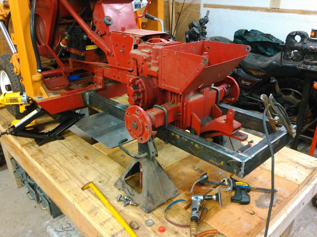

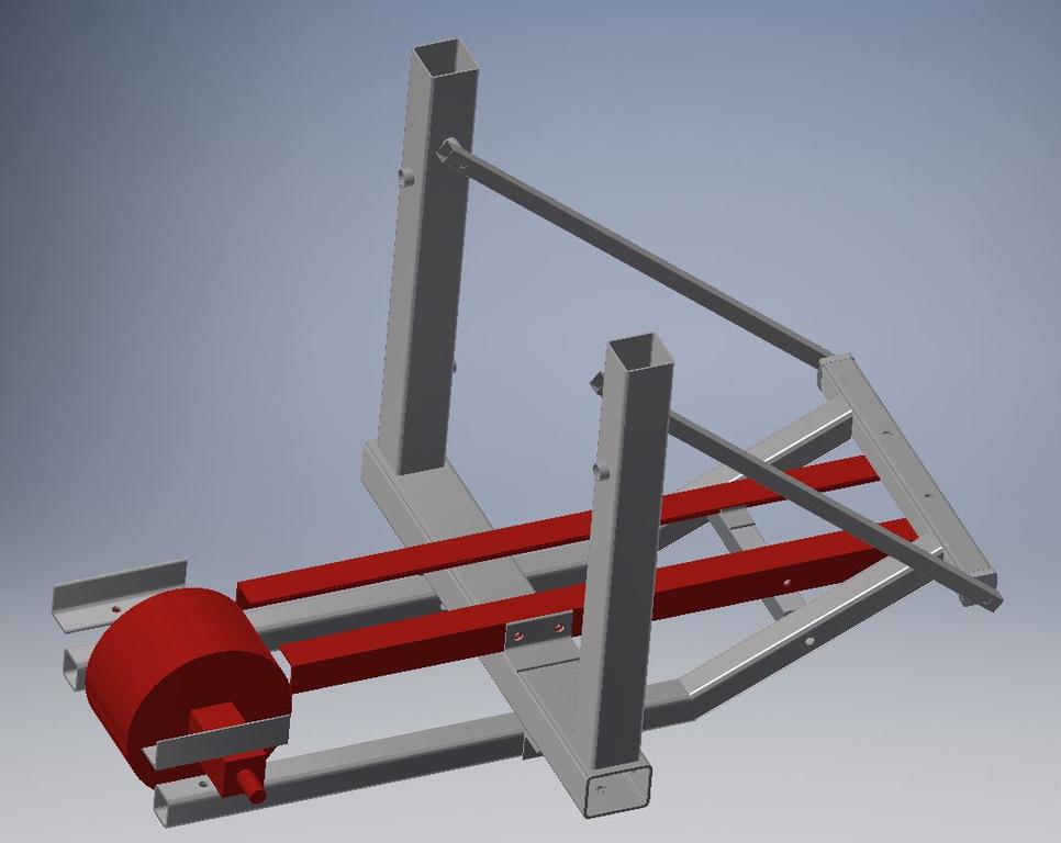

Walnut 37 #1 Posted October 12, 2018 (edited) And so it begins. Took some basic measurements last night and started laying the frame out on the computer this morning. Making it somewhat modular and completely bolt in. Haven't decided on the rear hitch design yet. 3 x 4 cross tube with 3 x 3 verticals. Those weld together and will be capped forming the oil tank. I'll position the valves on the left, pump on the right off the PTO, should get good oil cross flow that way, and I like having my right hand for steering and gear selection while my left operates the bucket. Lower frame will be 2 x 2 tube, 2 x 2 angle for mounting. Edited October 12, 2018 by Walnut 6 1 Share this post Link to post Share on other sites

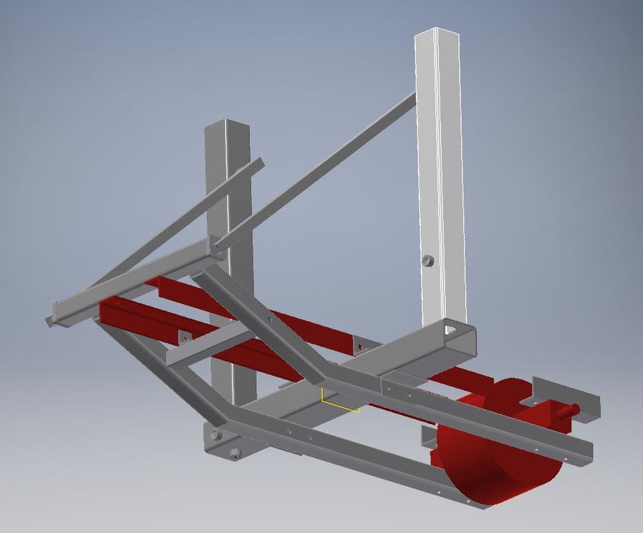

Walnut 37 #2 Posted October 12, 2018 Well that's all the damage I can do until I get some more measurements, but the basic design is there. 7 Share this post Link to post Share on other sites
chucksterock 15 #3 Posted October 12, 2018 I'm liking your design. What CAD software are you using? This is a near future project for me that isn't started yet. But I plan on starting by modeling it also before I cut steel. Only difference is I want to completely replace the original frame, but now you've got me thinking. Thank you for a different perspective, that always helps. Share this post Link to post Share on other sites

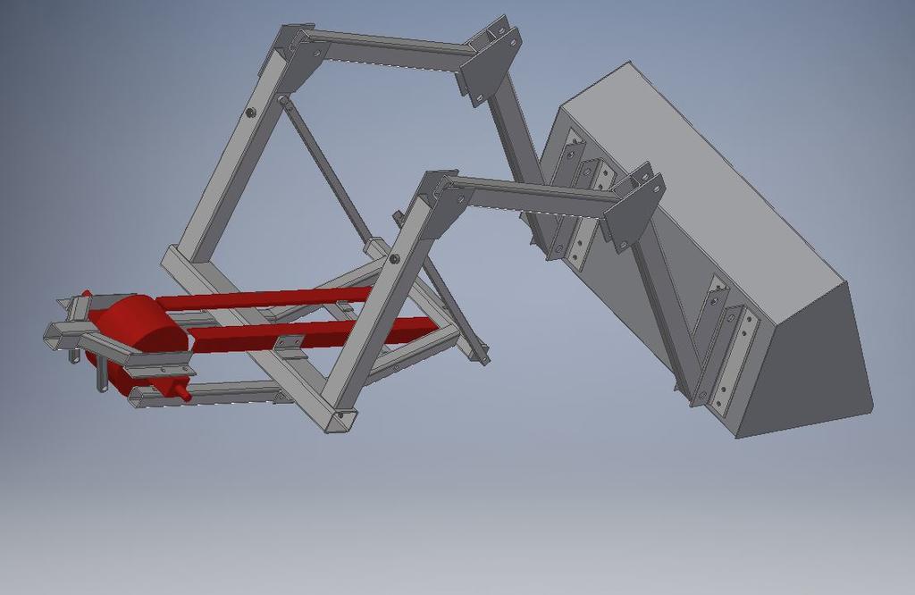

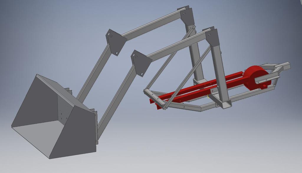

Walnut 37 #4 Posted October 12, 2018 AutoCAD Inventor. After looking at a ton of pictures I decided to make a full sub-frame to take most of the load off the tractor frame. I'll put some dimensions on the drawings, print everything out and check it against the tractor over the weekend. Might try and sketch the tractor enough to crude model it next week. It'll be a while before I start cutting but I've already started scrounging steel. I really need to figure out the cylinder dimensions and make sure I have room for the pump below the PTO first. I'd like to use 2" bore on the mains and 1.5's on the bucket rather than 2's on everything but using all 2's seems to be more common. Share this post Link to post Share on other sites

Skipper 1,790 #8 Posted October 12, 2018 (edited) I hear that 2x16 cylinders are what's suggested in the DIY plans. Remember to figure inn the speed of the cylinders, if you mix sizes. Oh and now that you are an Inventor user, I would love to see some stress analysis on your approach Edited October 13, 2018 by Skipper 1 Share this post Link to post Share on other sites

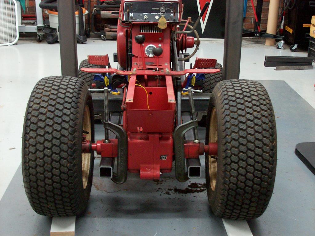

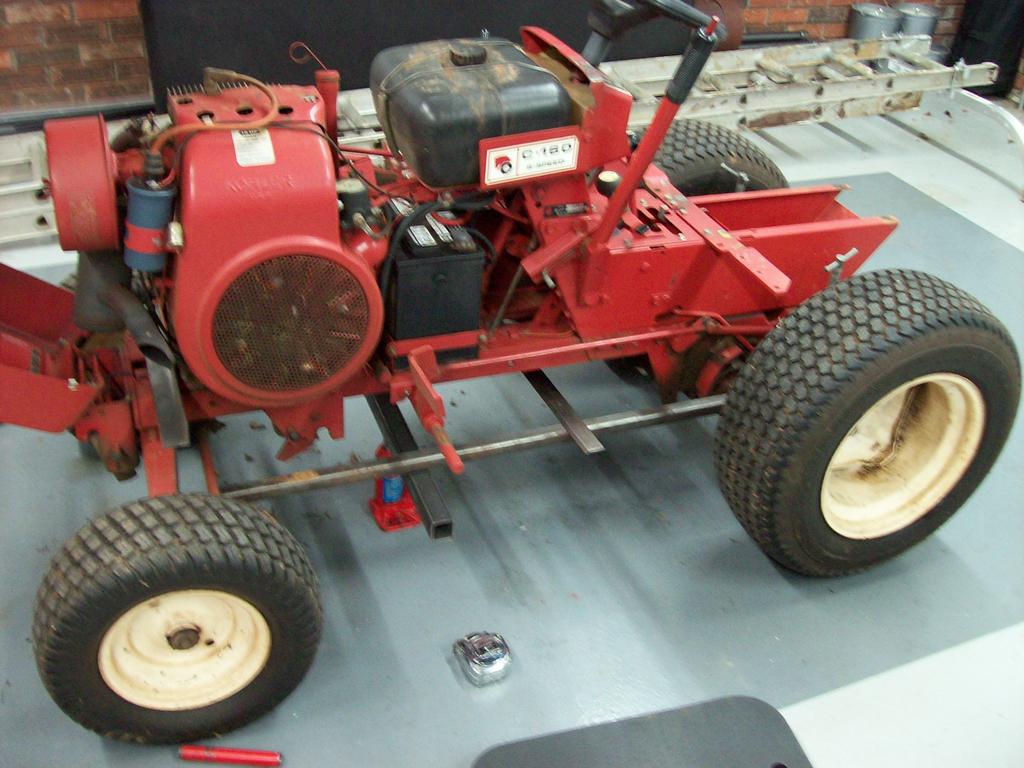

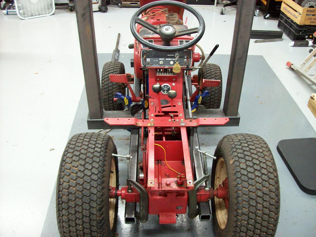

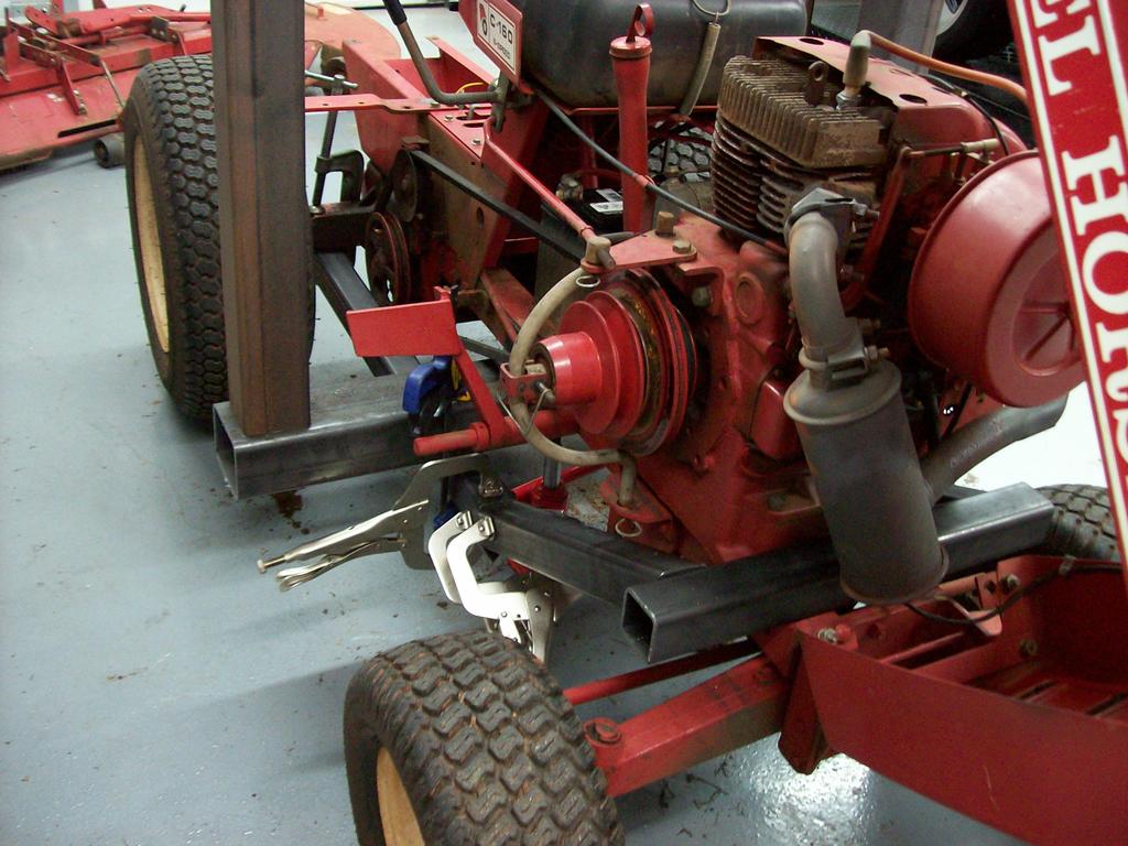

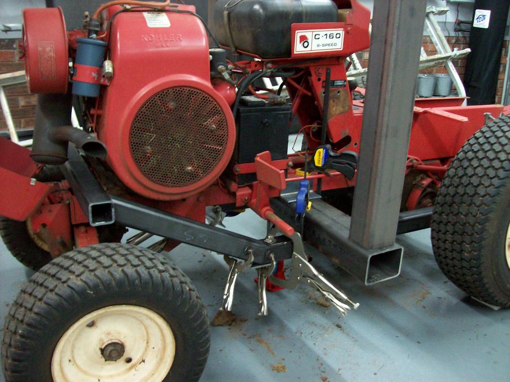

Walnut 37 #10 Posted October 17, 2018 Randy, nice loader. I'd like to see some pictures of your bucket cylinder since yours tilts from the bottom. Also what cylinder and line sizes you went with. I did some mock ups last night, got the usual issues to work through but the basic design didn't change. 3/16 x 2 x 2 frame, 3/16 x 3 x 4 cross and 1/8 x 3 x 3 verticals. It's what I was able to get for free so... 3 Share this post Link to post Share on other sites

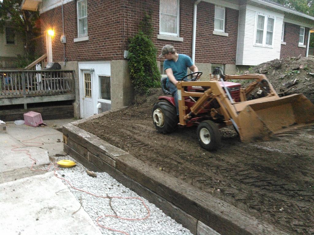

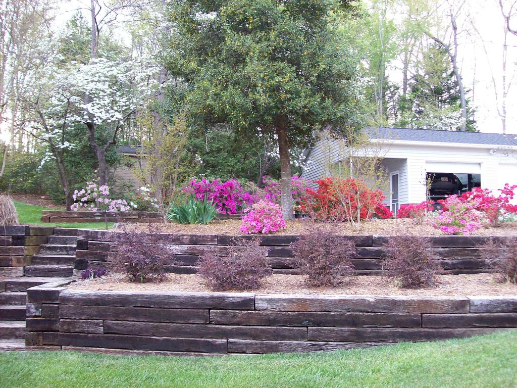

Walnut 37 #12 Posted October 18, 2018 (edited) On 10/12/2018 at 8:51 PM, RandyLittrell said: I have a johnson10 loader on a 1277 which is pretty close to a c-160 and would be happy to get any measurments you might want and any feedback if you were interested. I thought it was ironic you posted building and backfilling a tie wall. We've built our wall twice, by hand. They last about 15 years. Our wall goes on forever around our yard, about 300 ties worth. One reason we're doing the loader is a fork attachment would help a lot when the time comes to do it again, just back flling the dirt and mulching it would justify a loader. Edited October 18, 2018 by Walnut 1 1 Share this post Link to post Share on other sites
