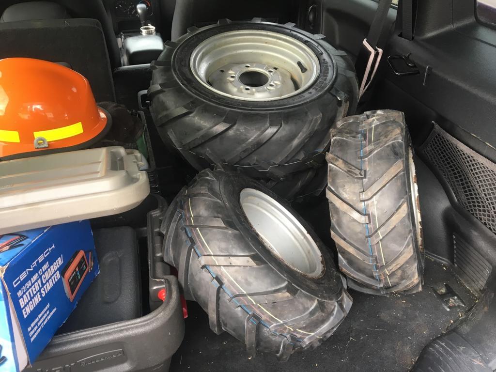

gsemeraro8 160 #1 Posted October 5, 2018 Finally Mounted...I think i need mental and physical therapy after mounting the fronts, with the tire machine at my shop the rears were a breeze, but the fronts? they better last 25 years 4 3 1 2 Share this post Link to post Share on other sites

gsemeraro8 160 #5 Posted October 6, 2018 1 hour ago, bcgold said: I use the first method to get a tire to bead. The beading was the easiest part, getting that 6ply ag tire on that little 8” rim was where i almost gave up completely 😂 Share this post Link to post Share on other sites

bc.gold 3,406 #8 Posted October 6, 2018 (edited) 9 minutes ago, gsemeraro8 said: The beading was the easiest part, getting that 6ply ag tire on that little 8” rim was where i almost gave up completely 😂 I have an old walk behind tiller that had rotted tires that I replaced with those small diameter stiff tires. I used two thin boards with a large C-clamp to keep one side of the tire clamped together this allowed me to work the opposite side over the rim using a pair of large screwdrivers as tire irons. The boards and clamp come into play after the first bead has been installed onto the rim. Take small bites and be sure to soap your tire bead, watered down dish soap. Edited October 6, 2018 by bcgold 1 Share this post Link to post Share on other sites
gsemeraro8 160 #9 Posted October 6, 2018 1 minute ago, bcgold said: I have an old walk behind tiller that had rotted tires that I replaced with those small diameter stiff tires. I used two thin boards with a large C-clamp to keep one side of the tire clamped together this allowed me to work the opposite side over the rim using a pair of large screwdrivers as tire irons. Take small bites and be sure to soap your tire bead, watered down dish soap. The c clamp with the boards is a good idea, i can see it saving alot of frustration 1 Share this post Link to post Share on other sites
bc.gold 3,406 #10 Posted October 6, 2018 (edited) 23 minutes ago, gsemeraro8 said: The c clamp with the boards is a good idea, i can see it saving alot of frustration Plenty of frustration and cursing before coming up with this idea the boards with the C-clamp saved the day.. Large screwdrivers work best anything thicker takes to much of a bite. Edited October 6, 2018 by bcgold 1 Share this post Link to post Share on other sites
gsemeraro8 160 #11 Posted October 6, 2018 (edited) 15 minutes ago, bcgold said: Plenty of frustration and cursing before coming up with this idea the boards with the C-clamp saved the day.. Large screwdrivers work best anything thicker takes to much of a bite. You should have seen the irons we were using, we use them to mount HD truck tires Edited October 6, 2018 by gsemeraro8 Share this post Link to post Share on other sites
bc.gold 3,406 #12 Posted October 6, 2018 2 minutes ago, gsemeraro8 said: You should have see the irons we were using, we use them to mount HD truck tires Not in my tool crib, I'm done with HD tires. One tire on my old Michigan loader had a leaking bead and someone used some kind of contact cement to seal the leak me and the tireman a Kal Tire beat on that thing half a day to get the bead separated from the rim. Getting the replacement on was easy. It's the small tires that will give ya grief. Share this post Link to post Share on other sites

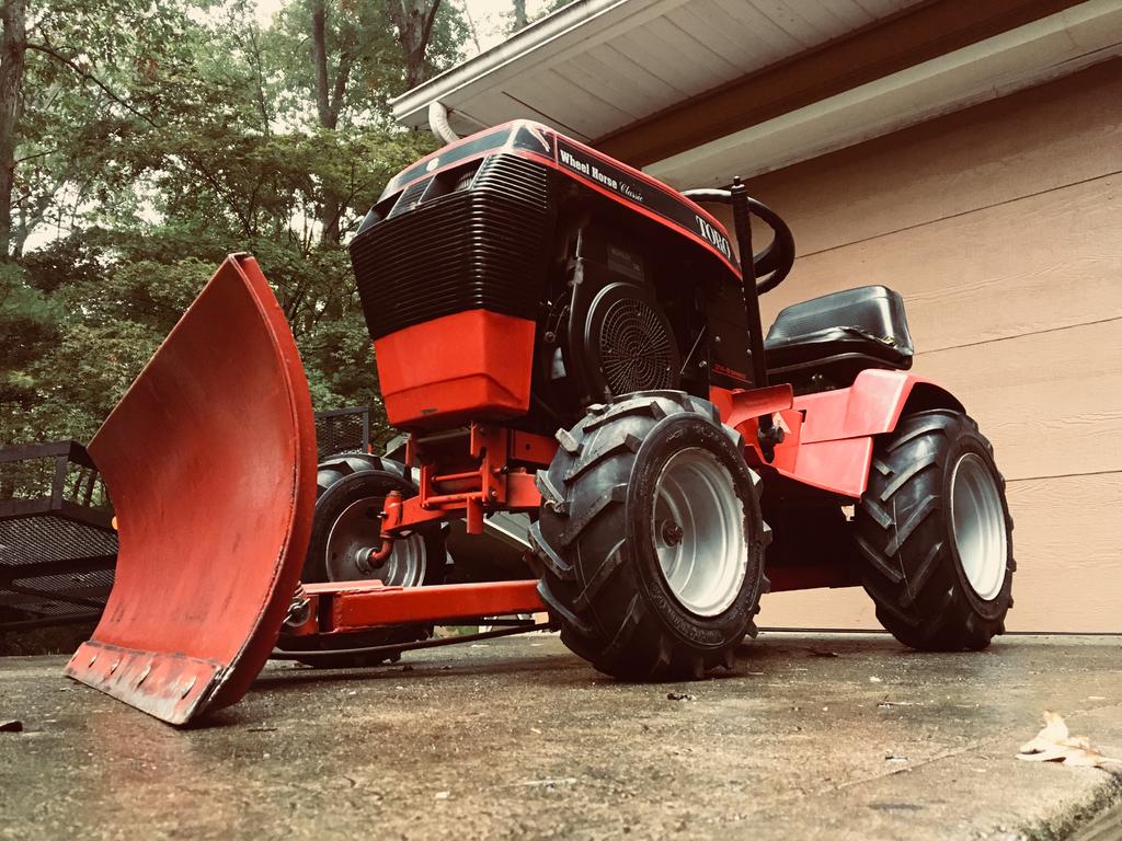

gsemeraro8 160 #14 Posted October 6, 2018 Finally done! 4 5 Share this post Link to post Share on other sites
CasualObserver 3,411 #16 Posted October 12, 2018 On 10/6/2018 at 7:16 AM, gsemeraro8 said: Finally done! Now that's a calendar worthy shot right there! #Calendar2019 1 Share this post Link to post Share on other sites
gsemeraro8 160 #17 Posted October 12, 2018 34 minutes ago, CasualObserver said: Now that's a calendar worthy shot right there! #Calendar2019 wait until i install the stack, should be here today Share this post Link to post Share on other sites
