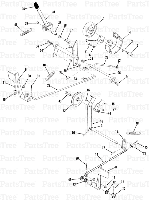

Skipper 1,790 #2 Posted October 4, 2018 (edited) AFAIK you need the 7473. Any 5/8" x 82" belt should work just fine. Why not just measure the old belt, and get one the same length, or closest match smaller. And those jumps in belt size there, those are big. No wonder it acts up from one to the other. You do not have an adjust on the clutch lever, so that you could loosen it up a bit? Edited October 4, 2018 by Skipper 1 Share this post Link to post Share on other sites

Skipper 1,790 #6 Posted October 4, 2018 (edited) Try the tight belt again, and adjust a little bit on part nr 22. If it ain't adjusted right, it may restrict the clutch idler from loosening fully up Edited October 4, 2018 by Skipper 2 Share this post Link to post Share on other sites

arrkerr 54 #8 Posted October 4, 2018 16 minutes ago, Skipper said: Try the tight belt again, and adjust a little bit on part nr 22. If it ain't adjusted right, it may restrict the clutch idler from loosening fully up Thanks, I should have checked that right away! I bet you're right! Thats what I get for working on it at 1am, brain wasn't fully engaged, but I wanted to get it out of the garage - my wife doesn't fully support my collection so I try to keep them hidden in the barn, but the tools are in the garage 1 2 Share this post Link to post Share on other sites

gwest_ca-(File Mod) 12,005 #10 Posted October 5, 2018 Item 22 only changes the pedal position for operator comfort. Garry Share this post Link to post Share on other sites
