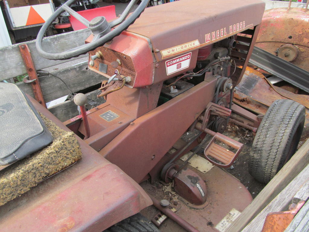

Artmilaca 23 #1 Posted October 4, 2018 (edited) I just picked up a 520h that has various little problems. It has a an Onan P220 #1 on the list is that the throttle control will not stay in place. If you set it at a higher speed it will fall right back to cut off. Before I tear into this I was wondering if anybody might have a clue as to the problem. Edited October 4, 2018 by Artmilaca Additional Share this post Link to post Share on other sites

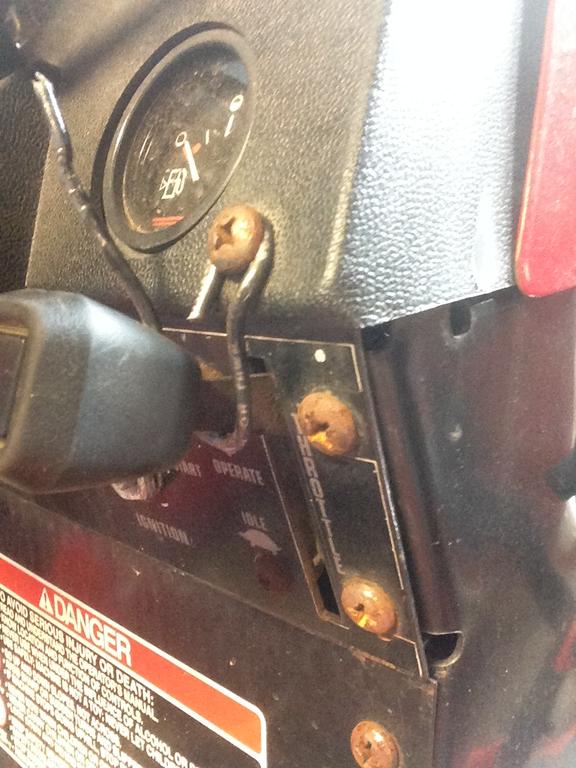

formariz 12,354 #8 Posted October 5, 2018 Have the same issue on my 520. It will come down from full throttle to about half.Same happens with my Electro. In the spirit of making things easy specially with something which will occur again in the future due to wear, this is my solution on the 520. Share this post Link to post Share on other sites

Artmilaca 23 #10 Posted October 6, 2018 19 hours ago, formariz said: Have the same issue on my 520. It will come down from full throttle to about half.Same happens with my Electro. In the spirit of making things easy specially with something which will occur again in the future due to wear, this is my solution on the 520. Yep, already using that wire trick Share this post Link to post Share on other sites
