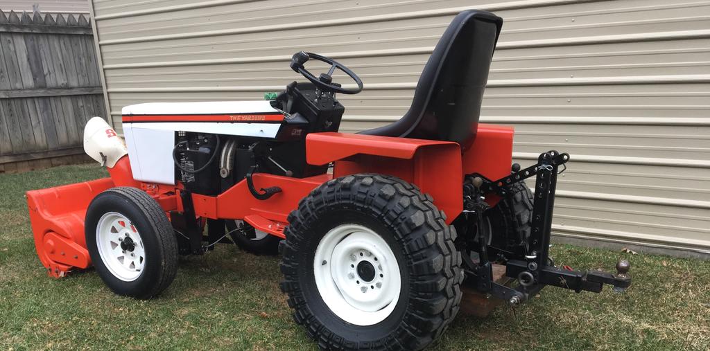

Machineguy 877 #9 Posted October 4, 2018 2 hours ago, bcgold said: My AC 720 has those on it, I'm not particularly fond of them I think the offset puts a bit to much strain on the axle bearings and the wheel studs. Which is evident on one of the rims which has the holes wobbled out of round. Any 15" rim would make for a good donor for the beaded edges you could roll your own metal to the correct width then use your centers again. I actually drilled Chevy K10 wheels for the rears and I’m using 32x11.50 super Swampers with washer fluid in them. I already had these laying around from an old truck of mine and it’s been a low buck solution that’s served me well! I agree that the original wheels do have an extraordinarily wide positive offset. Might be helpful to stabilize the machine with a front end loader but for regular usage I like the narrower track width myself too! 2 Share this post Link to post Share on other sites
