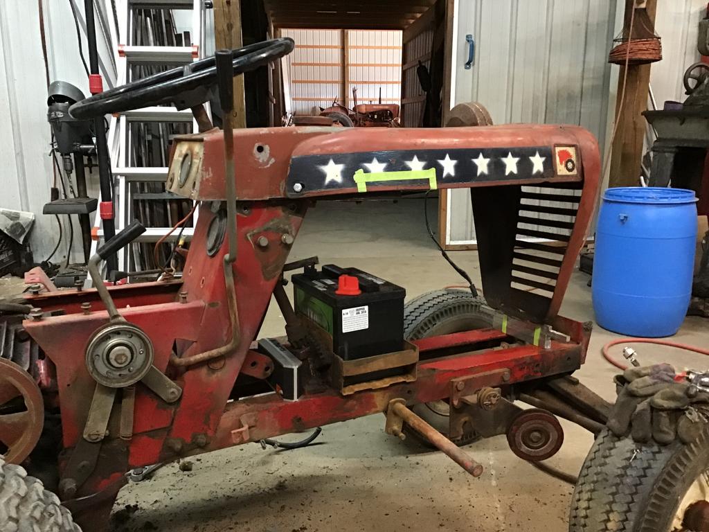

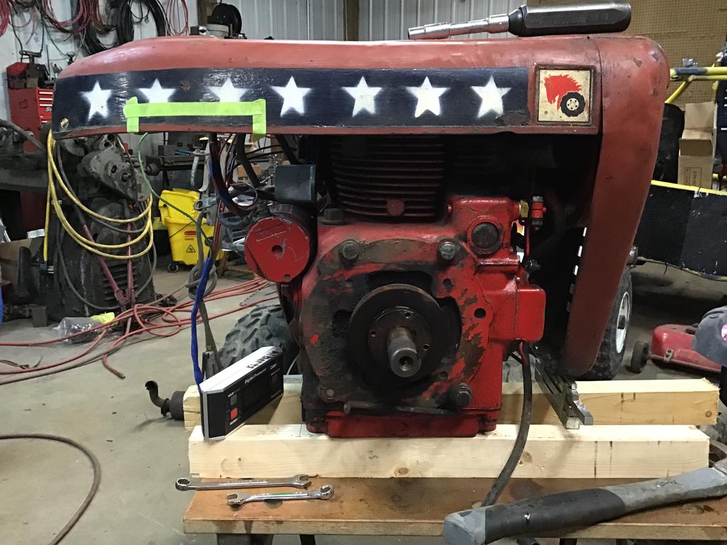

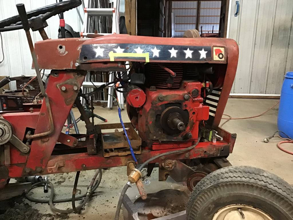

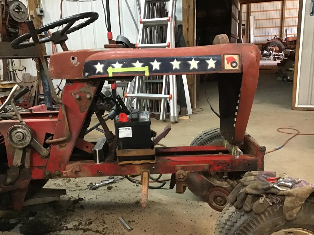

Pullstart 71,101 #80 Posted October 23, 2018 I think length is not my issue, but height still by just a tickle. Referencing the frame as level, I made a block to space the hood mount up. I had to raise the hood by 1/4” to level it out. I might be able to massage the hood stand to raise the rear a bit. 4 Share this post Link to post Share on other sites
Pullstart 71,101 #81 Posted October 23, 2018 FYI, the green tape is NOT a cut line, it’s to reference the current battery location. 2 Share this post Link to post Share on other sites

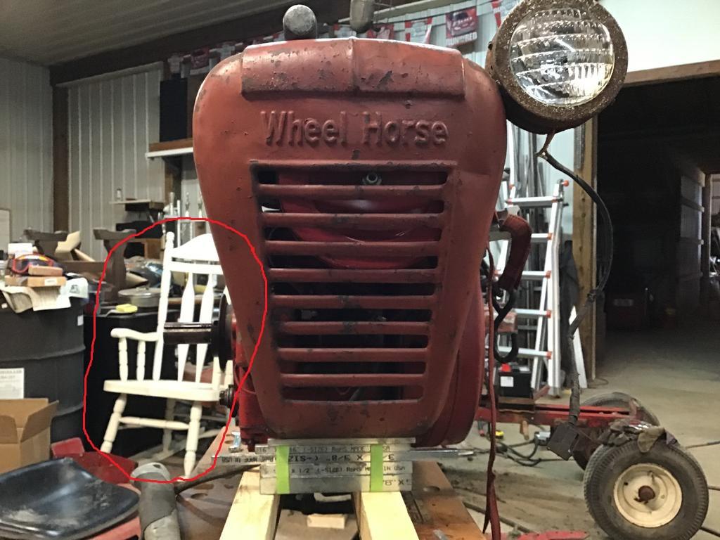

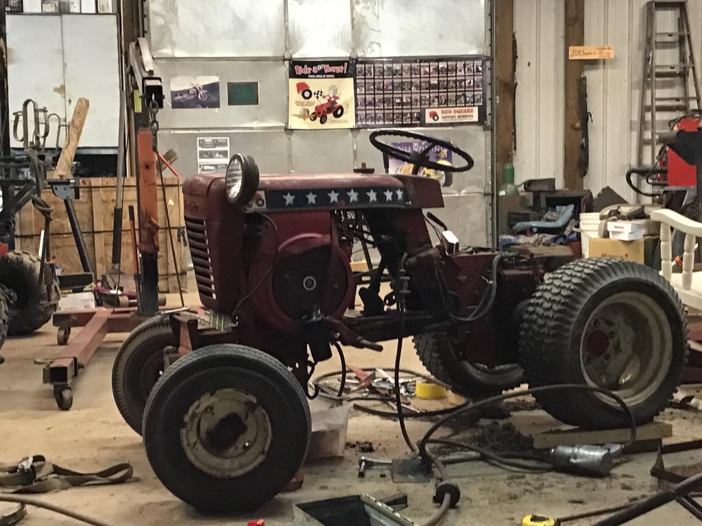

Pullstart 71,101 #83 Posted October 23, 2018 That’s a thinkin’ chair. Can’t recall the last time I used it! no turning back, no turning back... I think this notch notch will be enough to stick a big block in there! 3 Share this post Link to post Share on other sites

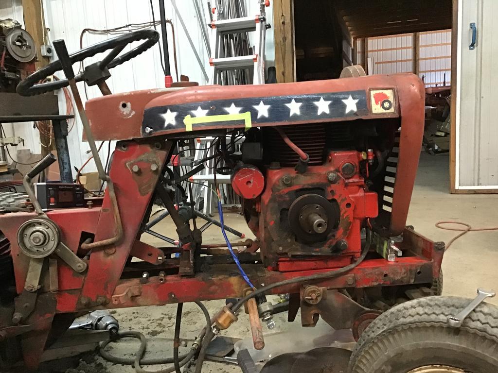

Pullstart 71,101 #86 Posted October 23, 2018 So close, yet so far away. The flywheel cover interferes with the battery box. So thanks to some clowns, I’ve gotta build a battery box up front I guess! 3 Share this post Link to post Share on other sites

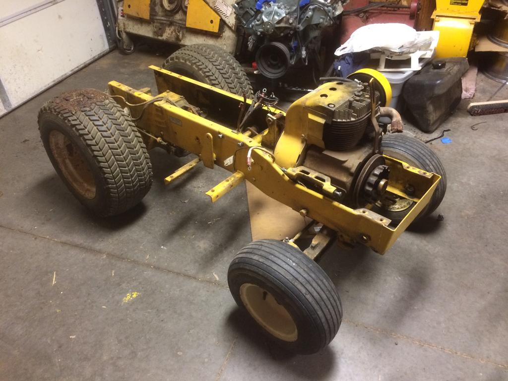

Pullstart 71,101 #87 Posted October 23, 2018 1 minute ago, 82Caddy said: What oil pan did you decide to go with? Guessing one like this: Still the stocker from the C-101 👍 I’m just trying to prove ya wrong 2 Share this post Link to post Share on other sites

Pullstart 71,101 #92 Posted October 23, 2018 This C has a shaker plate that I removed. The Charger 12 block had the super tall base. 1 Share this post Link to post Share on other sites
82Caddy 851 #93 Posted October 23, 2018 3 minutes ago, pullstart said: This C has a shaker plate that I removed. The Charger 12 block had the super tall base. I forgot all about the shaker plates engines. 1 Share this post Link to post Share on other sites

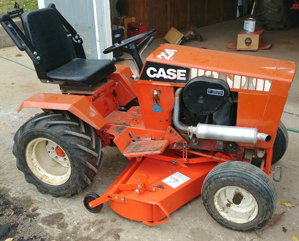

Achto 32,347 #94 Posted October 23, 2018 (edited) 4 hours ago, pullstart said: Now, how to mix red and orange, This is real simple, just dump the two together. When Case did this they called it "Power Red"... not sure where they came up with that name, darn things look orange to me. Edited October 23, 2018 by Achto 1 2 Share this post Link to post Share on other sites

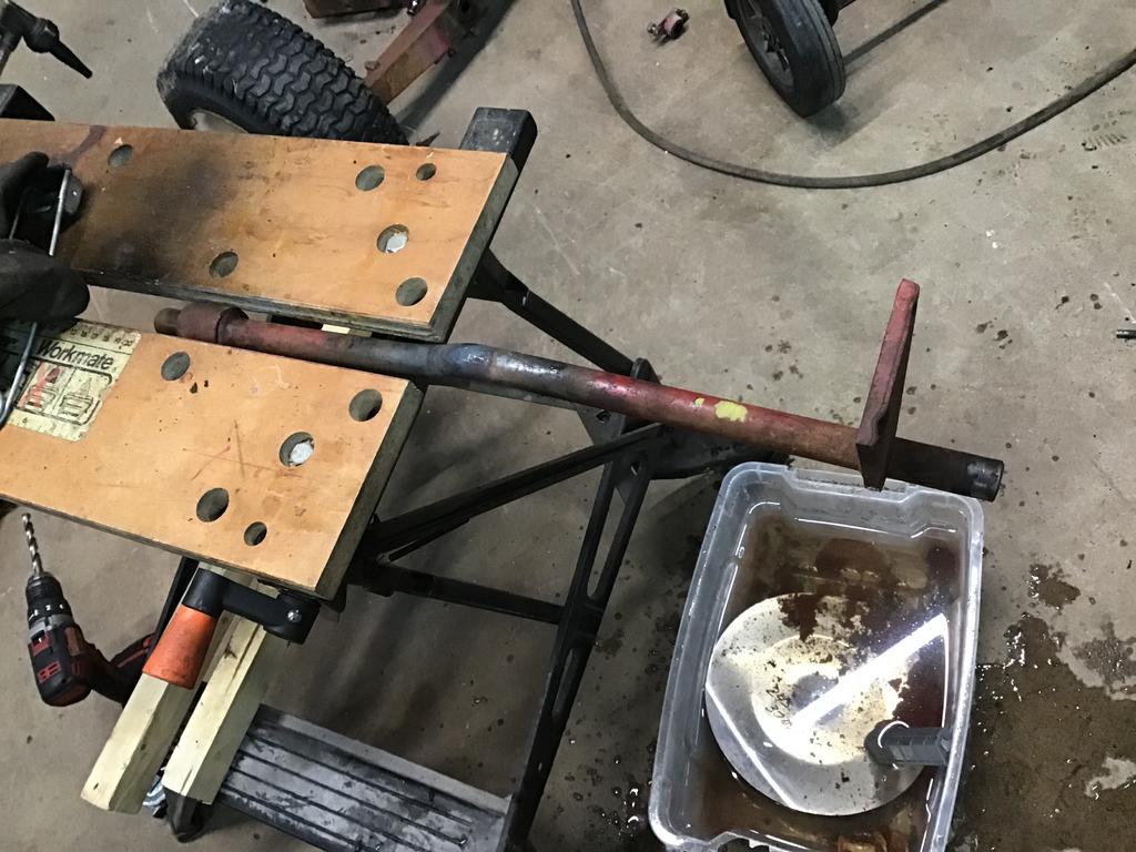

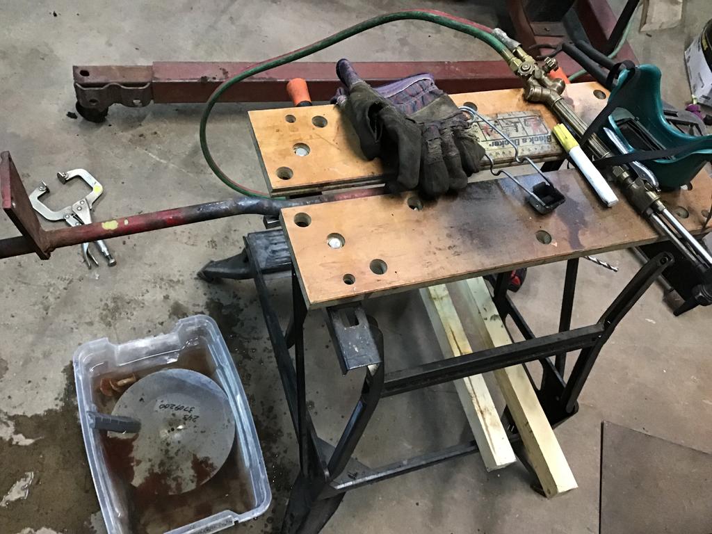

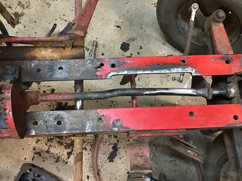

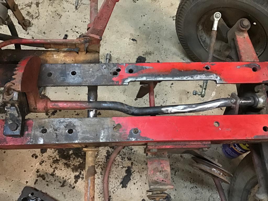

Pullstart 71,101 #99 Posted October 24, 2018 So the steering shaft feels like getting in the way of the oil pan. My torch begs to differ. 1 Share this post Link to post Share on other sites

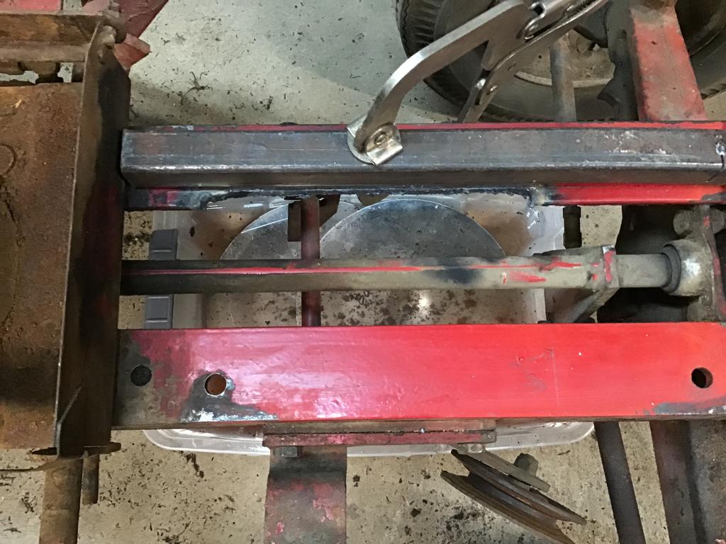

Pullstart 71,101 #100 Posted October 24, 2018 I smeared dirty grease on the bottom of a parts oil pan to spot in the upgraded shaft. All clears! I need to replace the pillow block and when I do, I’ll space it out to make up for the length I lost in the bends and all will be well. And after it is together and I tear it apart, I’ll plug up some of those “extra”holes in the frame. 3 Share this post Link to post Share on other sites
