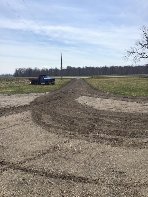

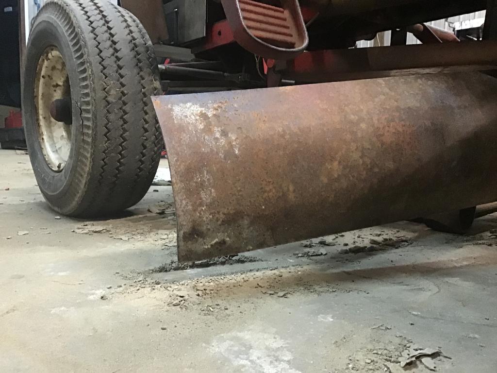

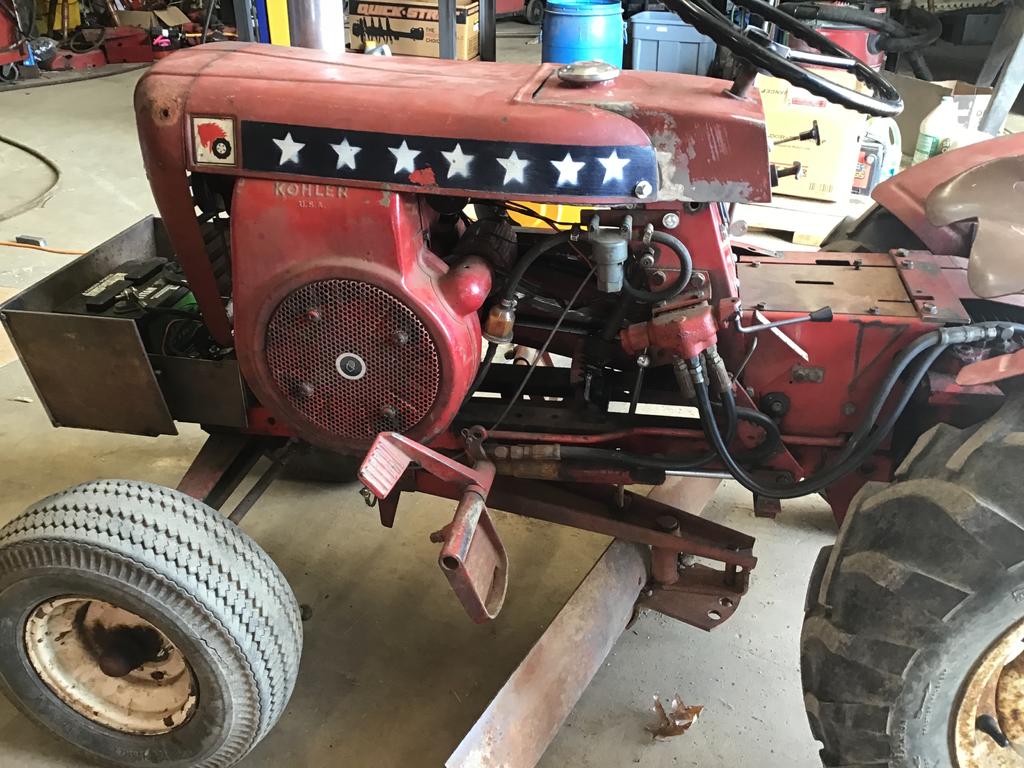

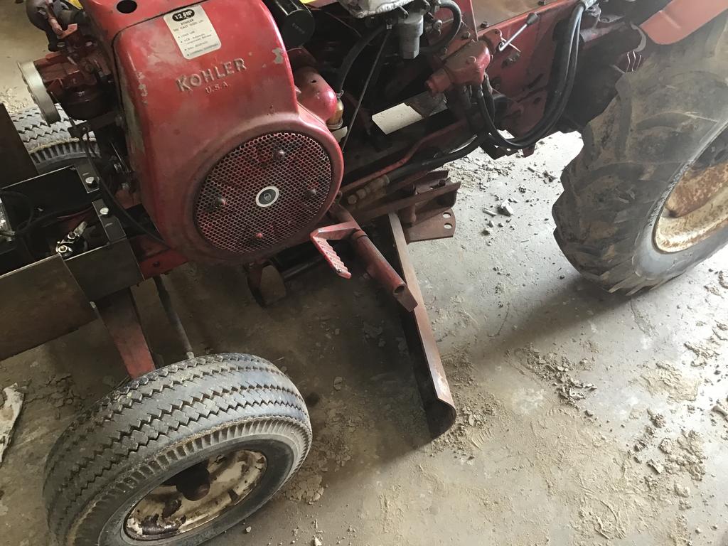

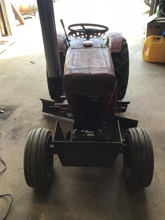

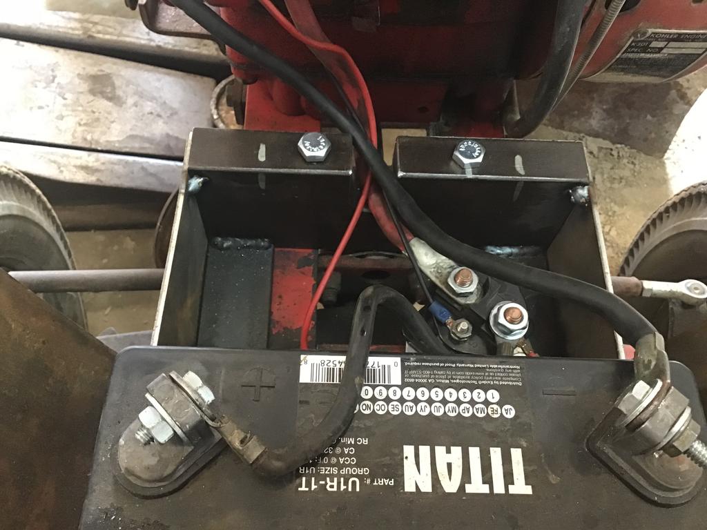

Pullstart 71,368 #504 Posted March 29, 2019 The hood mount is finished with modifications and the hanging weight battery box is tacked back together. It was a little off of plumb square, so it needed some rework anyways. I started to build a solid lift link for the mid mount grader blade as well, but not after I took my own stroll around the field and yard yesterday. 6 1 Share this post Link to post Share on other sites

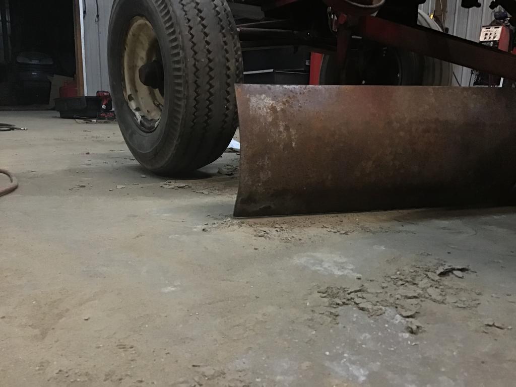

Pullstart 71,368 #505 Posted March 30, 2019 Mid mount solid link works! 4 Share this post Link to post Share on other sites

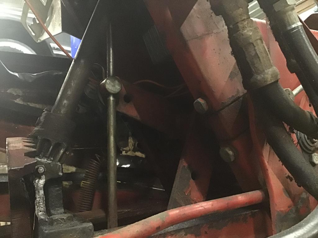

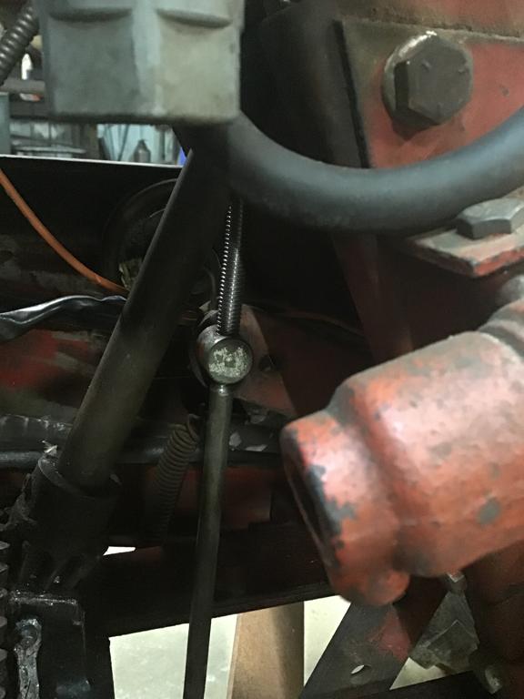

Pullstart 71,368 #506 Posted March 30, 2019 I shortened the PTO rod from a C-101 and re-threaded it. 1 2 Share this post Link to post Share on other sites

ebinmaine 80,961 #509 Posted March 30, 2019 7 hours ago, pullstart said: shortened the PTO rod from a C-101 and re-threaded it. Neat idea there 1 Share this post Link to post Share on other sites

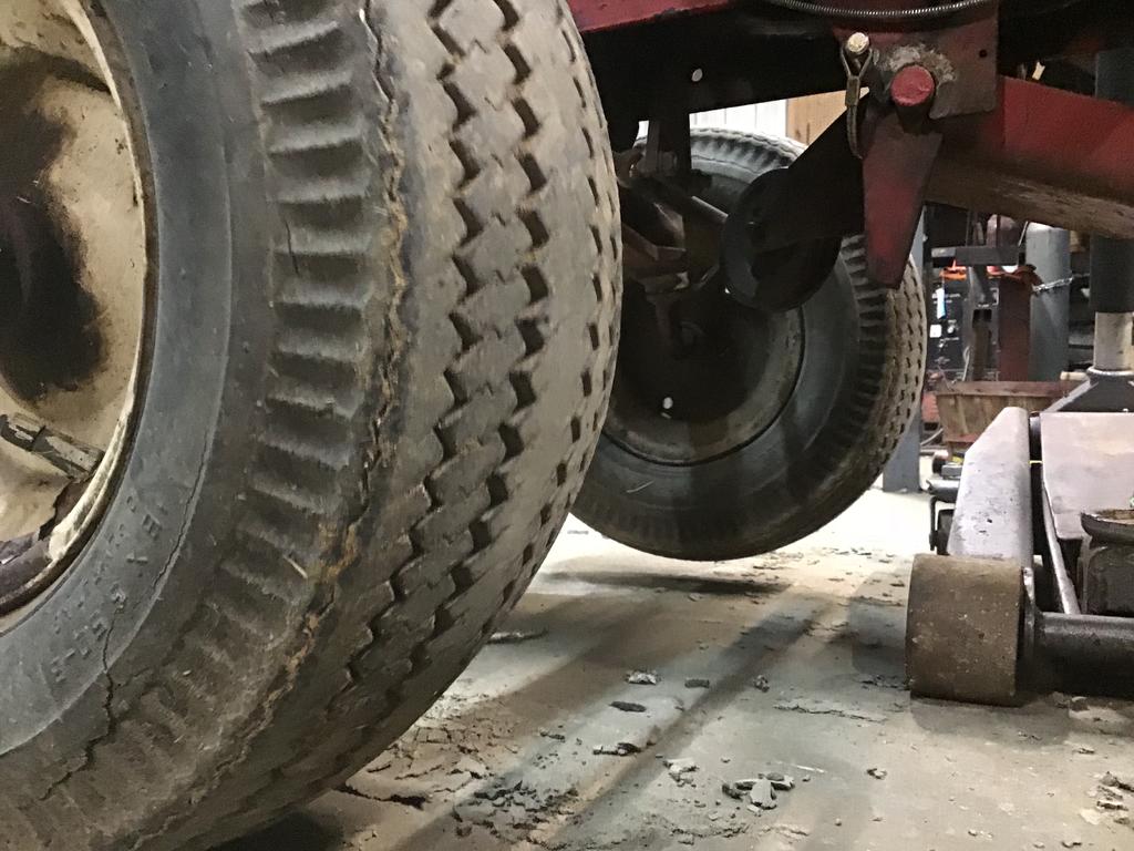

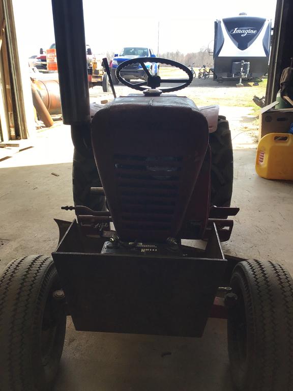

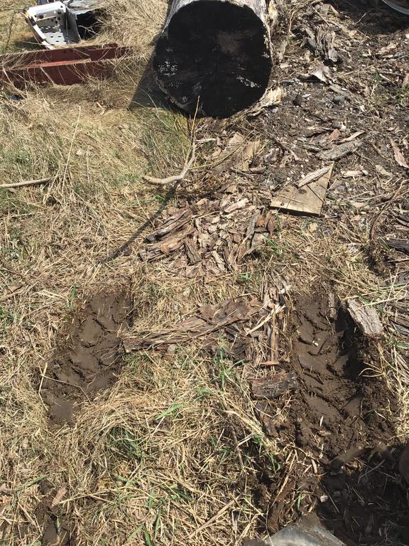

Pullstart 71,368 #514 Posted April 8, 2019 I spent some time working Frank in the driveway to warm up the transmission, then finally did the load test. All is well, the big wheels spun at full throttle or the engine would stall at anything less than full throttle. 4 1 Share this post Link to post Share on other sites

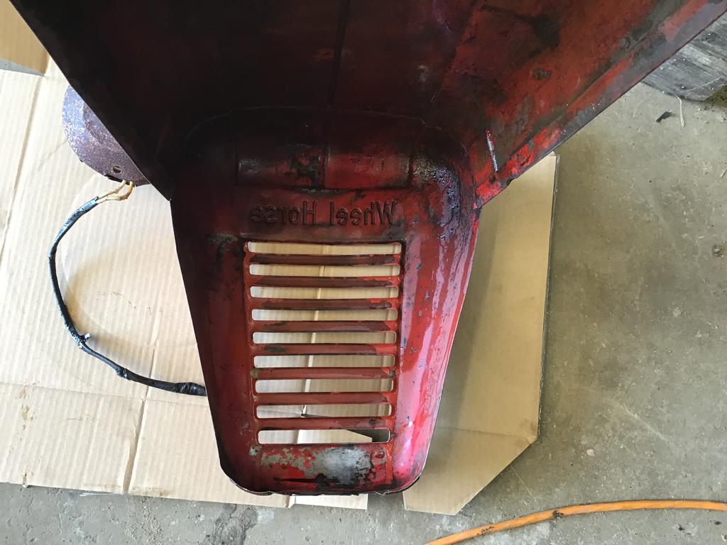

Pullstart 71,368 #515 Posted April 8, 2019 Enough messing around, it’s time to work on the hood and mounting it. Share this post Link to post Share on other sites

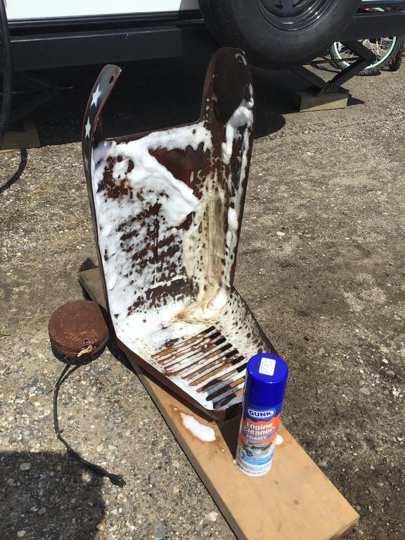

ebinmaine 80,961 #516 Posted April 8, 2019 Are you using that as a Degreaser or a paint remover? Share this post Link to post Share on other sites
Pullstart 71,368 #517 Posted April 8, 2019 Either or... 2 Share this post Link to post Share on other sites

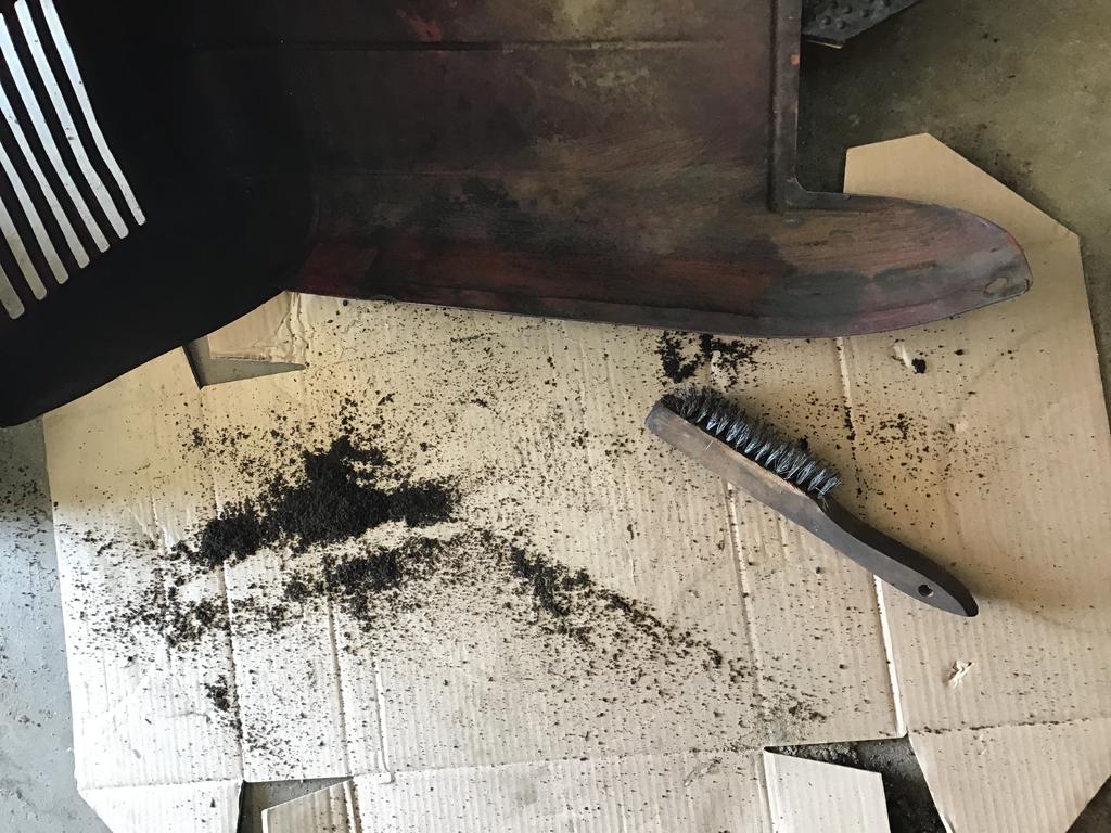

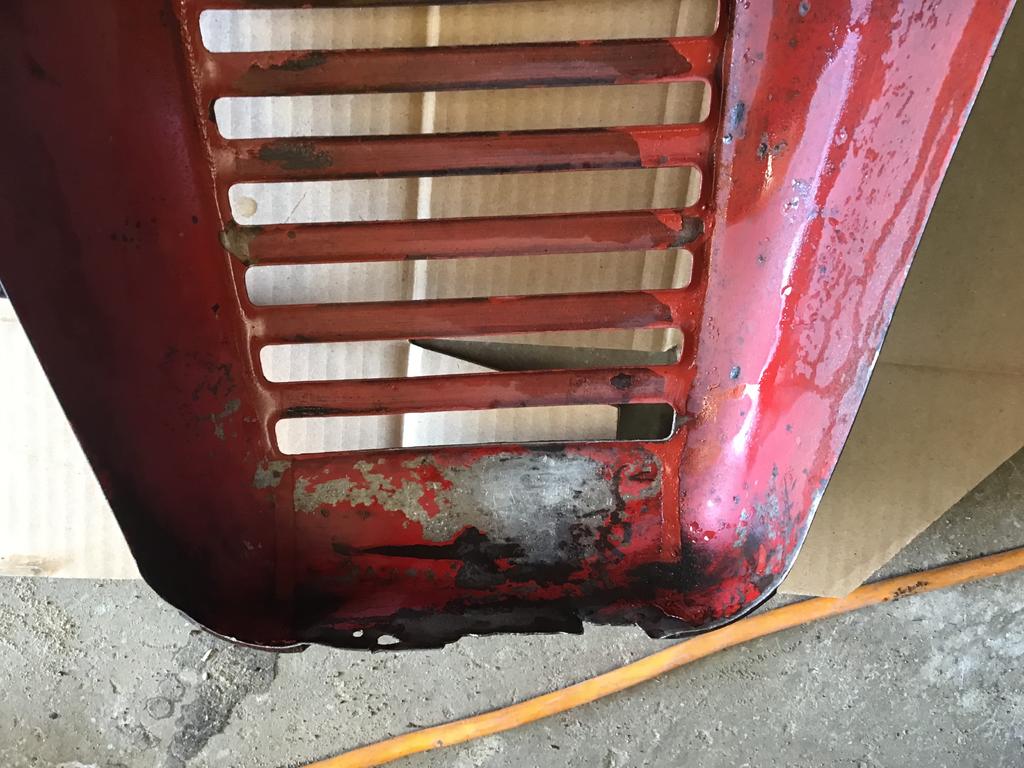

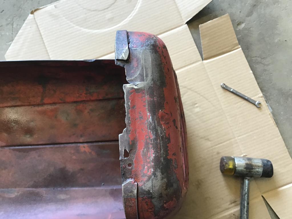

Pullstart 71,368 #518 Posted April 8, 2019 It cleaned the majority of the 56 years of grime off it, along with an old sanding sponge. I will soon need to remove Frank’s one good eye, but only for a little while. 3 Share this post Link to post Share on other sites
ebinmaine 80,961 #519 Posted April 8, 2019 Boy does that look better... Share this post Link to post Share on other sites

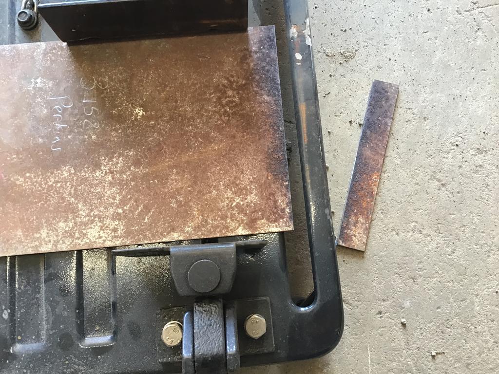

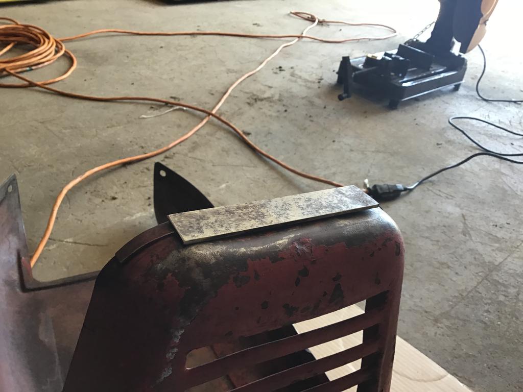

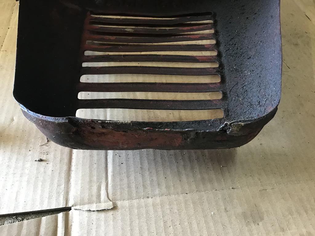

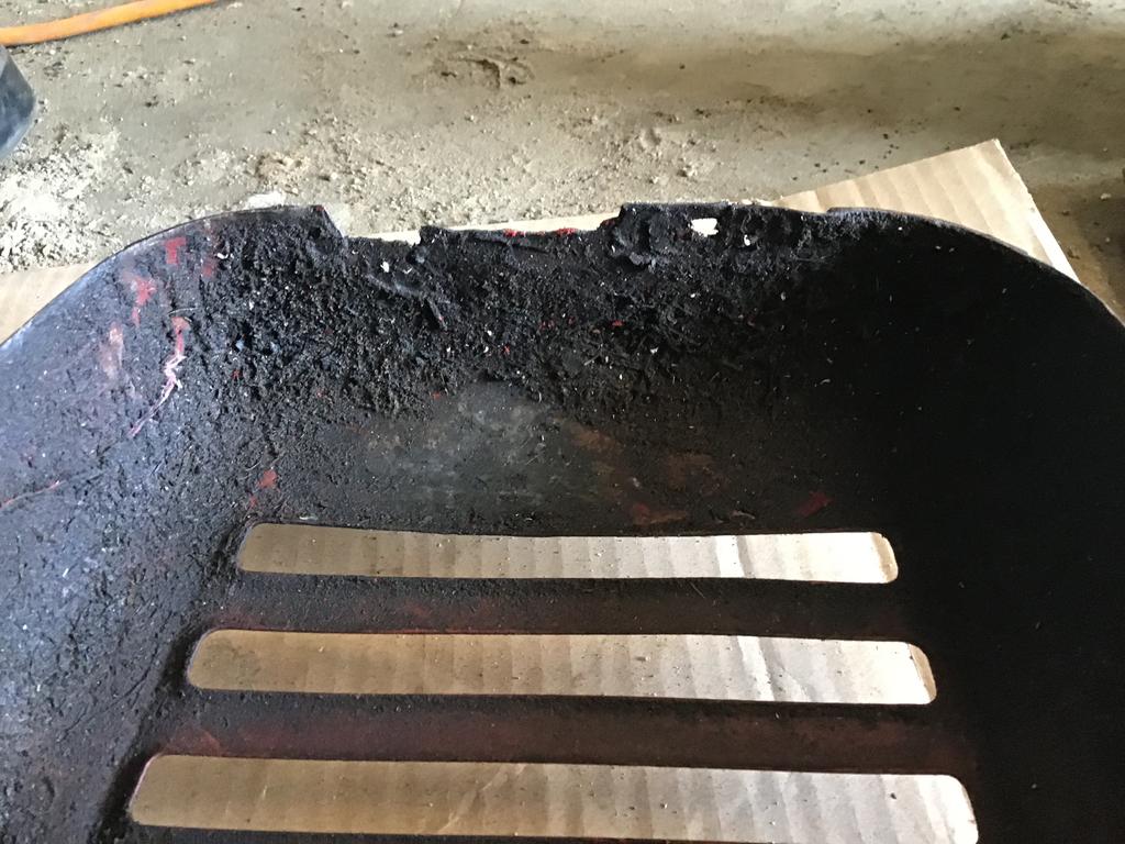

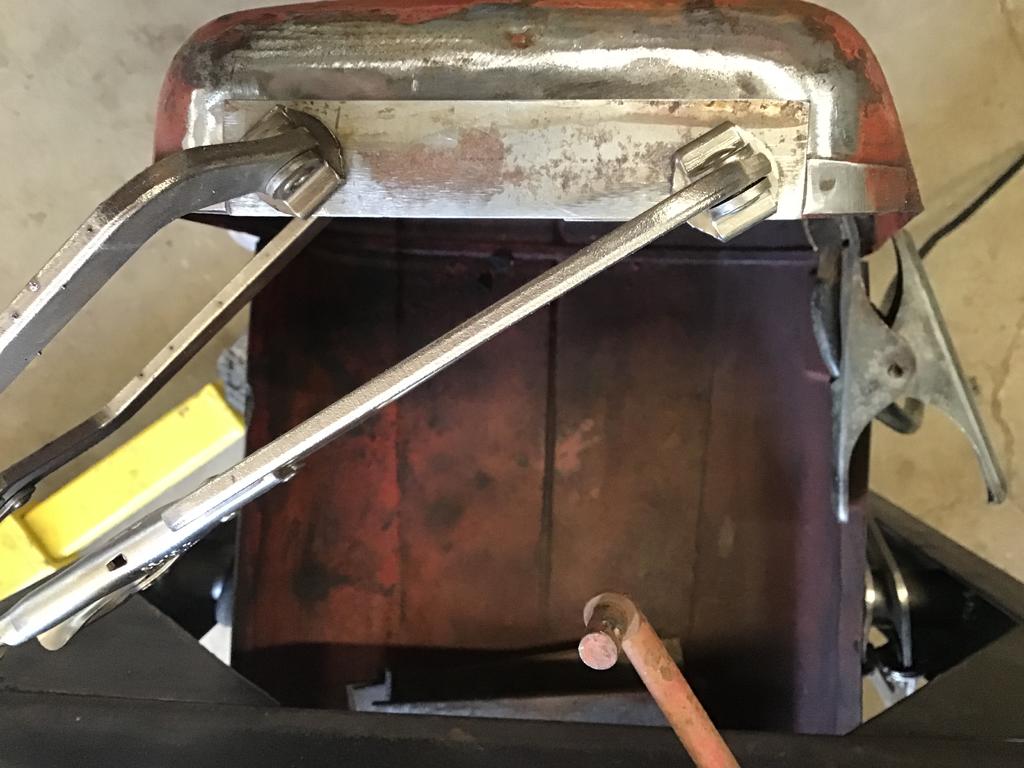

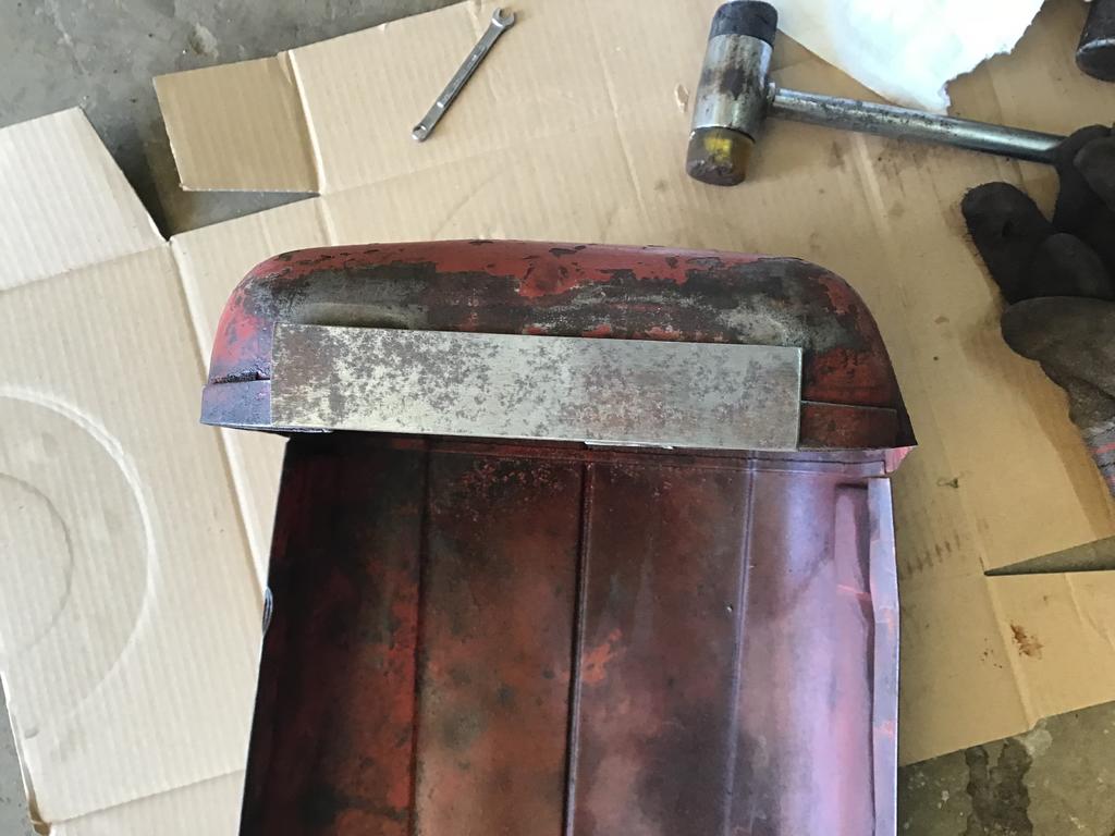

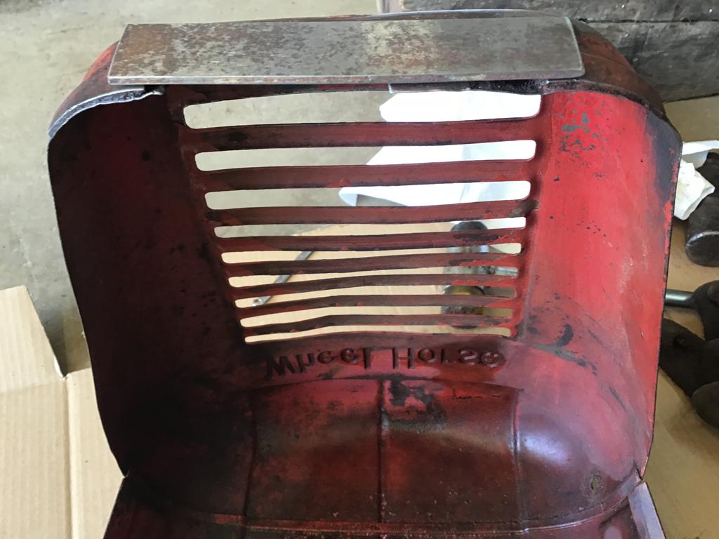

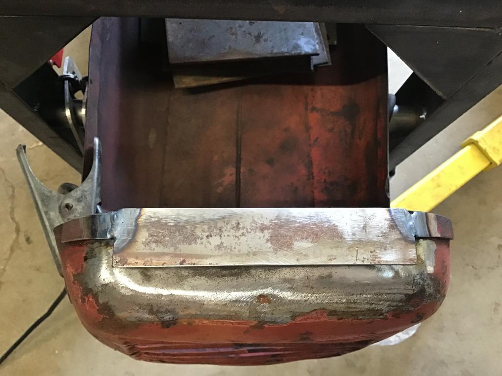

Pullstart 71,368 #520 Posted April 8, 2019 I cut a piece of 1/8” plate to weld in. It’ll make for a sturdy front mount. 2 Share this post Link to post Share on other sites

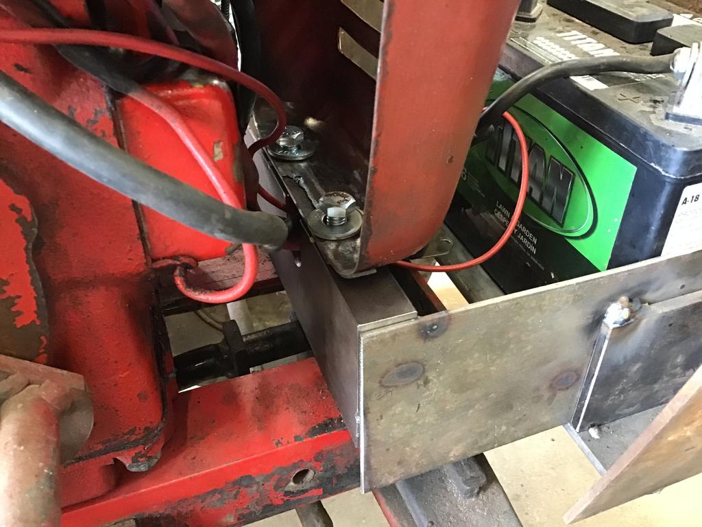

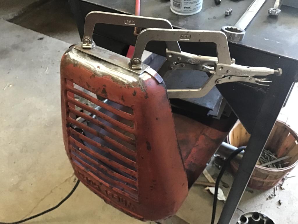

Pullstart 71,368 #521 Posted April 8, 2019 Right, wrong or indifferent, I’ve decided to weld the plate over what’s existing instead of cutting all the steel out and welding new in. 3 Share this post Link to post Share on other sites
Tractorhead 9,217 #522 Posted April 8, 2019 Think with good rust protect it's good for another 20years 1 Share this post Link to post Share on other sites

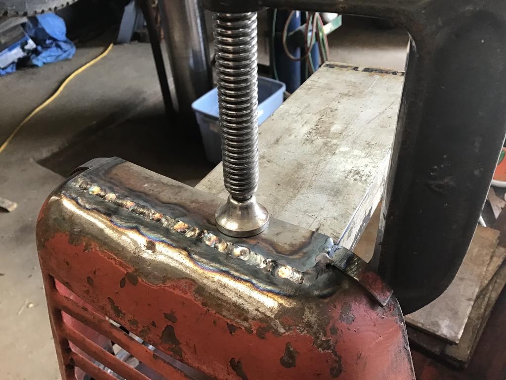

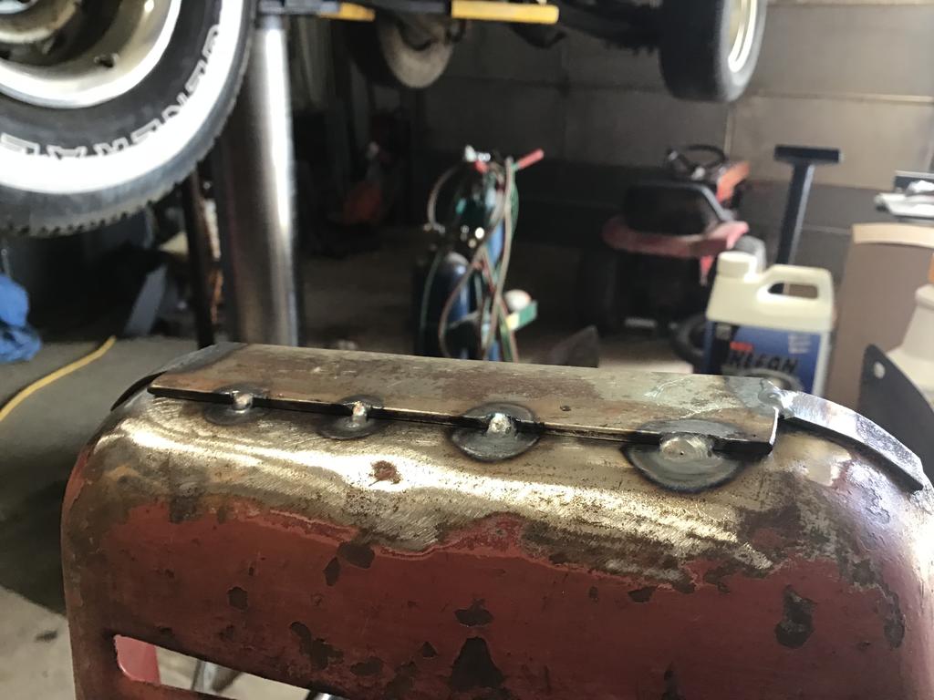

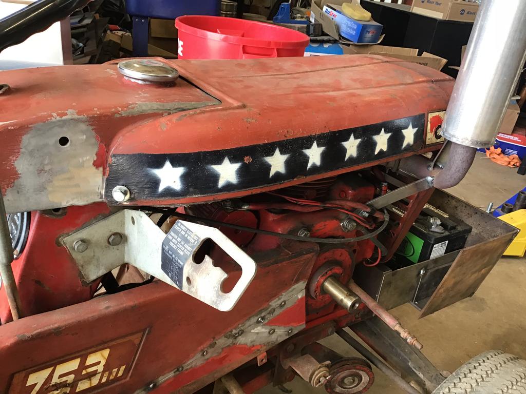

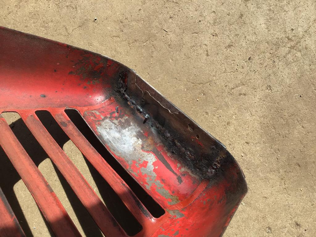

Pullstart 71,368 #523 Posted April 8, 2019 I jumped around welding about 3/8” or so at a time, with an aluminum heat sink clamped to the work piece and the air nozzle cooling it as well. Stainless filler on the TIG machine 5 1 Share this post Link to post Share on other sites

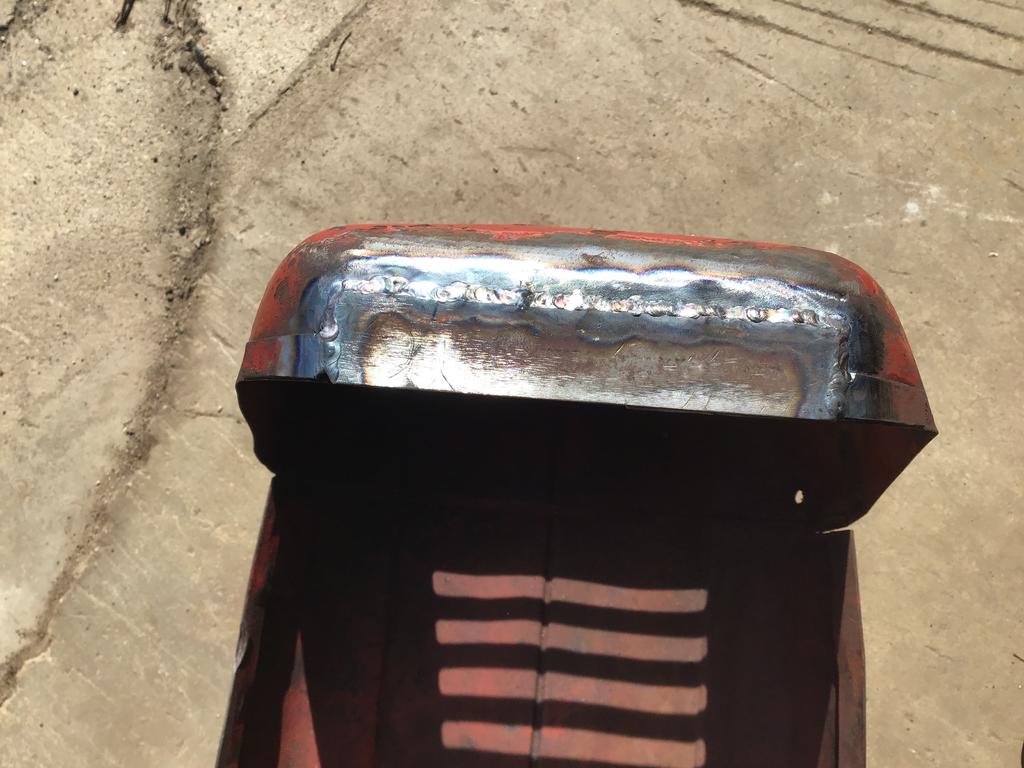

Pullstart 71,368 #524 Posted April 8, 2019 It fits! 1 2 1 Share this post Link to post Share on other sites

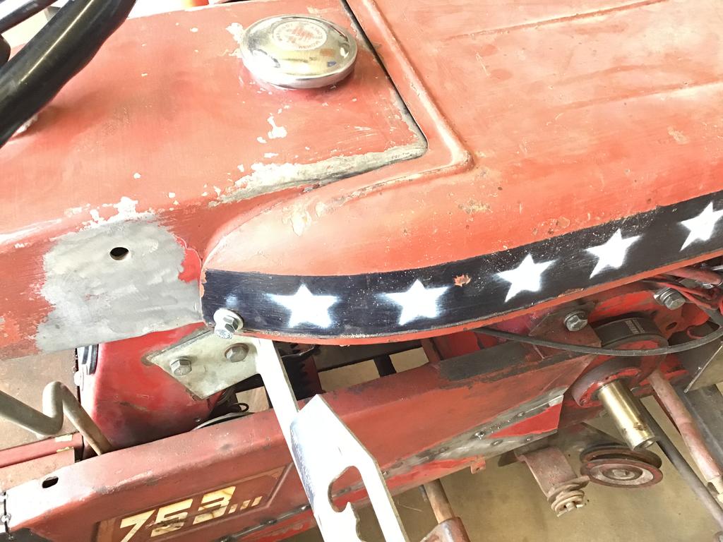

Pullstart 71,368 #525 Posted April 8, 2019 I might wait to fix the seams... this hood ain’t budging! 5 2 1 Share this post Link to post Share on other sites
