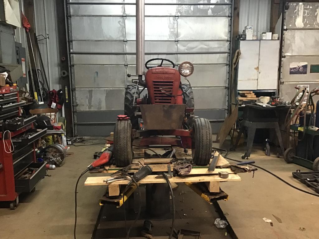

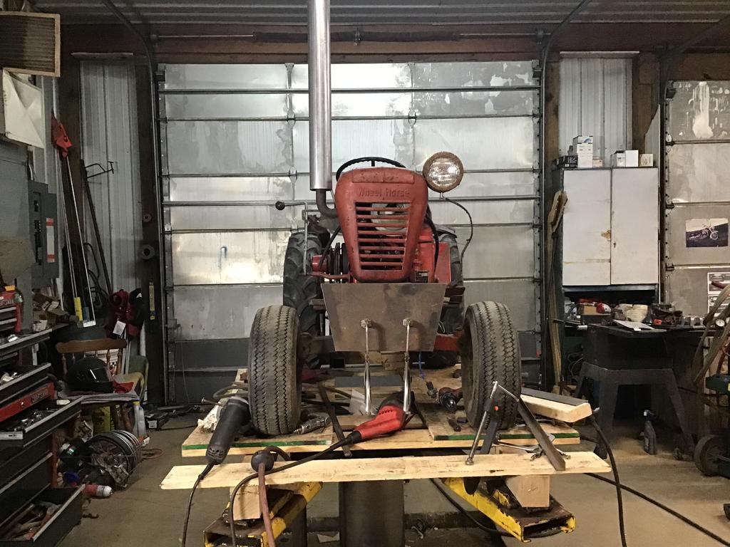

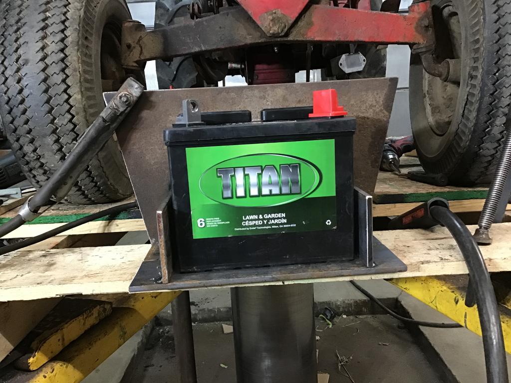

Pullstart 71,103 #227 Posted November 5, 2018 Building a battery box frame, the heavy plate will be the front. Once the frame is together it’ll get skinned with 1/16” plate and have a removable cover for battery access. 2 Share this post Link to post Share on other sites

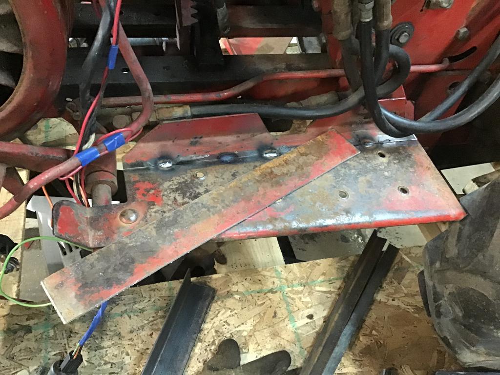

Pullstart 71,103 #228 Posted November 5, 2018 I’m a little bit A.D.D. here I suppose. I cut the left foot rest and it looked funny. I realized the left was 2” wider than the right overall, in relation to the dash stand. Well, a little more cut and tack action took care of that. Thanks for following along on the build, but it’s time to go in for a few hours and grab a nap before tomorrow gets here! 3 Share this post Link to post Share on other sites

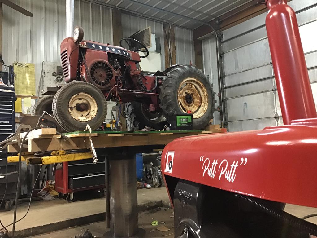

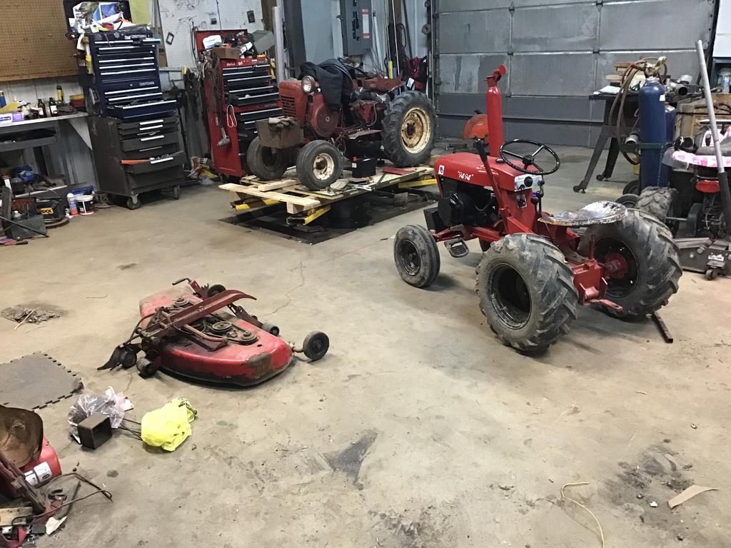

Pullstart 71,103 #229 Posted November 5, 2018 Pullstart’s shop is protected by Putt Putt, the junk yard dog. 1 5 Share this post Link to post Share on other sites

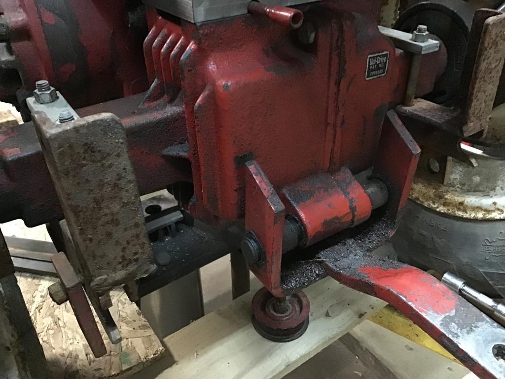

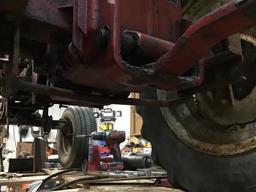

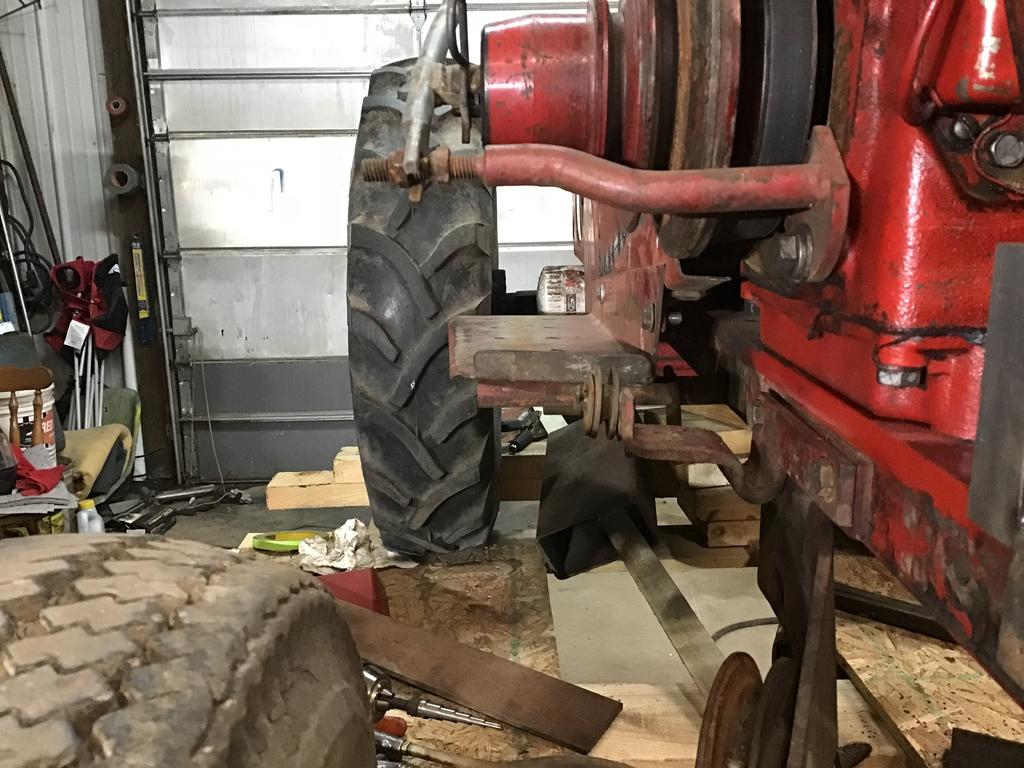

Pullstart 71,103 #230 Posted November 5, 2018 Not sure how much of this rear plow/tiller mount is factory , but it’ll make for a nifty fender mount! 1 1 Share this post Link to post Share on other sites

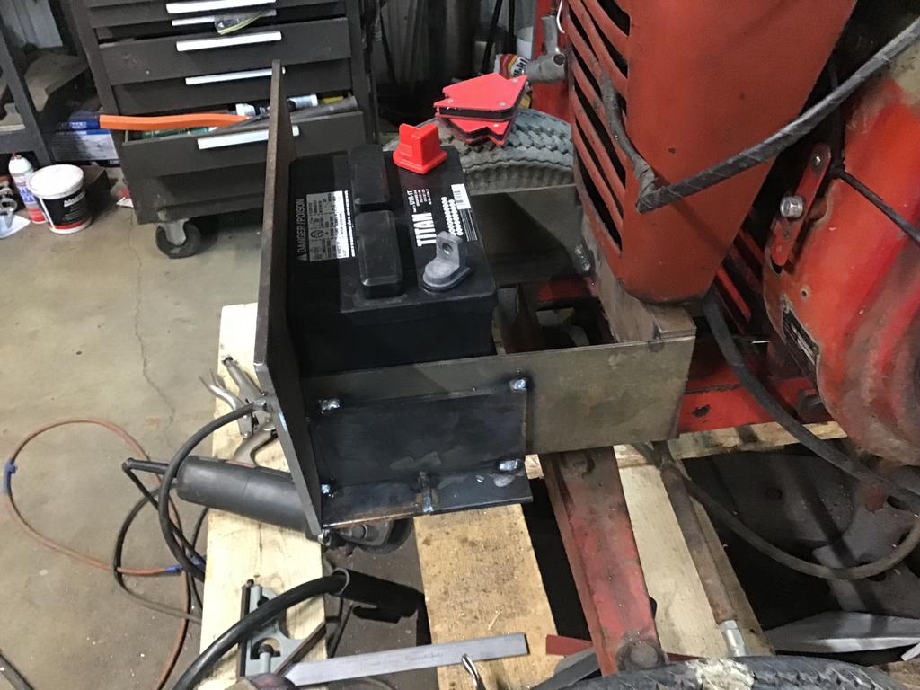

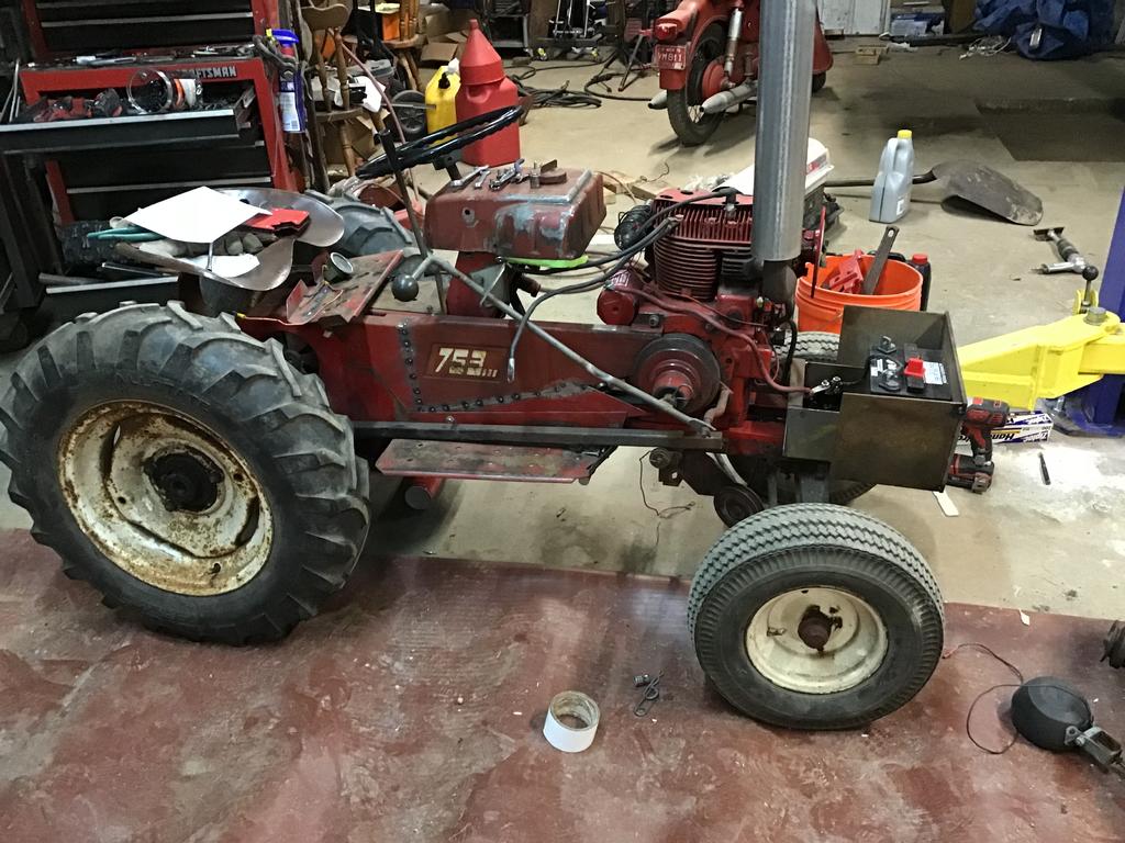

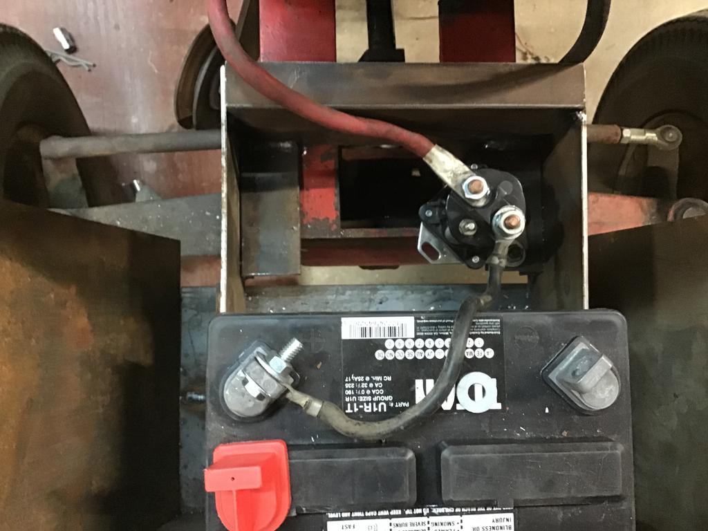

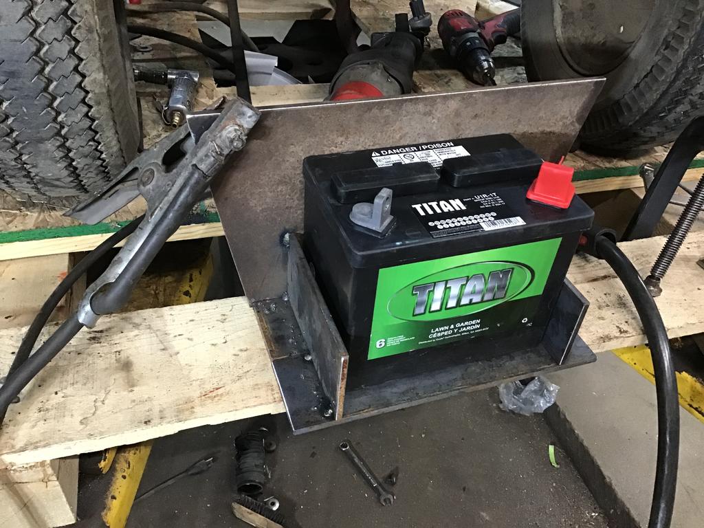

Pullstart 71,103 #231 Posted November 5, 2018 Battery box main frame is tacked up! 2 3 1 Share this post Link to post Share on other sites

ebinmaine 80,304 #235 Posted November 15, 2018 On 11/5/2018 at 4:21 PM, pullstart said: Battery box main How's this held on the front of the tractor? I like the looks of it allot. Share this post Link to post Share on other sites
Pullstart 71,103 #236 Posted November 15, 2018 The 1x3 bar stock is drilled and tapped, bolted on from underneath. Everything is tack welded to that. It’s also got angle iron resting on the frame tacked to the bar stock too. 2 Share this post Link to post Share on other sites

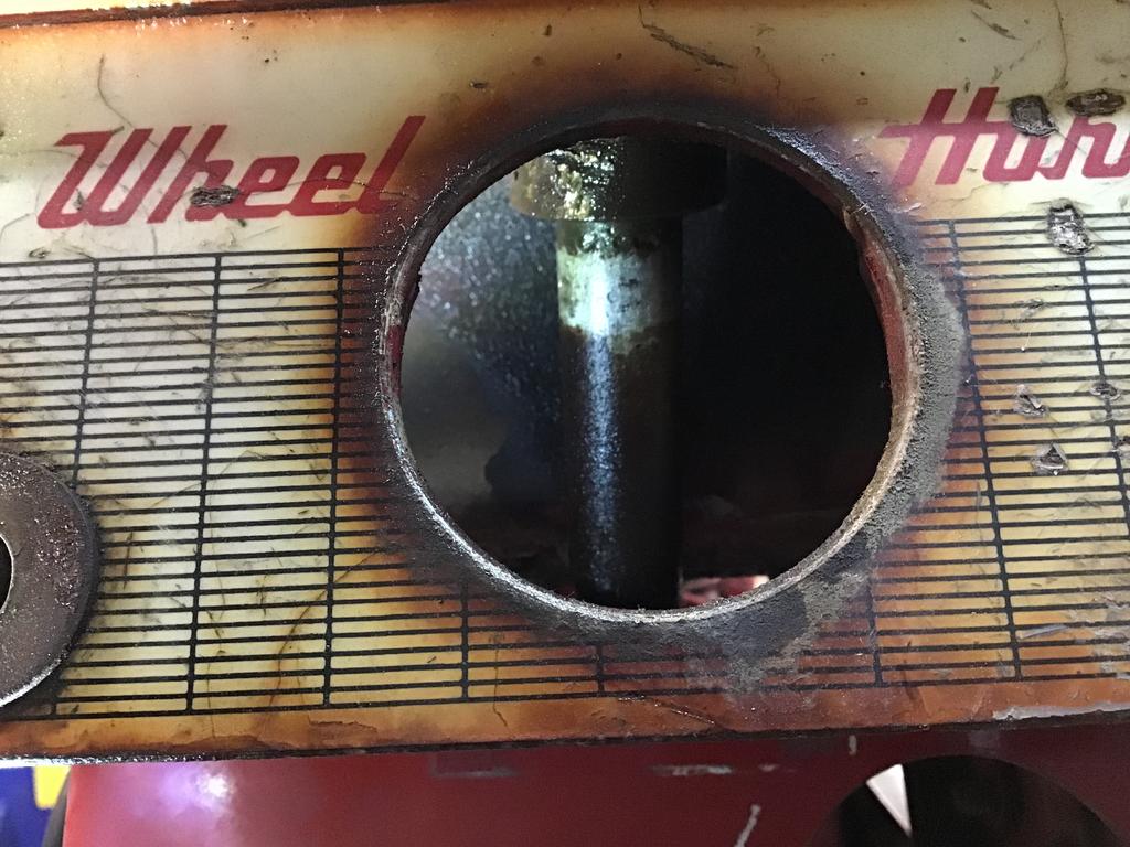

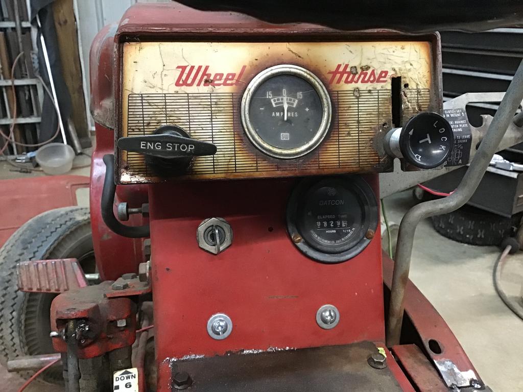

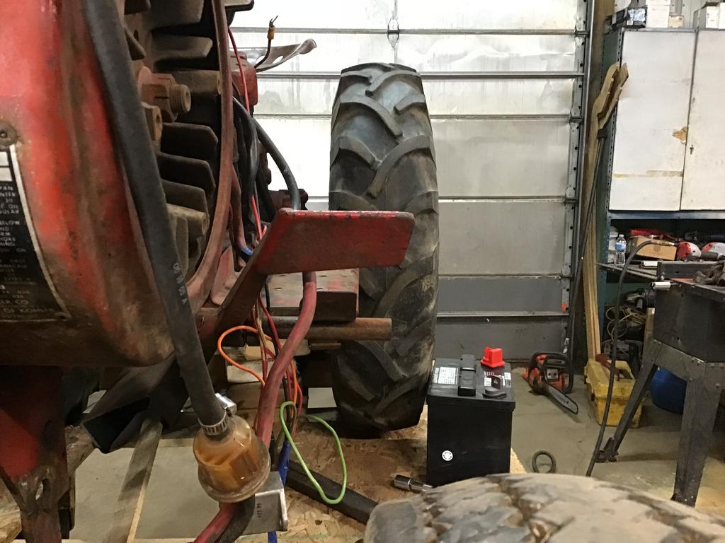

Pullstart 71,103 #240 Posted December 3, 2018 (edited) On 11/25/2018 at 9:25 AM, Tractorhead said: Hi Kevin, good to hear you are well. I have just wondered, but now i see, you are very busy. keep on Rockin and greeting to Family Stefan I scored some “me” time tonight, so I headed out to the shop. Doing some wiring layout and I shimmed the steering fan gear and snugged up the locking collar under the dash for good steering gear mesh. Edited December 3, 2018 by pullstart *snugged* Not *snuggled* 7 1 Share this post Link to post Share on other sites

WHX?? 57,808 #243 Posted December 3, 2018 Whats the story with the show scoot in the first pic Kev? I noticed it when I was admiring your well kept work space! Share this post Link to post Share on other sites
Pullstart 71,103 #244 Posted December 3, 2018 41 minutes ago, WHX21 said: I was admiring your well kept work space! Organized khaos... it’s a ‘67 Puch. I posted it. As a non truck in the vintage trucks post. Fun to ride, 250 cc 2 stroke! 1 1 Share this post Link to post Share on other sites
Stormin 9,988 #245 Posted December 3, 2018 15 minutes ago, pullstart said: Alpine 150 Organized khaos... it’s a ‘67 Puch. I posted it. As a non truck in the vintage trucks post. Fun to ride, 250 cc 2 stroke! I've been try to identify those silencers. New they weren't British. My sister had an early '60 Puch Alpine 150cc scooter. 1 Share this post Link to post Share on other sites

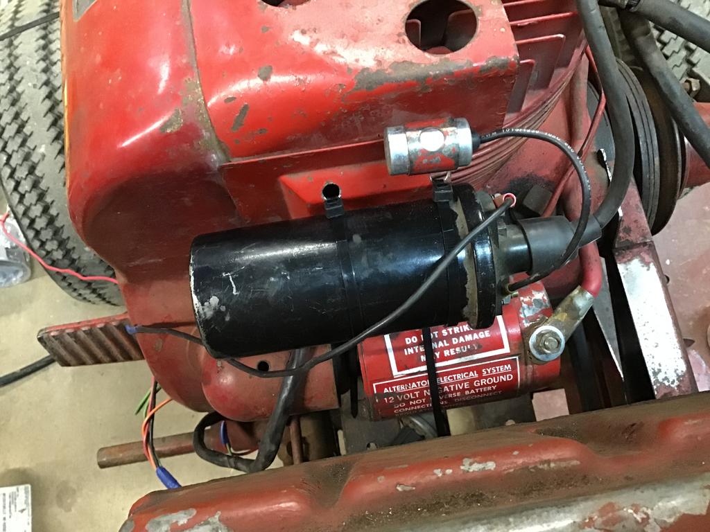

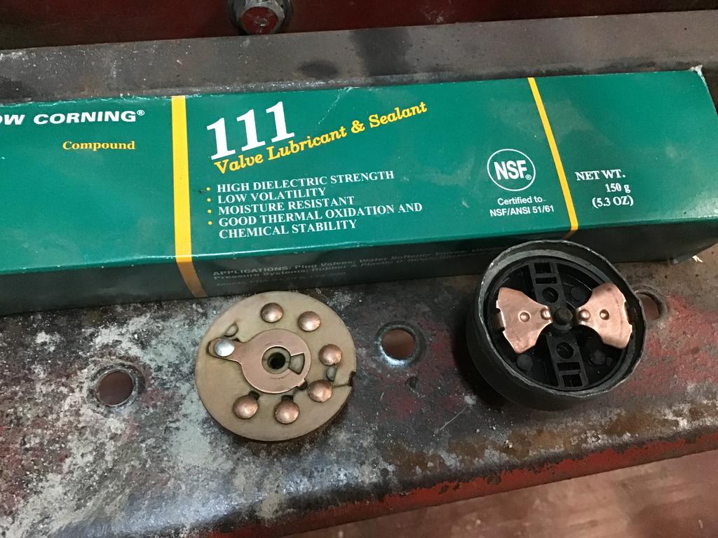

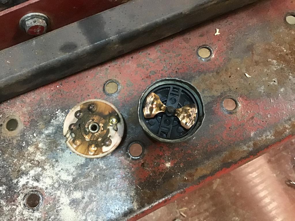

Pullstart 71,103 #246 Posted December 4, 2018 I’d been having some electrical gremlins in the past with the C-101 that this harness (engine) came from, and I thought I had fixed it by cutting the safeties out of the circuit. That worked, or helped, until Frank’s maiden voyage test drive. I was halfway across the back 10 when it died out. I believe it quit giving the coil power when it was running. It fired up fine, but as soon as the starter position was released it would die. I decided to pull the switch apart and this is what I found. I’ll brake clean it, give it a polish on the contacts, fresh grease and try it out... 3 Share this post Link to post Share on other sites

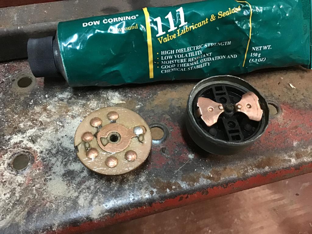

Pullstart 71,103 #247 Posted December 4, 2018 A little brake clean, a little wire brush, a little grease... looks like it’ll work fine! I used channel locks to pull the switch housing apart, and the back side of the, to peen it closed. 2 1 Share this post Link to post Share on other sites
953 nut 68,520 #248 Posted December 4, 2018 33 minutes ago, pullstart said: A little brake clean, a little wire brush, a little grease... looks like it’ll work fine! Kevin, you are much more resourceful than most of us. Think I would have pulled a new switch off the shelf and tossed the old one. 1 Share this post Link to post Share on other sites
Pullstart 71,103 #249 Posted December 4, 2018 45 minutes ago, 953 nut said: Kevin, you are much more resourceful than most of us. Think I would have pulled a new switch off the shelf and tossed the old one. I was on the way to the parts store... then thought “why not look?” 2 1 1 Share this post Link to post Share on other sites

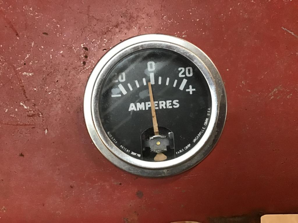

Pullstart 71,103 #250 Posted December 5, 2018 2 1 1 Share this post Link to post Share on other sites
