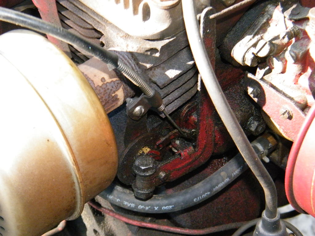

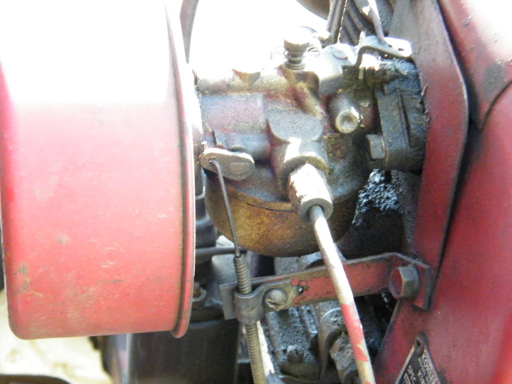

stevasaurus 23,617 #23 Posted October 6, 2018 I hate to ask this, but are you sure your choke cable is not coming in from the wrong side...and instead of opening your choke, you are closing it?? If it is like my 857, it should look like this... 1 Share this post Link to post Share on other sites
SaintJay 9 #24 Posted October 15, 2018 So I figured I'd give you guys who gave me advice an update. Stevasaurus put me on the right track. It was actually a combination of things. I found a very small leak in the head gasket. It was under the motor shroud and not visible until I took it off to check the head bolt torque. I also found that in the main carb needle, the lower hole was clogged. I cleaned and reassembled the whole carb, took off the head, cleaned it up and installed a little gasket sealer on the metal gasket and put it all back together again. Seems to have solved the problem and she is running much better now. I give a heartfelt thanks to all those who gave me advice and put me on the right track, and also for welcoming me here. 4 1 Share this post Link to post Share on other sites
