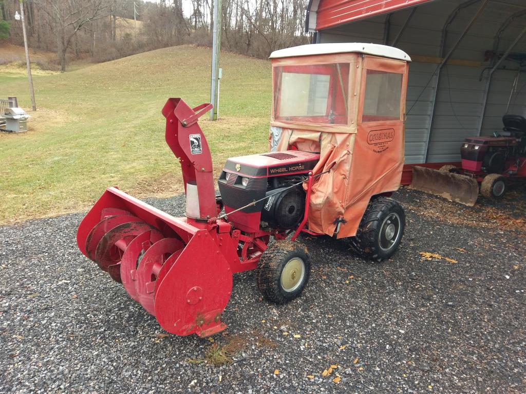

JoeB 34 #1 Posted October 3, 2018 I have a blower cab that fits on a B or C series WH. However I have a 312H. Is it possible to fit that cab on my 312H? thanx joe Share this post Link to post Share on other sites
WVHillbilly520H 10,378 #2 Posted October 3, 2018 10 minutes ago, JoeB said: I have a blower cab that fits on a B or C series WH. However I have a 312H. Is it possible to fit that cab on my 312H? thanx joe Yes, I put an older cab on my 520H 1 2 Share this post Link to post Share on other sites
Machineguy 877 #3 Posted October 3, 2018 39 minutes ago, WVHillbilly520H said: Yes, I put an older cab on my 520H That’s the rare power window, locks and rear defroster model! 3 Share this post Link to post Share on other sites
squonk 45,599 #4 Posted October 3, 2018 Takes a bit of drillin and fillin but it can be done. Share this post Link to post Share on other sites
WVHillbilly520H 10,378 #5 Posted October 3, 2018 7 minutes ago, squonk said: Takes a bit of drillin and fillin but it can be done. Never drilled 1 hole all mounting points were the same, only thing I did was trim the thick foot pads for the cowl risers. 1 Share this post Link to post Share on other sites

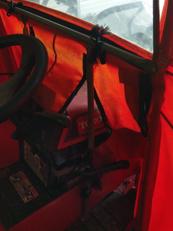

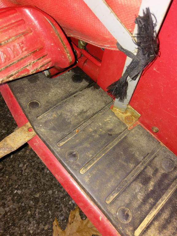

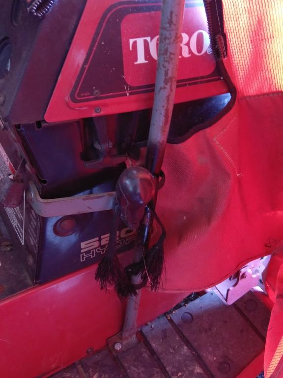

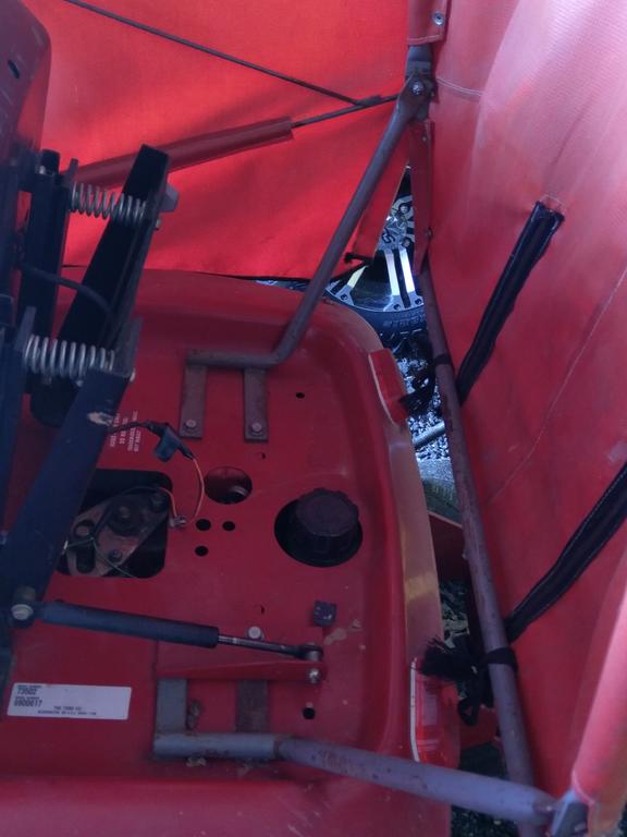

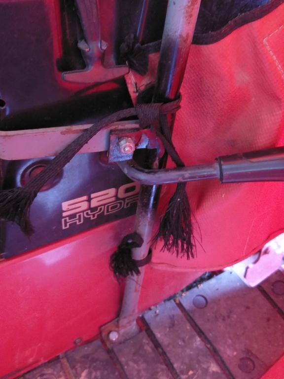

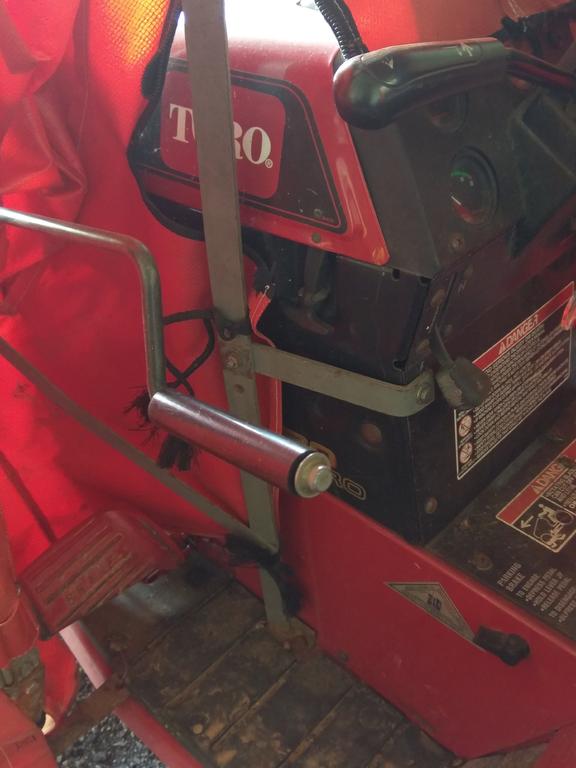

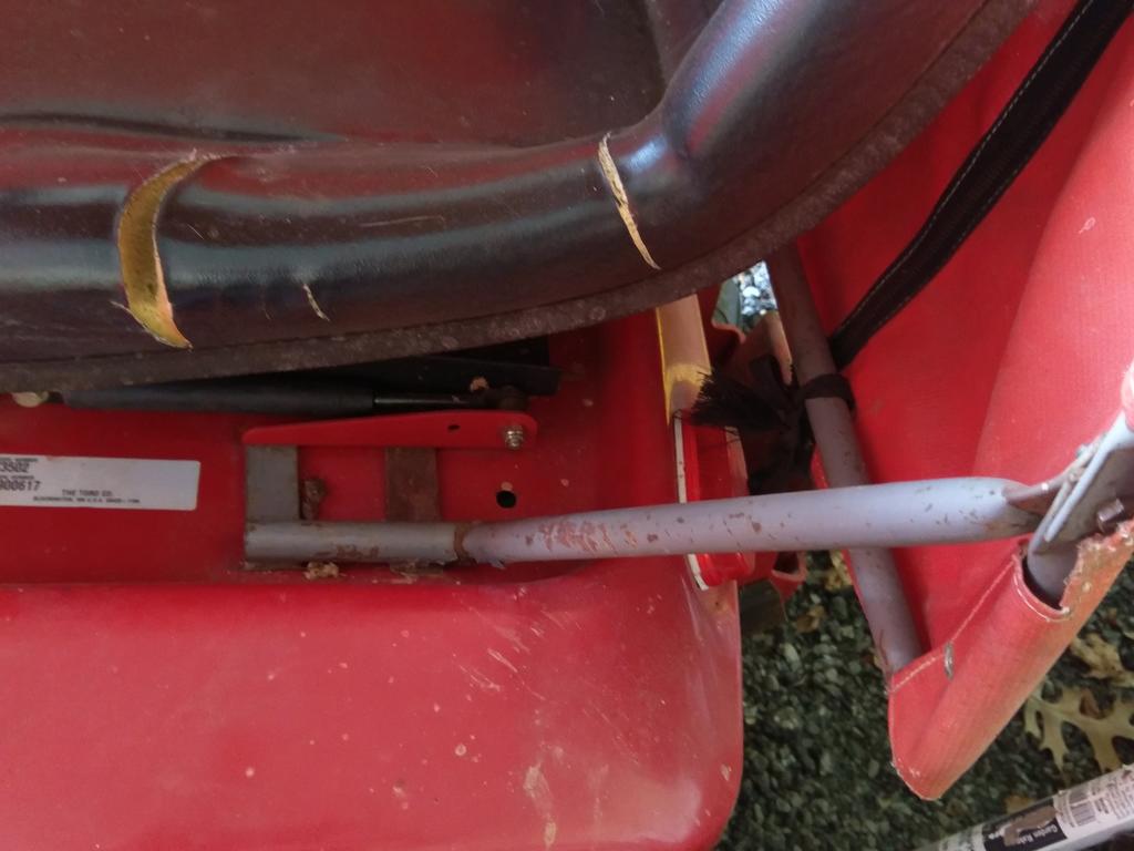

520hC-120 136 #6 Posted October 3, 2018 WVHillbilly520H, Could you take pictures of all the mounting points and such on the cab? I have a C/B series cab I want to put on my 520H but not all the parts came with it. Share this post Link to post Share on other sites
WVHillbilly520H 10,378 #7 Posted October 3, 2018 30 minutes ago, 520hC-120 said: WVHillbilly520H, Could you take pictures of all the mounting points and such on the cab? I have a C/B series cab I want to put on my 520H but not all the parts came with it. I will try after work today. 1 Share this post Link to post Share on other sites
WVHillbilly520H 10,378 #8 Posted October 4, 2018 On 10/3/2018 at 5:32 AM, 520hC-120 said: WVHillbilly520H, Could you take pictures of all the mounting points and such on the cab? I have a C/B series cab I want to put on my 520H but not all the parts came with it. Sorry I didn't get to it yesterday so here you go today...hope this helps Share this post Link to post Share on other sites
520hC-120 136 #9 Posted October 4, 2018 Thanks! I gotta get working on mine now. 1 Share this post Link to post Share on other sites
