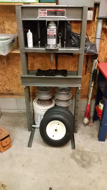

WHX?? 55,673 #1 Posted October 1, 2018 (edited) For those of you you don't have one... get one!. 30 years ago when I worked on farms I happened by a traveling salesman who had a press, a engine hoist and a small standing bandsaw all in the back of a pickup. For 350 he let me have all three. I eventually traded the band saw for I don't remember but the press and the hoist I traded to a buddy for my current drill press. I never really had the use for a shop press till I caught the bug. Steering wheels, and other stuck things being such. So my buddy still has the press and never uses it, same thing with that lathe he refuses to part with! He would let me use the press whenever he is at his shop but catching him ther is a PITA. So in watching for the coupon at HF I went and got my own...hey the steering wheels are piling up! $185 regular and armed with a coupon I got one for 130. Yeah it's a over seas cheapy but I figure for a hobbyist. Pros: Fairly heavy and came with a heavier set of multi cut out arbor plates. Paint was fairly decent and resistant to chips. Some assembly required but 10 minutes.... took me alot longer to clear out the junk to place it! Fairly compact but good work space. They offer a 12 ton version that is really compact but I feared 12 might not cut it. Easily removable jack with handle case you need to take it out for that under the apple tree work! Cons: Jack is very slow ... pump to piston displacement means you have have to really work it to get it move a 1/2"to get it to the work piece. Stand ....While the frame is heavy enough the legs are small angle and are held on by four cheesy bolts allowing it to wobble a bit. Would be worse on uneven floors. The ticket will be to weld them solid, shim and anchor it to the floor. Jack handle was two piece and fell apart when you looked at it . Drilled it and put in a roll pin. Rather narrow apron ...might not let you get steering gear or other work pieces throught it. All in all pleased with it so far but will see how it does other work Handled two steering wheels easily. Feel free to show what you might have. Edited October 1, 2018 by WHX21 Speeling & Gramma 15 1 Share this post Link to post Share on other sites

squonk 45,789 #3 Posted October 1, 2018 I had the 12 ton worked fine. and was able to move it around. Finally sold it to my b-i-l.I really didn't need it. you want a slow moving jack for power. If it moves fast you end up doing more work pumping than you think and if somethings really stuck you'll be "hanging off the handle. Slow jack means more mechanical advantage. Look at the "rapid pump" floor jacks. They are 2 stage. with no load they raise fast then when the load hits they slow down. 5 Share this post Link to post Share on other sites

Sarge 3,470 #6 Posted October 1, 2018 (edited) Be really careful with the included press plates from HF - they can shatter or break. Look into the set from http://www.swagoffroad.com/SWAG-Arbor-Plates_c_52.html - very well made. I sourced my own from a steel scrap yard - found a large chunk of 1-1/4" plate steel that is A-50 grade, more than handles my 30 ton Carolina press. Sarge Edited October 1, 2018 by Sarge dead link 2 1 Share this post Link to post Share on other sites

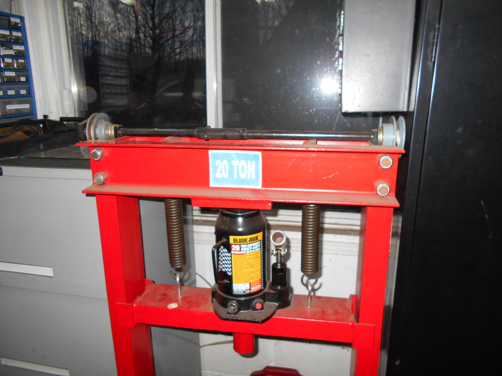

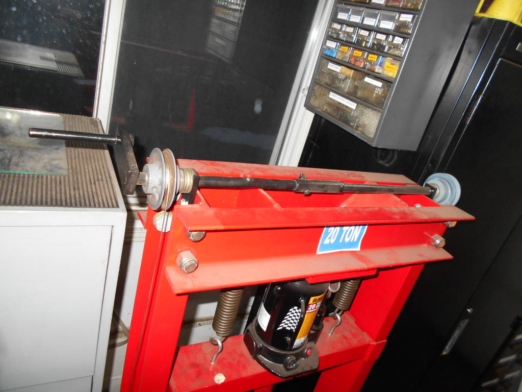

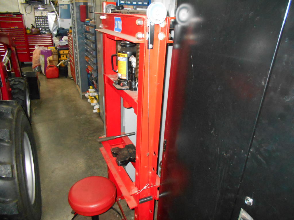

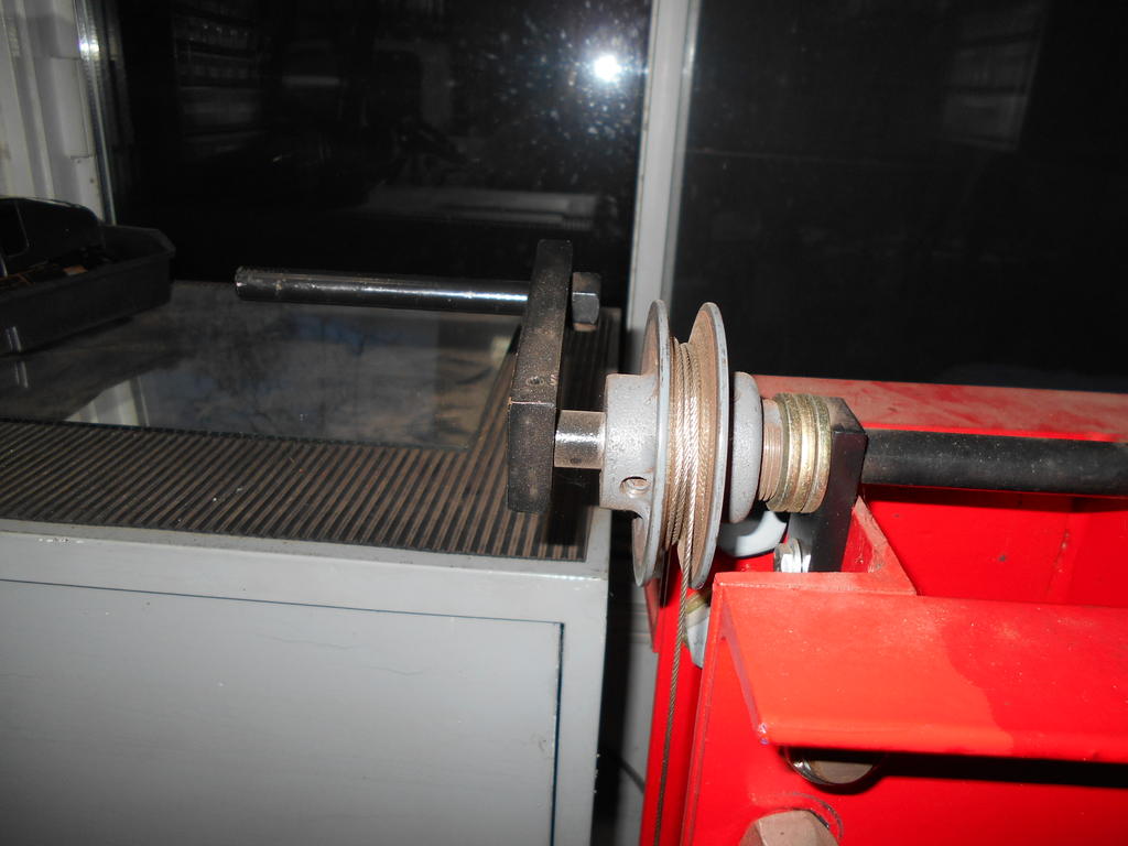

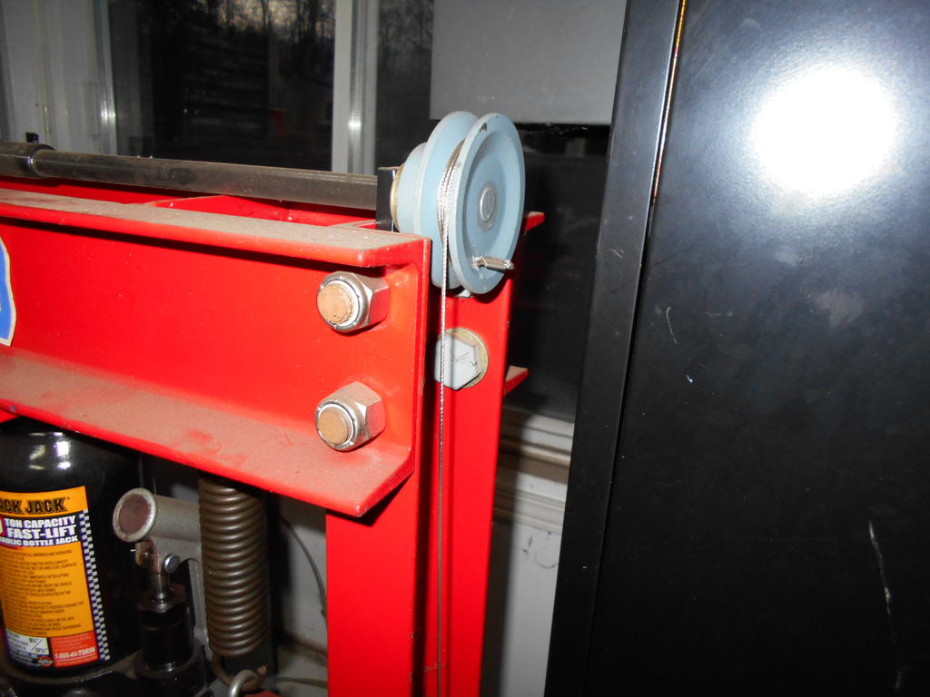

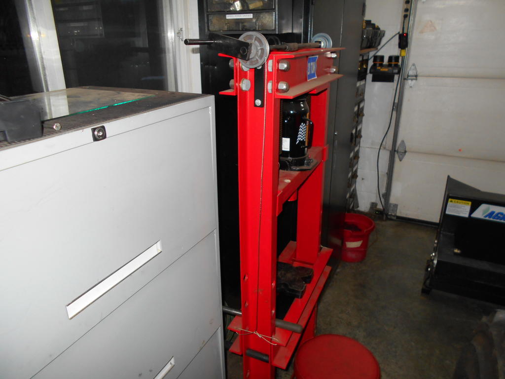

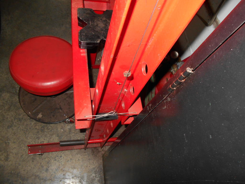

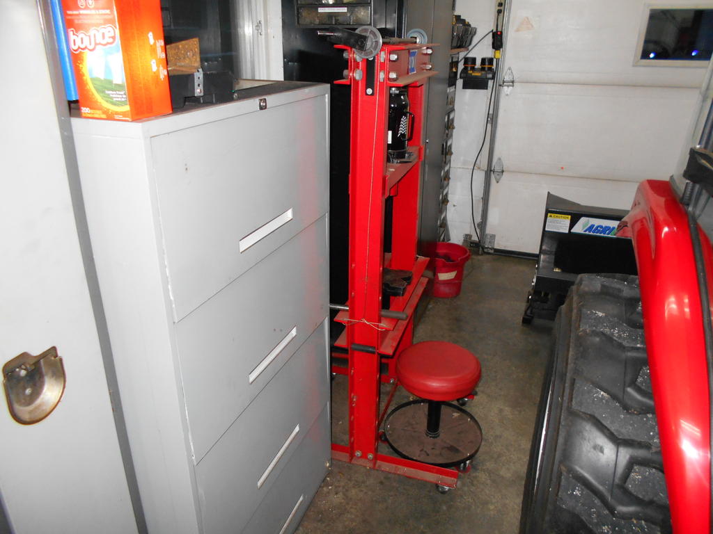

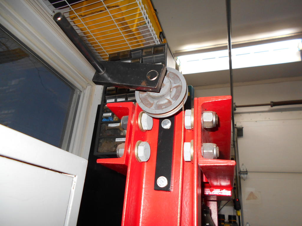

cleat 8,813 #10 Posted October 2, 2018 My 20 ton looks like that. I upgraded to a 2 stage jack for it and it now works nice and quick. The other upgrade I did was to add a crank and pulleys to the top connected with small cables to raise and lower the bed. Cleat 2 Share this post Link to post Share on other sites

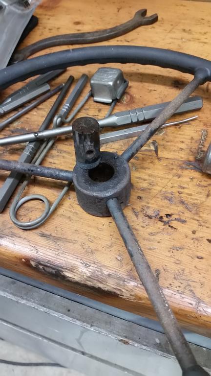

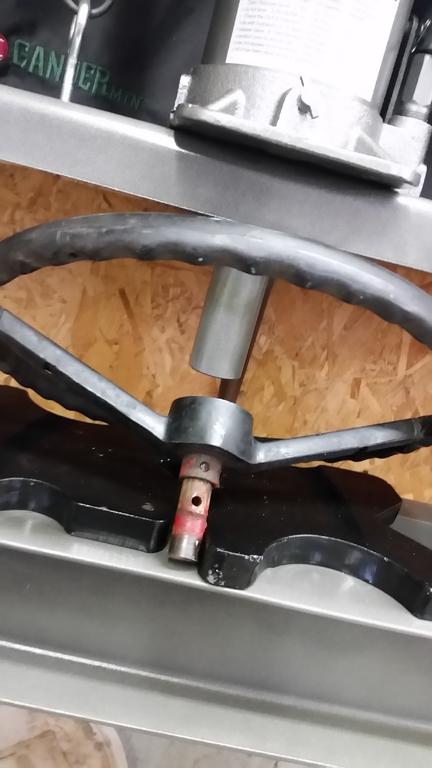

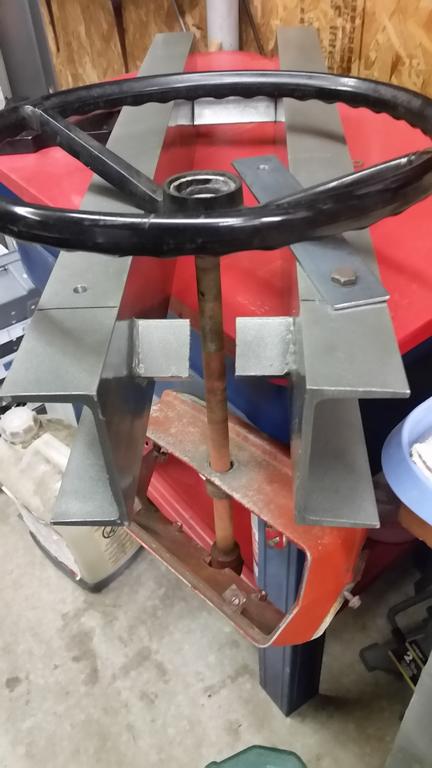

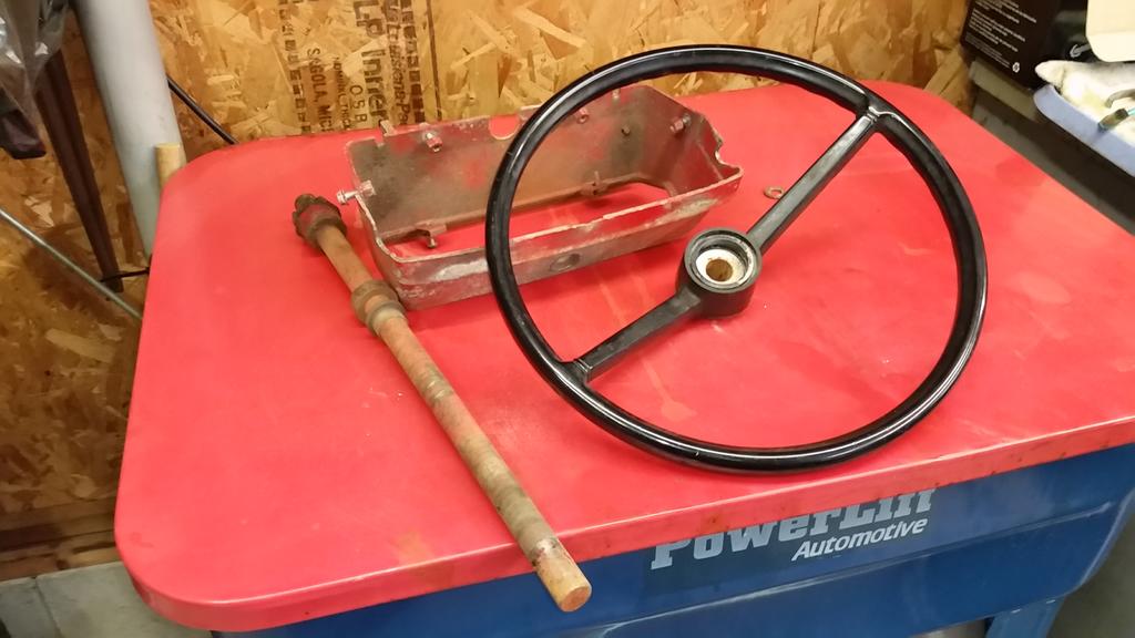

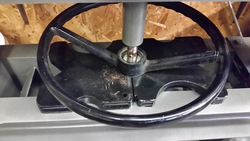

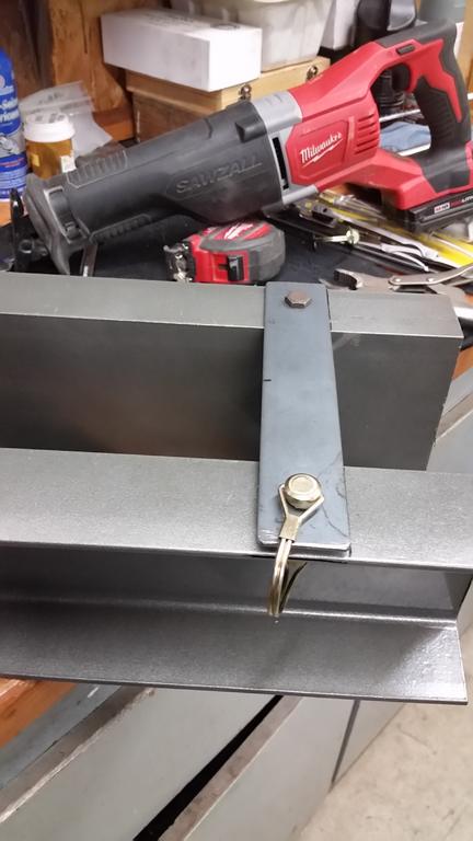

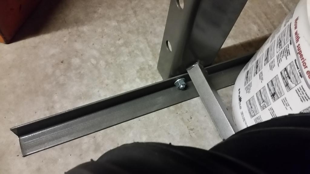

WHX?? 55,673 #11 Posted December 5, 2018 (edited) Mods up date... How many times have you stripped a tractor down only to have a steering wheel brown welded to the shaft and unable to separate it from the dash? Kinda cumbersome to store on the shelf and even harder to get the whole assembly in the press. Hers a mod I did to be able to slip the whole assembly in the bed. First fab and mount a top piece across the top of the bed. Doesn't have to be real heavy as there is no real stress here when pressing. I used a loose tightened bolt with a nylock on the back side for pivot and a hitch pin on the front for tool less use. Then cut out about an inch of the angle holding the bed halves together. Cut the whole thing out if you prefer. Install back on press and give her. This one gave up pretty easy but have a few more that won't. I have a soft touch wheel that has some real nice moss growing on it I would like to save but the roll pin is welded solid and gonna be a bear. Already trashed two cobalts trying to drill it out. Edited December 5, 2018 by WHX21 3 1 1 Share this post Link to post Share on other sites
953 nut 64,611 #12 Posted December 5, 2018 19 minutes ago, WHX21 said: roll pin is welded solid and gonna be a bear. I like your Mod, been thinking of doing that myself. Your next Mod could be a saddle to hold the hub of the steering wheel while pressing out the roll pin. 1 Share this post Link to post Share on other sites
WHX?? 55,673 #13 Posted December 5, 2018 The saddle is not my problem Dick ..it's finding a piece of hardened steel of the right diameter to use as an arbor. 1 Share this post Link to post Share on other sites
953 nut 64,611 #14 Posted December 5, 2018 9 minutes ago, WHX21 said: piece of hardened steel of the right diameter to use as an arbor. The butt end of a high speed steel drill bit should be hard enough, you would also need to make a fixture to hold it in position on the press. Share this post Link to post Share on other sites
DennisThornton 4,773 #15 Posted December 5, 2018 On 10/1/2018 at 9:40 PM, cleat said: My 20 ton looks like that. I upgraded to a 2 stage jack for it and it now works nice and quick. The other upgrade I did was to add a crank and pulleys to the top connected with small cables to raise and lower the bed. Cleat Pictures please. Share this post Link to post Share on other sites

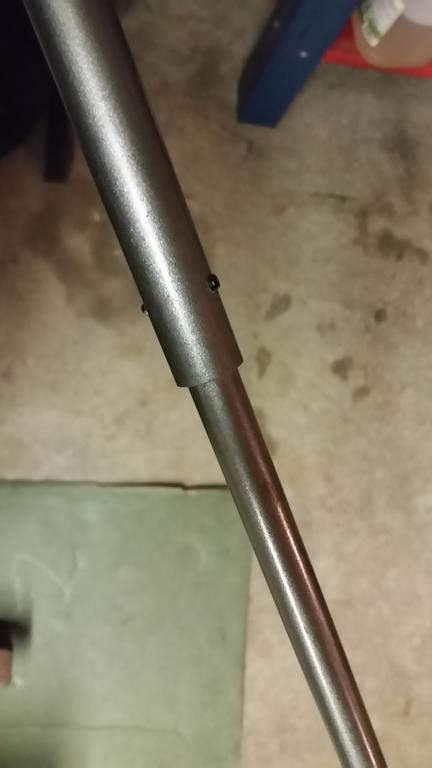

cleat 8,813 #16 Posted December 6, 2018 Here are the pics. Basically built from scrap pulleys, a piece of rod, and some bits of flat bar. Nothing is welded (but could be), I used bolts or roll pins. The cable is the thinnest aircraft cable I could find with crimps on the ends to hold it. Cleat 2 4 Share this post Link to post Share on other sites

squonk 45,789 #23 Posted October 5, 2021 Why not put 2 pieces of steel across to catch the "hub" of the wheel instead of pushing on the wheel itself? Share this post Link to post Share on other sites

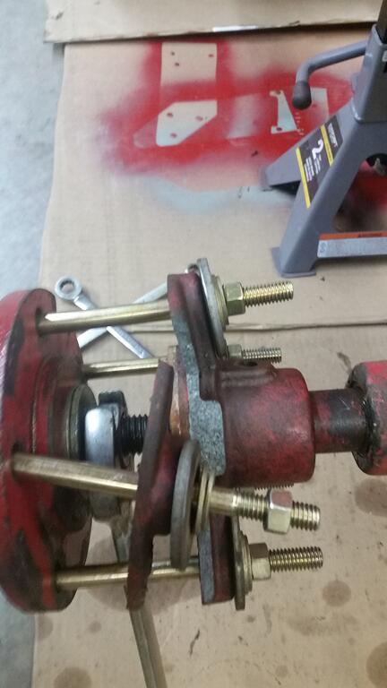

squonk 45,789 #24 Posted October 5, 2021 On 12/4/2018 at 8:23 PM, WHX?? said: This one gave up pretty easy but have a few more that won't. I have a soft touch wheel that has some real nice moss growing on it I would like to save but the roll pin is welded solid and gonna be a bear. Already trashed two cobalts trying to drill it out. I sheared a roll pin in half on my 1267 that was stuck with a big puller, brg. separator and an 18" Cresent wrench. You're not a "Sally" are you? 1 Share this post Link to post Share on other sites
