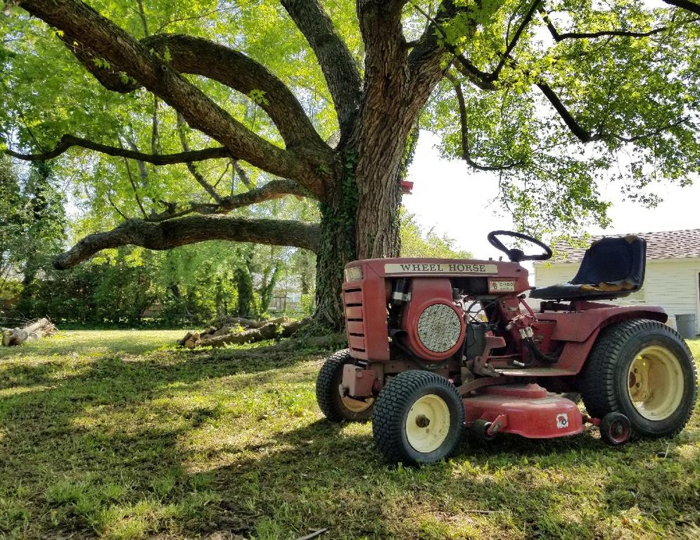

vdub_asher 2 #1 Posted September 30, 2018 (edited) I just picked up a 1976 c160 automatic. She runs great and seems to be in overall fairly good condition. This is my first wheel horse so I'm a little new to the ins and outs of how they are built. So anyway, I let my cousin cut the grass with my c160 and he thought it would be a good idea to do a wheelie on the concrete. He popped up and quickly came back down but hit down fairly hard. Right when that happened the tractor lost all capability of raising and lowering for the attachments (it has hydro lift). Then I noticed that it also will not go full speed in forward or reverse. I had been using the tractor for a few weeks before this happened so I know it was all functioning properly. What it seems like is either a restriction of fluid somewhere or a loss of pressure. The attachments will not raise up at all even with nothing connected to it, the cylinder will not move. If you run at full acceleration it will get up to speed but then it is as if it doesnt have fluid to pump or doesnt have pressure because it will all of a sudden come to almost a complete stop out of nowhere, then build pressure again right before it stops and start going again. It will keep doing that at full acceleration forward. If I lightly stay in forward it will maintain a constant speed but if I go past halfway it will go that. Reverse is also very weak and sometimes it takes a few seconds for it to even engage, especially when it is first started. I'm not sure where to start really. I have checked the fluid level (at least I think I did it right) which seems to be fine. It seems to have to have the correct fluid, motor oil, not transmission fluid. Not too sure what line pressures should be and all that. If anyone has any diagnostic help it would be much appreciated. Edited September 30, 2018 by vdub_asher 1 2 Share this post Link to post Share on other sites
