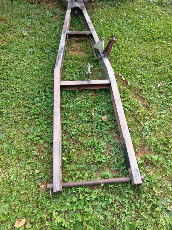

WVHillbilly520H 10,377 #2 Posted September 25, 2018 Any long frame plow will work from '73-2007 off B,C,3,4,500 series tractors looks a lot like this... Share this post Link to post Share on other sites

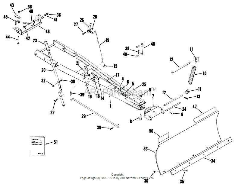

gwest_ca-(File Mod) 11,918 #3 Posted September 25, 2018 Here are the model numbers in the order they were produced. 1970-73 model [6-4113 & 6-9622], 1973-74 model [6-4113 & 6-9623], 1974 model [6-4114 & 6-9624], 1974 model 6-2131, 1975 model 6-2132, 1976 model 6-2133, 1976 model 66-42BC01 1977 model 76-42BC01, 1978 model 86-42BC01, 1979 model 96-42BC01, 1980 model 06-42BC01, 1981-84 model 06-42BC02, 1984-89 model 06-48BC01, 1990 model 06-48BC02, 1991-93 model 06-48BC03, 1993-2001 model 79350 and 2002 2004-2009 2012 model 79364 The years showing 2 model numbers are for the blade and a separate kit to fit the blade to this series of tractor. Notice they went from 42" to 48" in 1984 as evident by the model number. Garry 1 Share this post Link to post Share on other sites

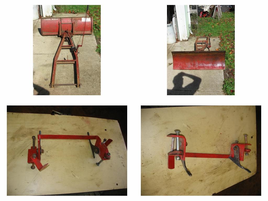

daveoman1966 3,881 #4 Posted September 25, 2018 Here is another pic or 2 of the dozer blade to fit the B-80. You'll need the REQUIRED axle bracket too...( I have one)... 1 1 Share this post Link to post Share on other sites
