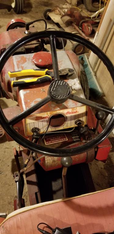

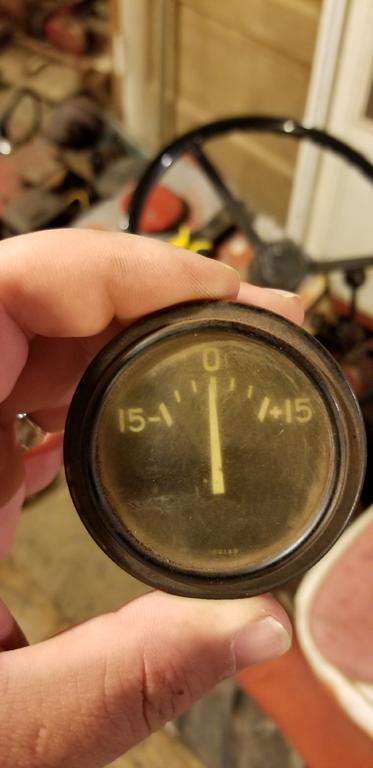

Mike'sHorseBarn 3,417 #1 Posted September 25, 2018 So I went to move the 753 a few weekends ago to go to a show and no spark. Weird seeing as though it was purring like a kitten 3 days before. Oh well stranger things have happened. So I was thinking it was the coil because it has new points and condenser and ignition switch. So I replaced the coil and I had 12 volts going to the coil. I made a new spark plug wire. Still nothing. Hmmm. Grabbed the end of the spark plug wire and turned it over to see if it would shock me.....nothing so it wasn't the plug. What the heck am I missing? I decided to tear all the old wires out and make new because it did have some wires in need of replacing. The amp meter quit working too, but that wouldn't cause the loss of spark would it? Also, I'm not sure if this was the original amp meter or not. I'm just sort of scratching my head on this one. Share this post Link to post Share on other sites

WHX?? 54,651 #3 Posted September 25, 2018 Definitely not the original ammeter Mike but does look cool .. not something stupid like bad new points or coil? 1 Share this post Link to post Share on other sites

buckrancher 2,695 #9 Posted September 25, 2018 that is the original amp meter I know you said that you have 12 volts at the coil you can manually with your fingers snap open and close the points and see if you have spark with the plug out sitting on a good ground and do you have the coil wires on right pos. on pos. and points and condenser on neg Brian 2 Share this post Link to post Share on other sites
Mike'sHorseBarn 3,417 #10 Posted September 25, 2018 46 minutes ago, buckrancher said: that is the original amp meter I know you said that you have 12 volts at the coil you can manually with your fingers snap open and close the points and see if you have spark with the plug out sitting on a good ground and do you have the coil wires on right pos. on pos. and points and condenser on neg Brian I've got it wired up right. I think I triple checked that lol good to know that's the original amp meter, bit I think I trashed the backside getting it out. It was very rusty and corroded. I'll try your trick opening the points with my finger and watching for spark. Share this post Link to post Share on other sites
