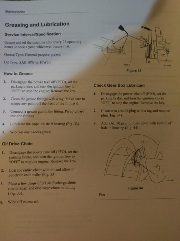

520hC-120 136 #1 Posted September 24, 2018 Hi guys, I wanted to know how to change the oil in my 2 stage snowblower model# 06-44SC01. Also what oil do I put in it. Thanks in advance! Share this post Link to post Share on other sites
WVHillbilly520H 10,377 #2 Posted September 25, 2018 The impeller/auger gear box I used 75w90 gear lube, and the jackshaft box was full and I never changed it, but you will have to stand it on end to drain if you decide to do... 1 Share this post Link to post Share on other sites
520hC-120 136 #3 Posted September 25, 2018 Ok thanks, still need to figure out how to change the oil nearest to the front of the tractor in that box I already drained it. Share this post Link to post Share on other sites
WVHillbilly520H 10,377 #4 Posted September 25, 2018 30 minutes ago, 520hC-120 said: Ok thanks, still need to figure out how to change the oil nearest to the front of the tractor in that box I already drained it. Remove top/fill level plug and use a piece of clear tubing(size of hole) attached to the gear lube bottle and fill till it starts to run out, done. Share this post Link to post Share on other sites
