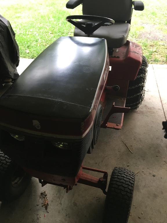

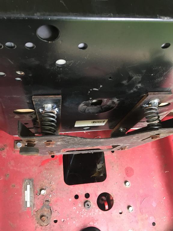

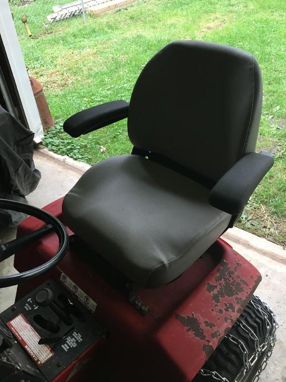

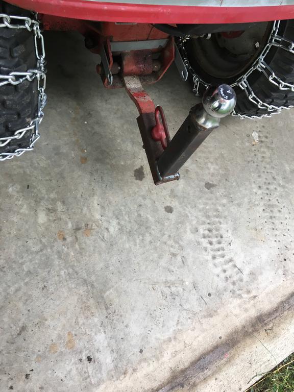

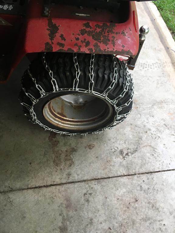

Torrence20 23 #33 Posted October 5, 2018 So I thought I’d post a couple pics. The hood was in bad shape paint wise so I repainted it with what I had on hand I plan on a tear down and repaint eventually providing this unit will suit me needs I’ve filled my tires with fluid put on some chains built a little hitch adapter to move my little trailer around it will only be empty when moved with this as I don’t trust the hitch on this to haul a lot of weight with the ball on it like it is, new fuel lines and filter, carb clean new seat and some added springs so it doesn’t hit the fenders when bouncing new toggle switch and new lights 1 Share this post Link to post Share on other sites
