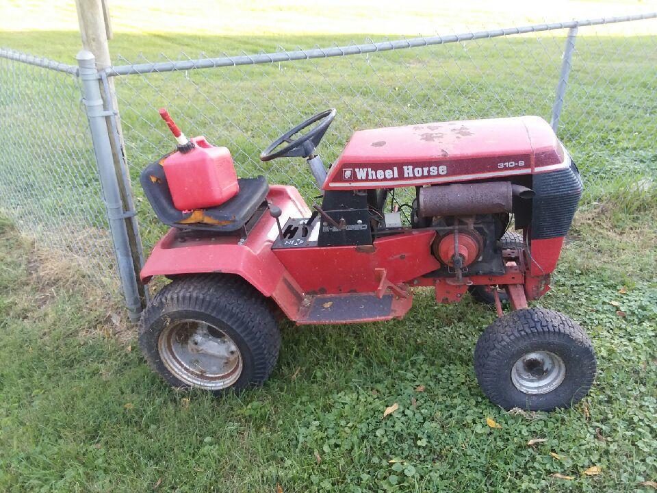

Torrence20 23 #1 Posted September 23, 2018 Just picked up a 2110k804 20652 from a buddy and got it running but the starter makes one hell of a grinding noise. Upon inspection thd first 1/4 of the bendix is ground off. The armature shaft feels too loose, I’m assuming this is a bronze bushing wear issue? Anyone know what size I need to replace it?. I’ve read a bunch on taking the starter out but nothing on fixing my specific problem Share this post Link to post Share on other sites
JAinVA 4,638 #2 Posted September 23, 2018 From this side I can't tell if you have a K series or a Magnum 10.Either way buy a new starter.For the cost of the parts to fix what you have you could get a new one. 1 Share this post Link to post Share on other sites
gwest_ca-(File Mod) 11,978 #3 Posted September 23, 2018 Here is the Kohler parts list for the M10S-461521 if that is what you have. That will give you original part numbers to search for replacement parts. Click on the picture and download from there. There should also be a bushing in the Bendix drive but that requires replacement of the drive. That plus wear in the drive end armature bushing can add up. You can get a aerosol can of graphite with a tube that works well in this application. The solvent evaporates real quick leaving just the graphite so it does not attract dust which is what wears the bushings. Have also sprayed the ring gear on the flywheel. Did not reduce the noise but it has not let me down either. This may be the same parts page but most numbers have been changed so they have to looked up individually https://www.partstree.com/parts/kohler-engines/engines-horizontal/m10-461521-kohler-m10-engine-magnum-wheel-horse-10hp-7-5kw-specs-461500-461541/electric-start-11-10-501-rev-3-15-2006-to-show-group-description/ Here is a unit available in Canada from a Stens dealer. Just more info to help locate what you need https://www.bantasaw.com/catalog/viewproduct.asp?i=&p=5587 This is what I was looking for but not listed for your starter number https://www.bantasaw.com/catalog/viewproduct.asp?i=1475&p=5140 Garry 2 1 Share this post Link to post Share on other sites
Torrence20 23 #4 Posted September 23, 2018 It’s a 10 hp magnum Koehler. I guess I’ll just take it apart and see what I’m working with. I can get some bushings at a local hardware store if I can fine one close I’ll just turn it down to make it fit. Thanks for all the info! Also anyone know where I can find a regular old gas cap for one of theses that does not have the fuel guage crap in/on it? Share this post Link to post Share on other sites

Torrence20 23 #9 Posted September 24, 2018 Sofor what it’s worth it pulled the starter off tonight and sure enuff the bushing on the end was shot. I took some measurements so I can grab a bronze bushing tomorrow at work they are about 2.50$ Its a little larger then 1/2 i.d and a little under 3/4 o.d so it will be easy to find one that will work. While on the lathe turning this bushing to size I was pondering if I should turn a small chamfer on the end of the bendix that’s chewed up to try to save it... anyone have any thoughts on if that would help engage the ring gear? Share this post Link to post Share on other sites

Torrence20 23 #18 Posted September 26, 2018 Well my 2$ bushing worked. turned it down to fit, cleaned up the edge on the bendix cleaned everything up and put it back on and it works flawlessly and no noise at all it engages and disengages very smooth! 2 1 Share this post Link to post Share on other sites
