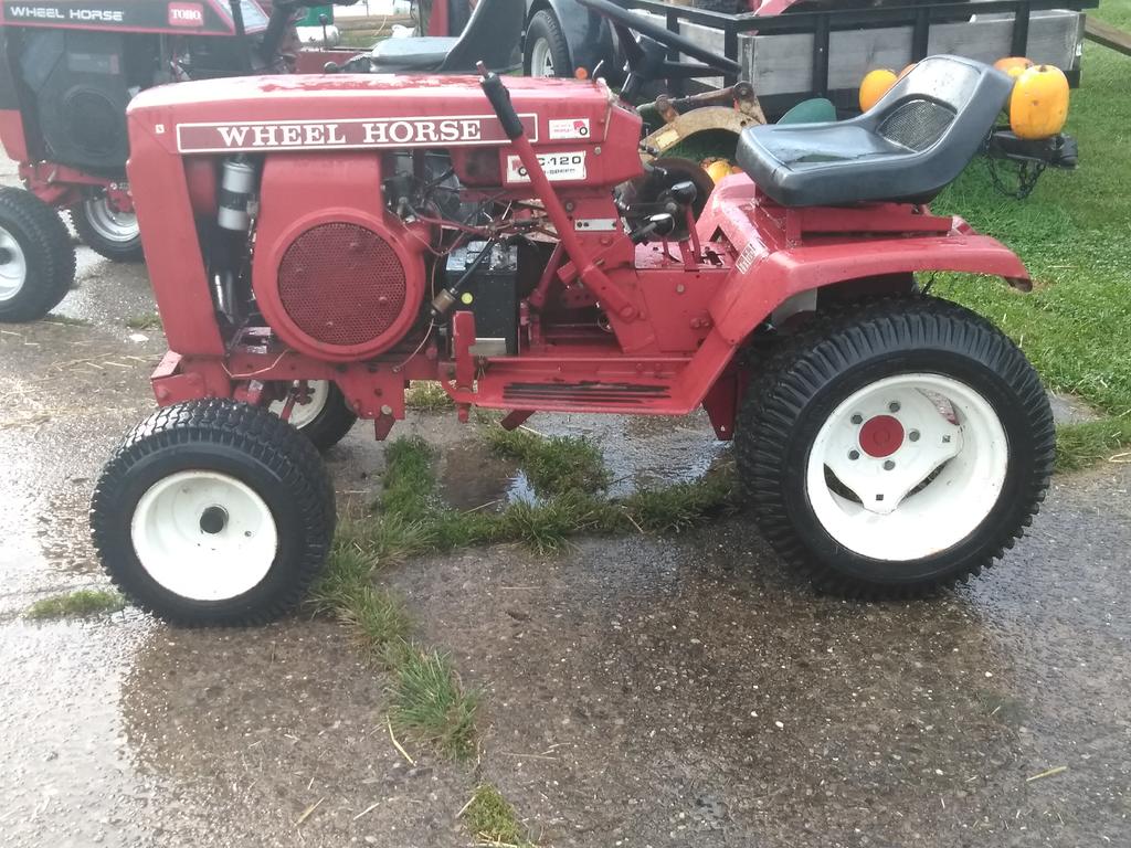

Daron1965 644 #3 Posted September 19, 2018 I'm now considering making a puller out of my C120. Will start out in semi stock class. I have looked online, but cannot find a pulling hitch. Any idea where I can purchase one? Share this post Link to post Share on other sites

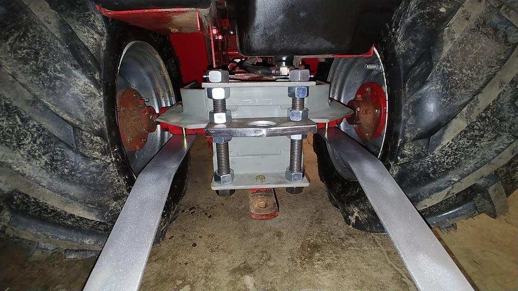

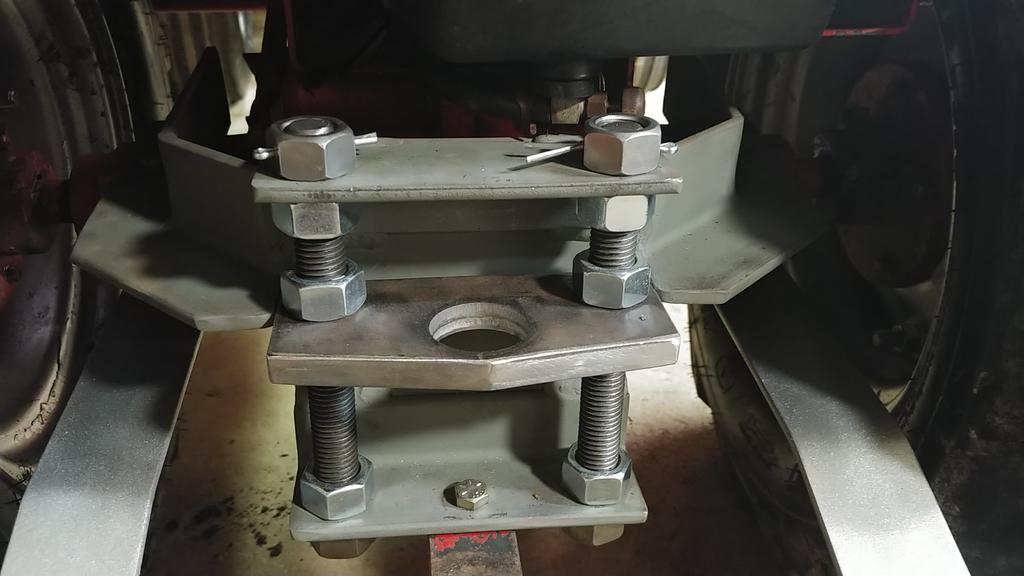

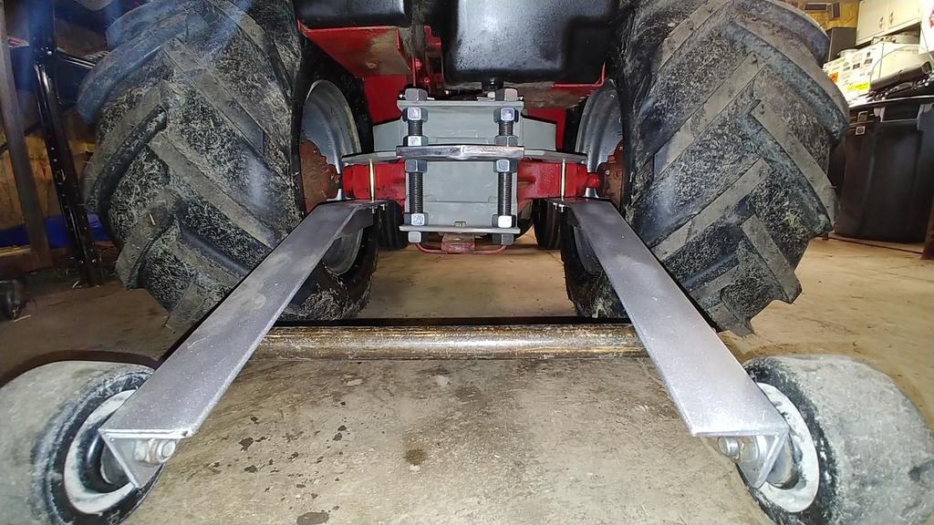

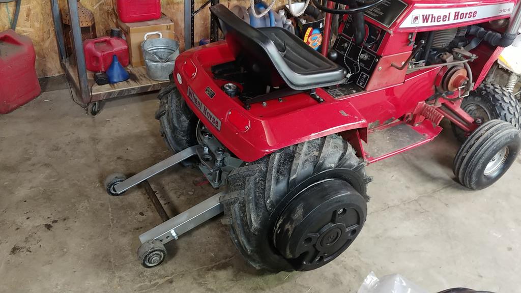

Ralph S 342 #8 Posted March 28, 2019 The hitch is fairly simple to make if you have access to a welder, torch and bandsaw. I threw this together in a couple hours. I used 2 x 2 x 1/4" angle and a piece of flatbar. Share this post Link to post Share on other sites
