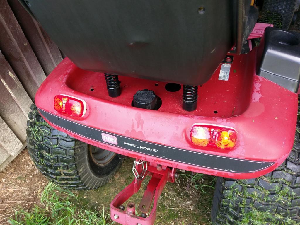

Are you talking about these...

I'm not sure if that would be the correct setup for the 2500.  It may well be though.

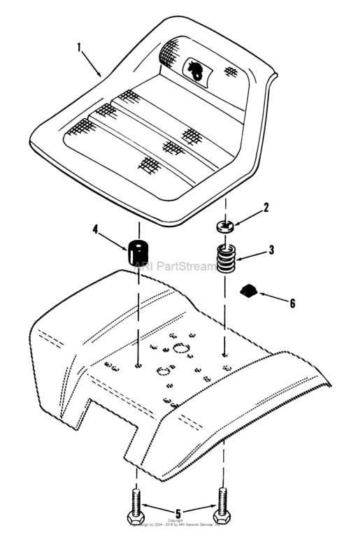

Thanks for responding, here is a pic of what the seat parts diagram shows. I don't know if the springs are as big as picture WVHillbilly shared.
But this diagram only shows 2 bolts when I'm pretty confident there should be 4?
