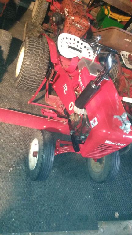

Racinbob 12,765 #2 Posted September 13, 2018 A lot of folks don't support them but I think it's best if you do. I've never been a big fan of stacks but it just seemed right on my Suburban 400. This is a Bud Andrews stack. The design of the 400 had a support built in but I still wondered about it trying to unscrew itself so I added two setscrews in the fittings forward of the support. Do a search here and you'll get lots of ideas. 1 3 Share this post Link to post Share on other sites

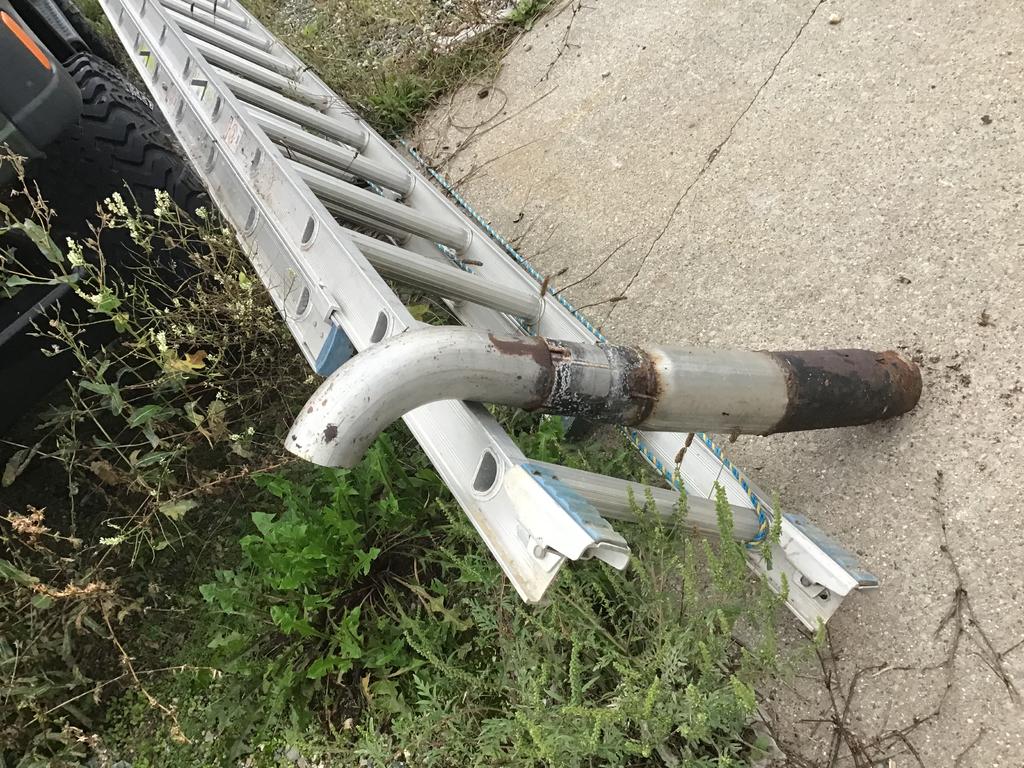

Pullstart 68,880 #5 Posted September 13, 2018 This monstrosity showed up at my shop one day, I think it would be quite appropriate to put it on The Polished Turd, my 656 I’m not sure if it’ll end up as a side pipe, or stack but either option is hideous and wonderful! Share this post Link to post Share on other sites

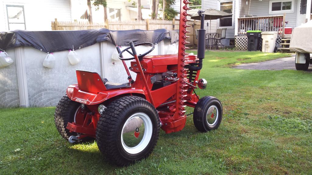

ebinmaine 77,326 #6 Posted September 13, 2018 I'm a huge fan of stacks. Partially because the truck driver in me just likes to see them. But also because I really like having the exhaust so that it blows up out and away from my face. The eight horse does not have a support. That said, the exhaust I used is very very light weight. I'm going to be putting one on the 1267. I should probably try to figure out some kind of a support for that. It really does come down to... Better safe than sorry. Share this post Link to post Share on other sites

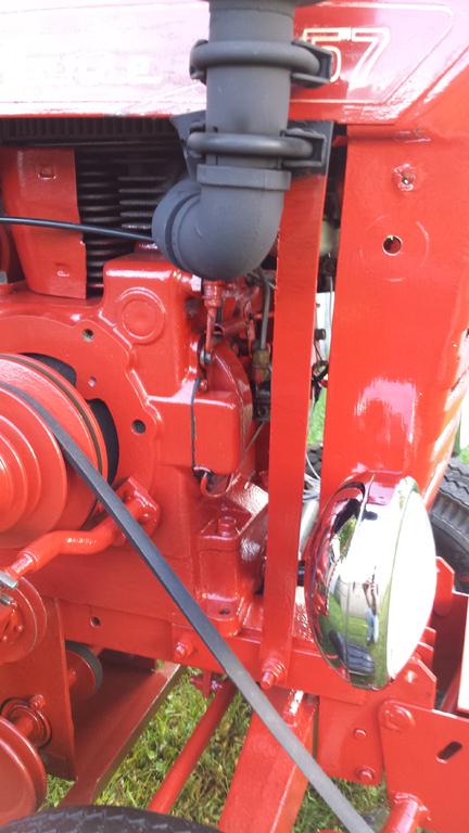

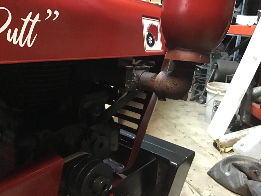

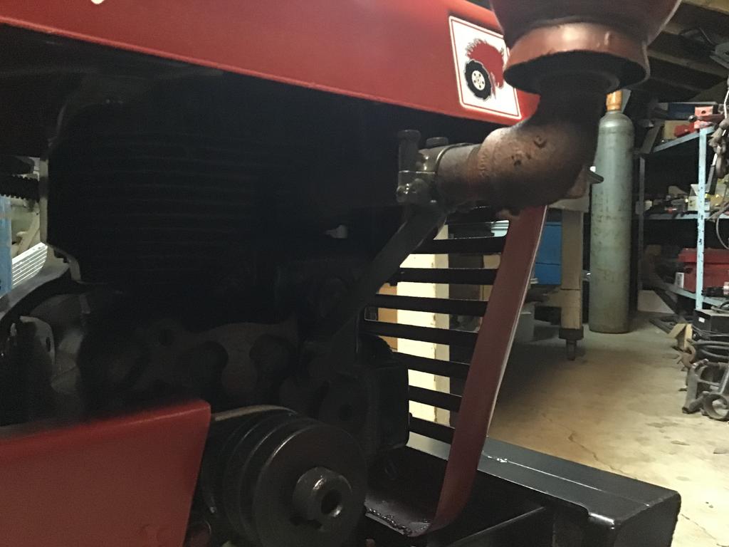

Thegearhead0324 1,361 #9 Posted September 17, 2018 I made a brace for mine that goes right to the frame. 2 1 Share this post Link to post Share on other sites
Daron1965 644 #10 Posted September 17, 2018 That's a great idea. I am going to try that brace. Your tractor looks great. Share this post Link to post Share on other sites
Thegearhead0324 1,361 #11 Posted September 17, 2018 Thank you its a work in progress. Yea I figured bracing it to the motor itself wouldn't be as effective as just a piece of steel going straight down, blend it in with paint and stack ain't going nowhere. 1 Share this post Link to post Share on other sites
ebinmaine 77,326 #12 Posted September 17, 2018 2 hours ago, Thegearhead0324 said: just a piece of steel What shape and size metal? Share this post Link to post Share on other sites
Thegearhead0324 1,361 #13 Posted September 17, 2018 It was originally a 6' x 3" x 3/16" thick piece of steel I measured the distance and cut down about 1" wide all the way down and bent it to fit. Drilled the holes after bending and bolted it to the clamp on top and frame hole on bottom. 1 1 Share this post Link to post Share on other sites

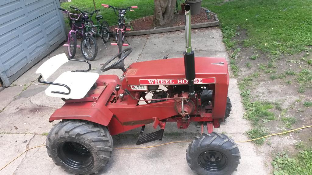

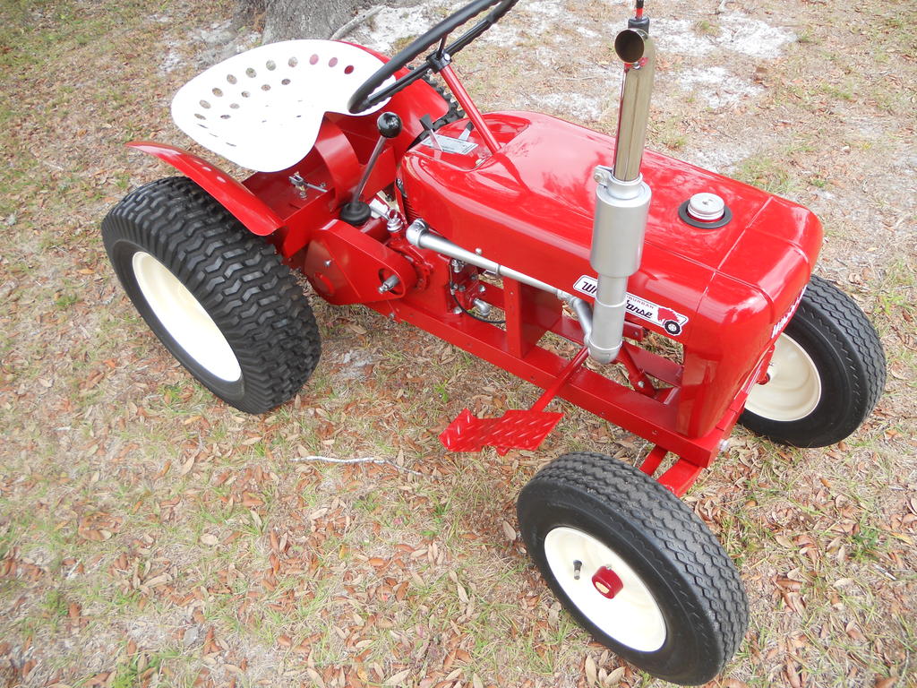

Tankman 3,528 #15 Posted October 2, 2018 Only one short stack. Don't push this Horse much, no add'l support. Grandsons "needed" the stack. Share this post Link to post Share on other sites
